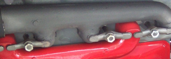

As for the repro high volume, found something similar when installed one of those, had it powder coated red for flash. But found later the aluminum casting is oversize too at the ports, and my issue was seating of the gasket at the upper side, hard to know the intake wasn't seated well.
So after this photo, removed the aluminum high volume, and ground a flat at the top of the upper exterior of the ports, where it was slightly impinging on the repro exhaust manifold and allowed leaks. That fixed it. Don't have photo of the part ground off, but just something else that may have been going on with yours.
