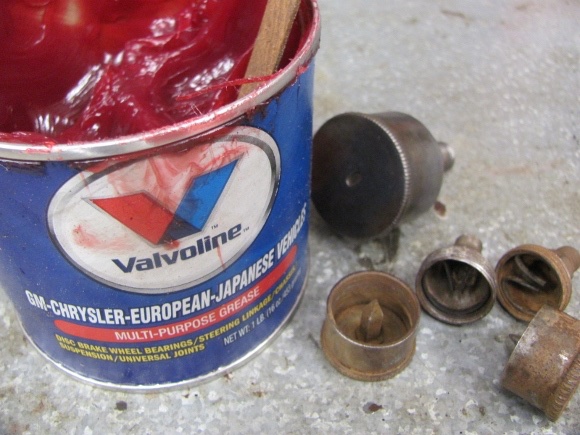

Re: What type of grease do you use in your bearings?
Any quality red grease is fine for my T's.
To me, a good long time mfg. of oils and greases is Valvoline, for 150 years. They mfg. their own products, best IMO to know the mfg.
You can get Valvoline products most anywhere too, and reasonable pricing.
Now the Timken brand red grease may be as good, but more expensive, Timken only got into the grease marketing business in 2004, and according to the MSDS on the grease, it is mfg. by Chemtool.
