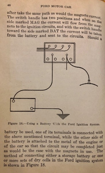

As others mentioned, Ford capitalized on the flywheel magneto, but Henry did put redundant systems on his T, so the coil box mounted switch does have BAT position and a battery terminal for the coil box.
This info is from publication The Ford Motor Car, by Harold P. Manly. 1917
As mentioned in the page, ground the battery to any nearby place, using a bolt or nut on the engine or frame, just be sure it is a bright clean connection.

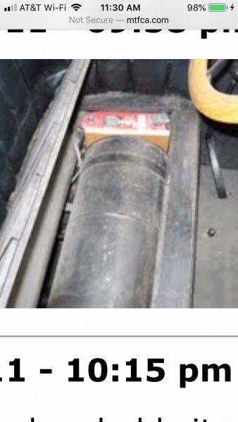

On my 1915 runabout, I have a 12v motorcycle battery tucked under the seat. On my 1911 touring I have small lawn & garden type 12v under the back seat.
On my 1915, generally I can prime the cold engine a couple of times and get a "free start" when I switch on the battery. I thin advance the spark and switch it over to magneto. As Steve mentioned, battery starting is often "easier" than starting on magneto. However, a car with a good carburetor, a good magneto with strong magnets, and properly rebuilt and calibrated coils will start very easily.

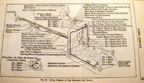

I think this diagram will help in answering the question as to where the battery ground strap was attached for cars with a battery & battery box. There are no other wiring runs to provide better ground connections to other parts of the T. Having said that, everyone has provided excellent advise on how to add a battery, where it can be located and the need to provide good grounding. But it would seem that, back then, if a battery was added one would ground it to the nearest chassis bolt. Since the cars were "new" the chance of a bad ground connection throughout the vehicle were much less than 100 years later.
