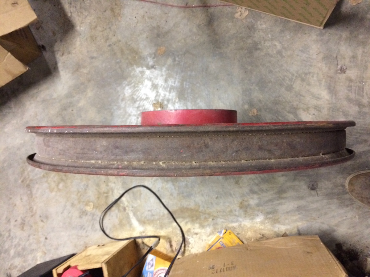

I need one wheel (prefer rear but easily converted) like this picture
- Posts: 4405
Re: Looking for a wheel
So a thirty by three and a half? I know what the records say. But I and a dozen other people have seen many fronts in 30X3 size! Regardless,I do like to see someone putting a set of these onto a car and using them!

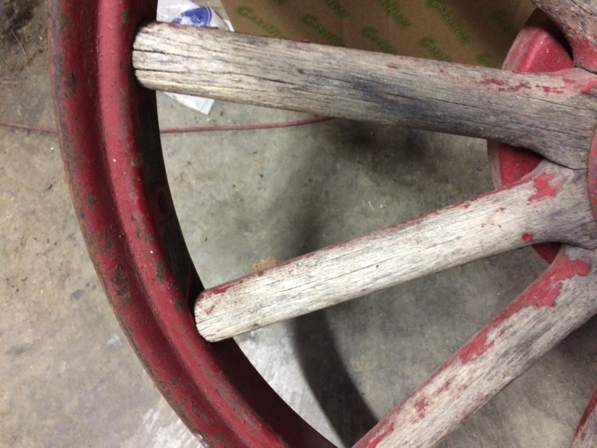

Do you plan on reusing those spokes???

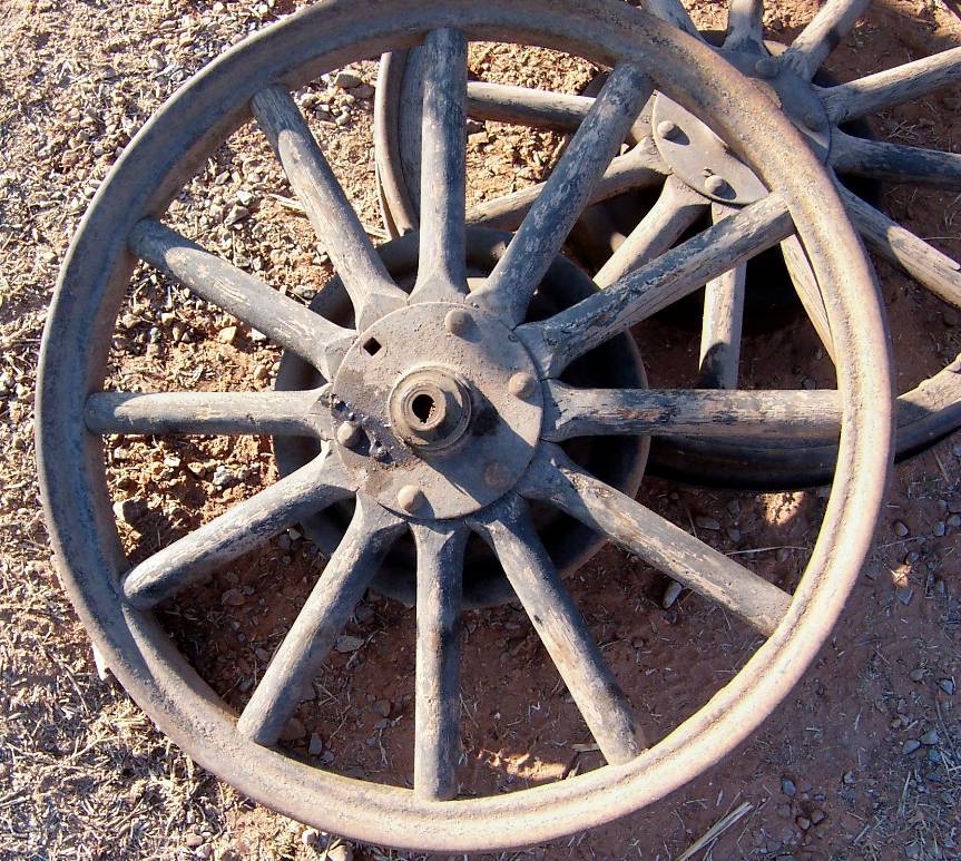

Wayne, I may well be all wet here, but I THINK all of the steel felloe non demountable wheels were 30x3 1/2. I had some years ago that were in great shape. I was going to use the spokes to rebuild some 30x3 1/2 demountables but was told they wouldn't fit. Never did check them out though as I sold them. Dave

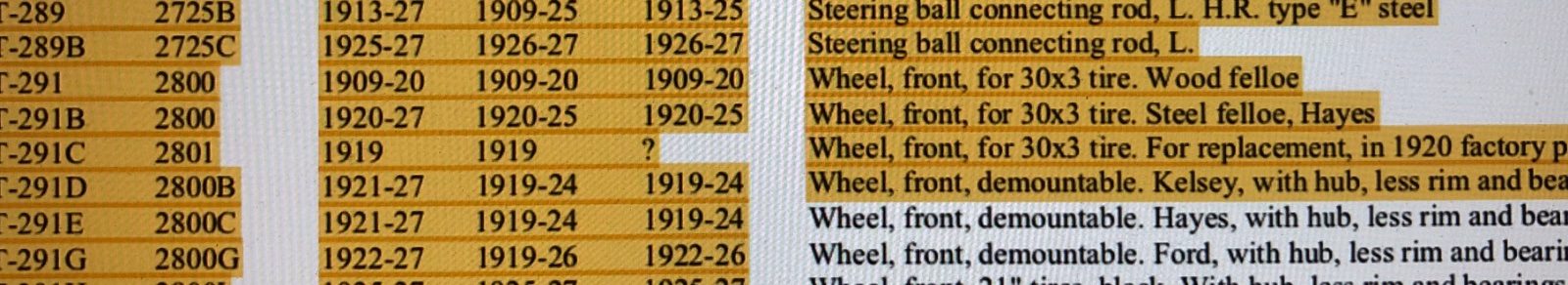

- Posts: 5582
According to the Ford Price List of Parts & The Encyclopedia, there were both 30 x 3 & 30 x 3.5 non-demountable steel felloe wheels - I have several 30 x 3 fronts.

- Posts: 5582
Information available in the Encyclopedia states the wood felloe was replaced with steel in 1920. It also makes reference to 30 x 3 non-demountable wheels used on the fronts.
- Posts: 4082
Donnie
The parts listings from Bruce's C-D confirm what you posted, those steel felloe wheels, made by Hayes, were likely first around 1920, of course Ford used other mfg wheels too, so wood felloe 30 x 3 might have been around then too.
Have seen only a few of these 3" clinchers, most times find 30 x 3 1/2" steel felloe, this one with the 11" brake drum, likely on a Plain Jane '26-27
Les Schubert
Topic author - Posts: 1364
- First Name: Les
- Last Name: Schubert
- Location: Calgary
Very interesting. As a Canadian I “assumed “(dangerously) that they were 30x3-1/2.
I need to do some measurements.
I am thinking about putting them on a speedster built with a 13 engine. The 3 wheels I have are nice and tight.
