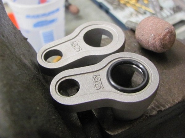

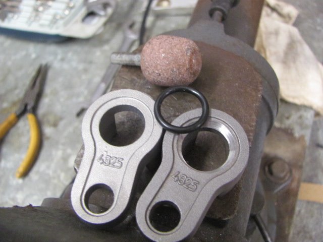

I use a pneumatic die grinder with the fine grit triangular shaped stone. Level the piece in a vise, take your time and test fit often. Not as precise as some machine work I've seen but it gets the job done.
- Posts: 4090
Re: What tool to chamfer transmission cams?
Just a stone will do the job, place in your elec. grinder, or a elec. drill would work, although the drill motor will run at a much slower speed.
A stone will jump around less than a cheap conical large tooth cutter tool, unless you have the right speed and lube.
Takes a few minutes to do it. A 1" ball or 3/4" cone abrasive stone, the groove is just half or bit more of the O-ring thickness.
