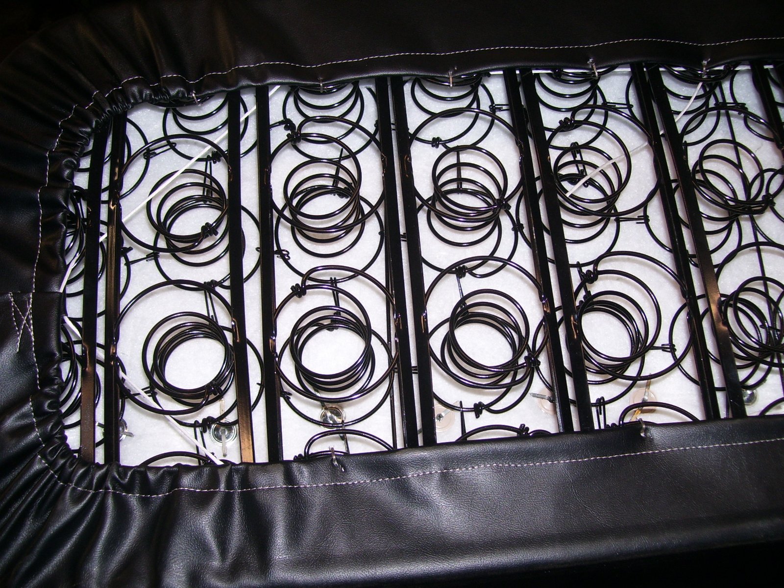

They added an inch or two of foam under my seat as well. You would never know it was there and it does make the seat a bit higher. I do not know if memory foam is the best type. I would suggest calling Classtique or going to a local upholstery shop and ask what they would do. I believe you were going to attach the cover to the seat frame, but if you add extra foam the string method might work better for you.
I am sorry i do no have a picture of attaching the cover to the frame. Both methods should work.
