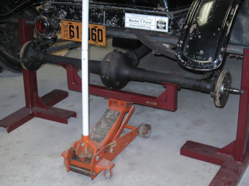

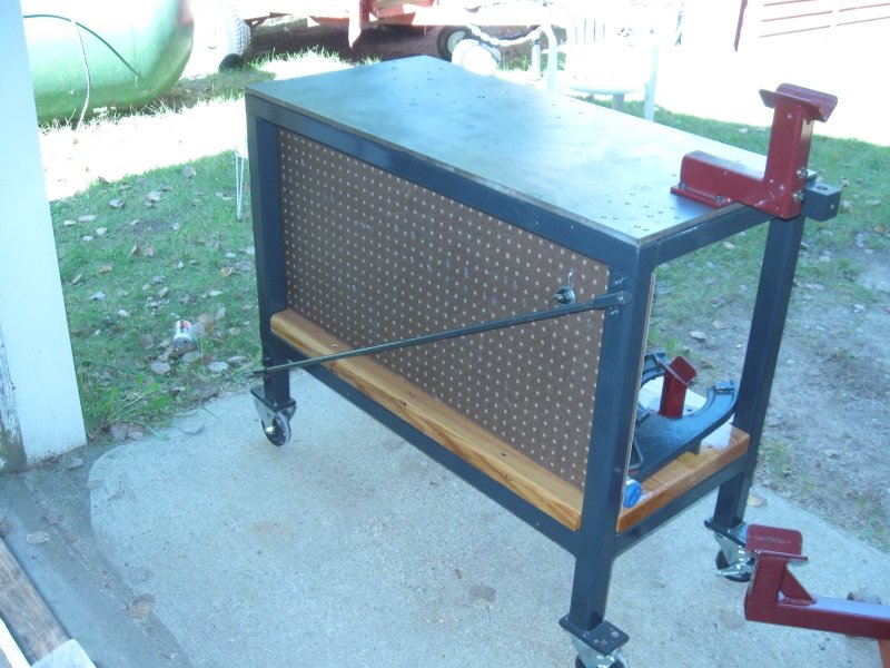

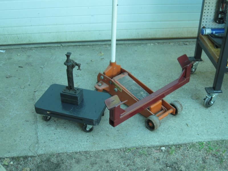

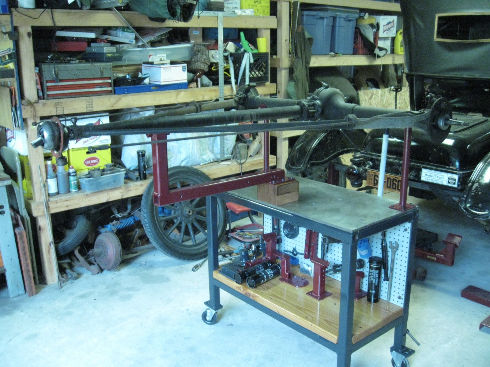

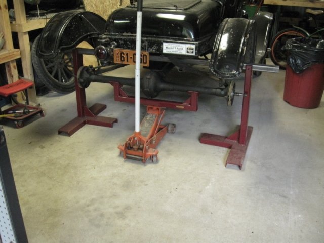

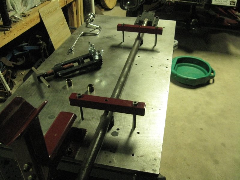

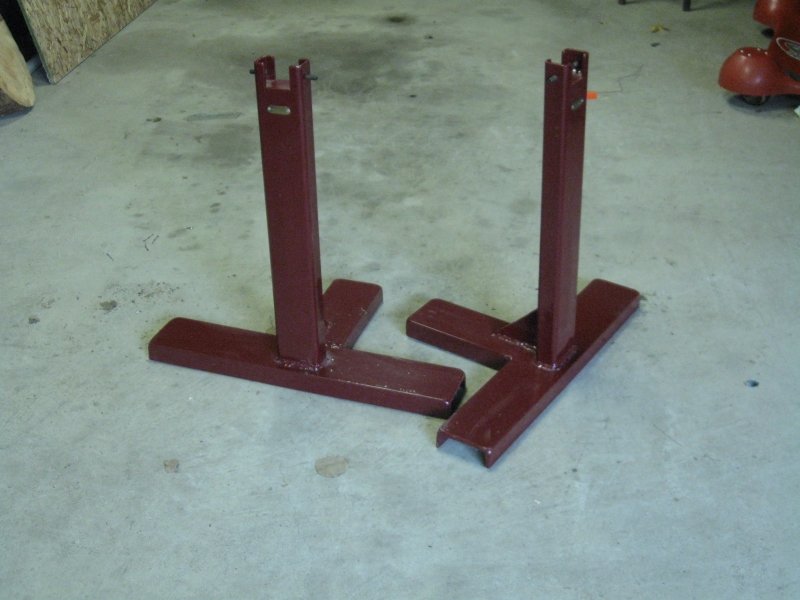

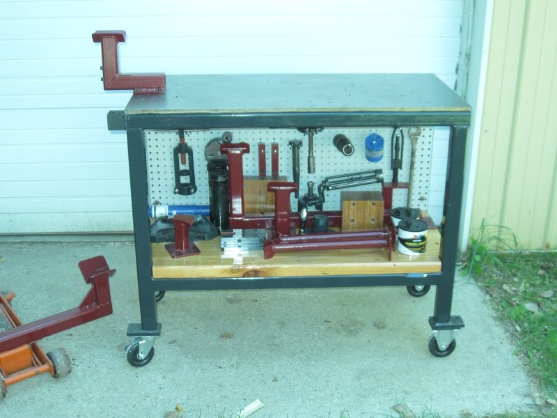

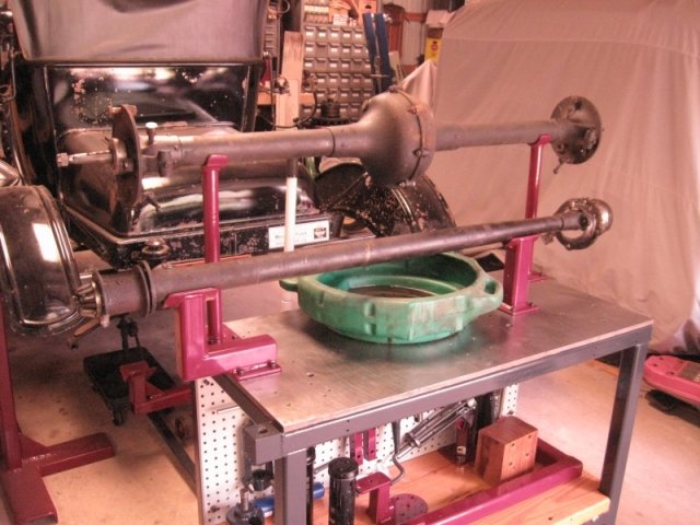

I think that I now have almost everything I need to make overhauling the rear axle a lot easier and less of a physical struggle (87 years old come April) than any other axle that I had done in the past. I always wanted a KRW axle stand and have had more than one opportunity/chance to buy one over the last 50+ years, but space has always been an overriding and determining factor. I have never had, and still don’t have 25 to 30 square feet that I could/can dedicate to a single job specific tool. I will say that this is what I came up with, but for the most part and being honest, it was my son. He took everything that I barked or complained about when doing a rear axle and made and outfit this compact little work table.
The table top measures 42” x 21” and it is a comfortable 40” working height. The top is 5/8” thick and has been Blanchard ground. The frame/legs are all 2” square thick wall steel and it sets atop ball bearing casters. There is a mix of original tooling and modern and a great set of fixtures to hold and manipulate the axle and its component parts for whatever operation needs to be performed.
It also comes with a set of frame stands and a cradle for the hydraulic jack to lift the axle. The jack also has it’s own “extra” support for the front of the torque tube. This would be the only Model T part that was harmed in making what you see (it had 4 holes drilled in the base).
All-in-all, it is a nice compact set-up that is solid and stable, yet easy enough to move around, even with the axle on the table. After you are done using it for rear axle work it can be used as a solid work table or workbench or move out of the way. It does need a small tweak or two, but nothing major. For it's first trial run it worked extremely well and made the job easier than I ever remember. That 3 hour and 28 minute time for an axle overhaul in the Ford Manual may be in reach. I will post some other photos of it in use.

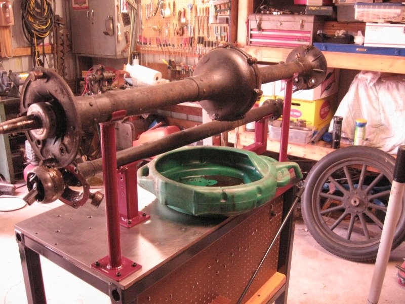

Here are some photos of it in use.

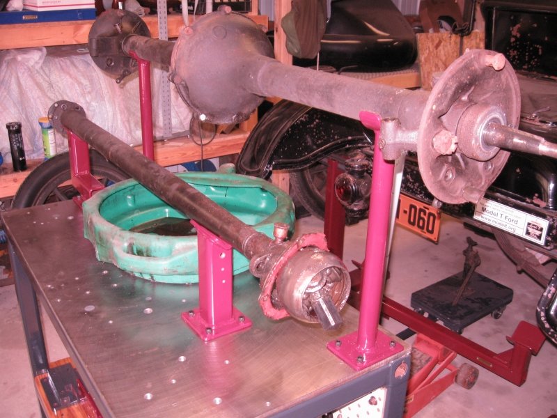

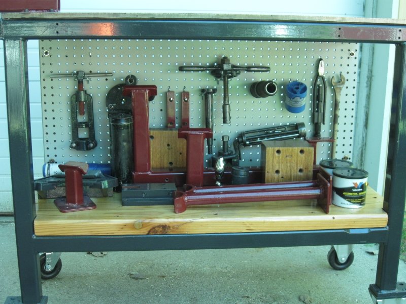

A couple more.
This next one made cleaning and de-greasing the differential and inside the axle housing a lot easier and cleaner than anything that I had done before. An old, "worn-out" hub with a crank handle add to it and then just fill the differential with your solvent of choice. I used the carburetor cleaner in the 1 gallon can and it cleaned out pretty well. All you have to do is have the catch pan underneath the axle and then turn it over and pour out right where you want it.

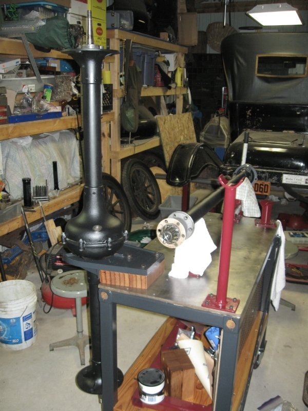

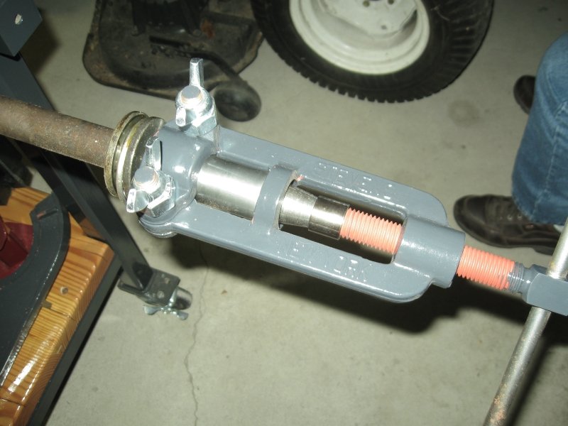

And a couple more.

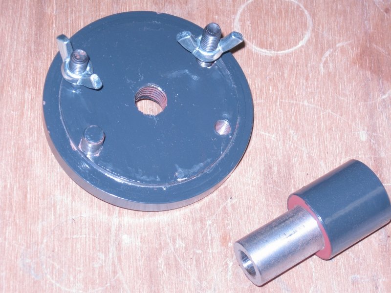

Please forgive the "modern" wing nuts and spacers on the Stevens tool, the originals have not come back from the plater yet. The spacer that fits over the end of the drive shaft and the tool I had made, and they were copied from originals. While they do "work", they do not work well; no fault of the machine work, they are just too short and should be designed a bit differently. I am going to have some different ones made that are longer and a bit different (more solid). The only problem with this tool is that it wants to spin on the drive shaft as you tighten it up. Also, you need to remove the handle and use a wrench on the end, that 5/16" straight rod handle won't cut it.

Post by Pep C Strebeck » Wed Oct 16, 2019 10:08 am
Steve Jelf wrote:
Wed Oct 16, 2019 9:15 am
I love the little trailer to carry the torque tube. Great idea.
Thank you. That is something that got "modified" before the axle was put back in, it just needed a bit more height/reach. It is a nice solid connection to the jack and does not wander around when you go to pull it out or move the axle assembly around in general. It made putting the axle back in and lining up the u-joint an easy job.

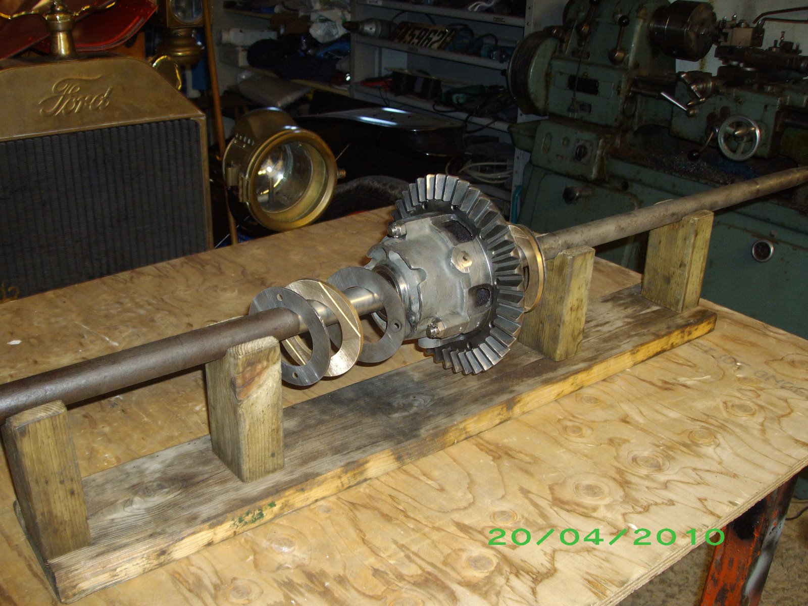

Post by ABoer » Wed Oct 16, 2019 12:33 pm

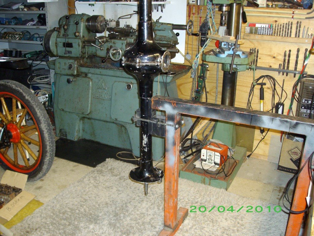

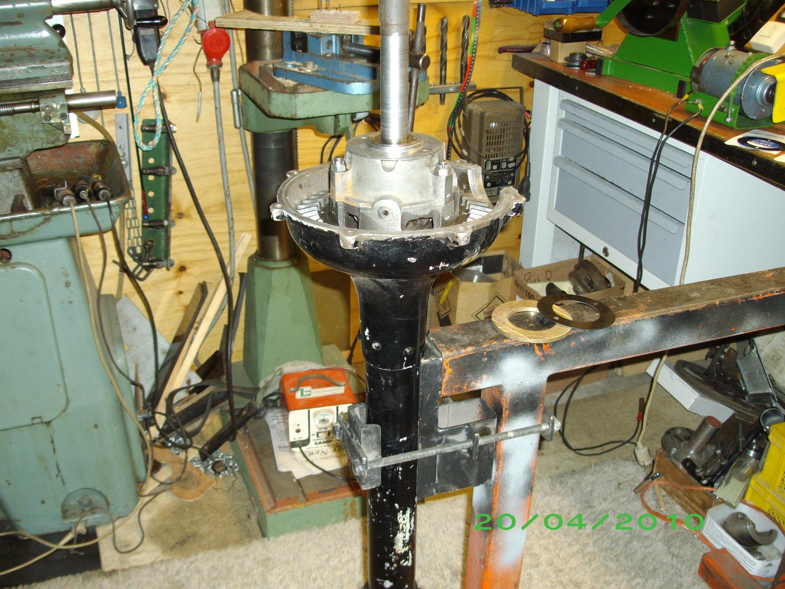

Here some pictures of how I do it .

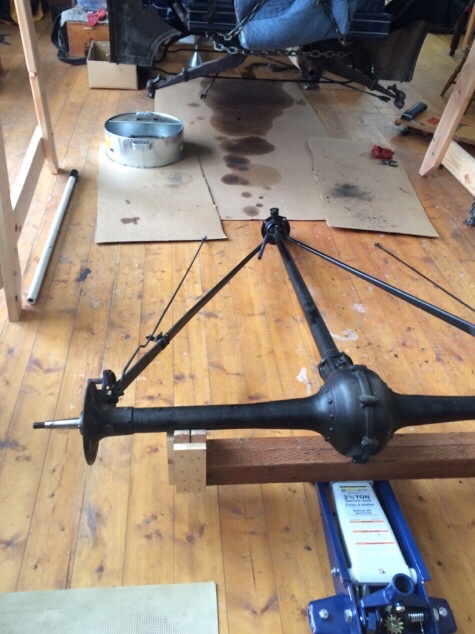

Post by Steve Jelf » Wed Oct 16, 2019 2:10 pm

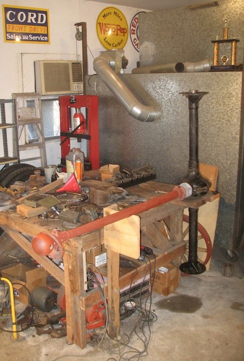

And then there's the cheapskate method:

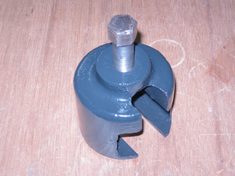

Post by Pep C Strebeck » Thu Oct 17, 2019 1:53 pm

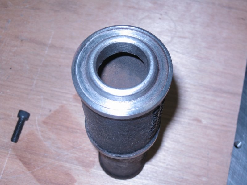

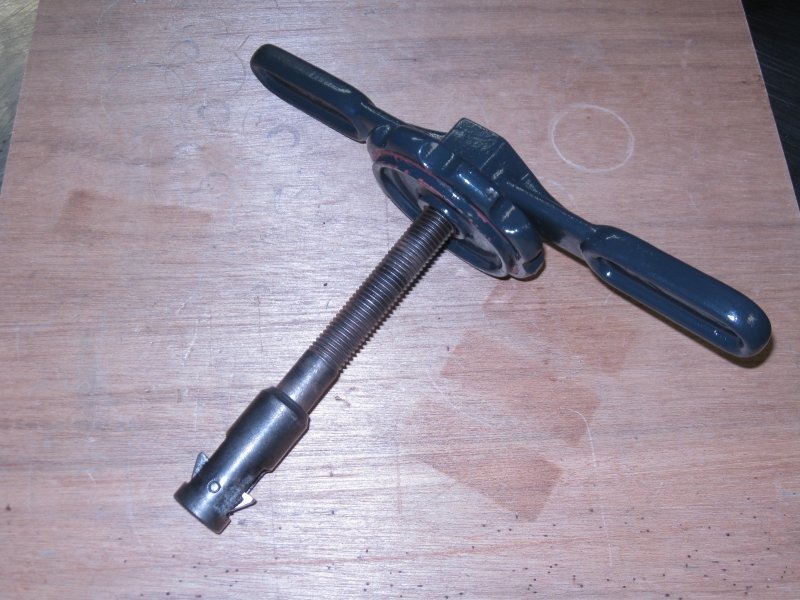

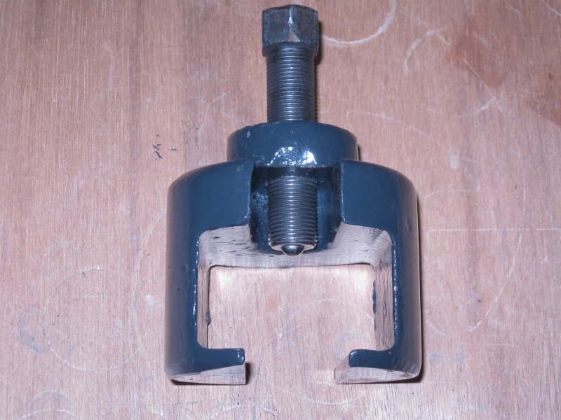

Just some close-up photos of some of the tools.
The Stevens drive shaft bushing puller works well, you just need to make sure that the back side of the bushing is "clean" and free of grease. If there is any grease, the pawls that actually grab onto the bushing to pull it out just kind of spin and slide. The link below is where I had to make a new spring for the pawls on the puller.
https://mtfca.com/phpBB3/viewtopic.php? ... 7469#p7469
The Cantrell-Miller rear axle bearing sleeve puller works well, but if you do not have the dummy axle you will not be able to pull out the inner bearing sleeves. Scott Conger had made some excellent looking reproductions of this puller not to long ago and he also made the dummy axle to go with them. He was right in dropping the crank style handle and making his with a hex head for a wrench/socket, that will work much better with a stubborn sleeve. The link below is where I was looking for dimensions for one of the pieces for the puller. I ended up having to make a new rod/cam and pin (that actually pulls out the sleeve) for mine and they both worked well, one REALLY stubborn sleeve. For my dummy axle I used an old Model T axle with 2 grade-8 flat washers welded together and then to the bottom (2" diameter washers).
https://mtfca.com/phpBB3/viewtopic.php? ... 287#p11287

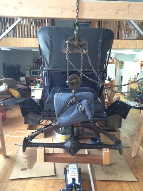

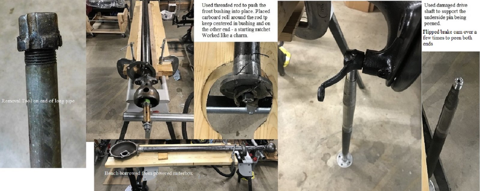

Poor man's rear axle work table and tools. Just doing one axle. Flipped the old bushing over to push the new one in - used a roll of cardboard between the threaded rod an new bushing to keep it somewhat center and protect the surface of the new busing. Removal tool is as described in the Ford Fix.

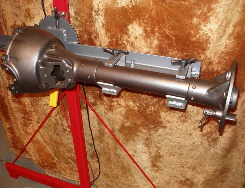

StanHowe
Posts: 979
First Name: Stan
Last Name: Howe
Location: Helena, MT
Re: Rear axle work table, fixtures and tooling.
Post by StanHowe » Fri Oct 18, 2019 12:36 am
Some great ideas there.
Here is one I build years ago when I was rebuilding Ruckstells. It rotates in the middle, holds the left side housing in clamps so the right side is free to install and remove the housing, etc.
Notice the winch, there was a cord to a battery mounted on the bottom rail. It also had wheels to roll it around the shop and short legs to set it down on the floor to make it more solid. Just let the air out of the tires to lower it and blow them back up to move it.

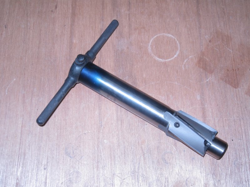

The puller for the pinion gear is an old Kent-Moore ball joint puller for late 1950's Cadillacs. Not an original service tool I know, but it did work very well.
The spot-facer/counterbore used to face off the drive shaft front bushing I was able to buy as surplus and I ended up paying more for the pilot than I did for the 1-9/16" counterbore, $4.50.

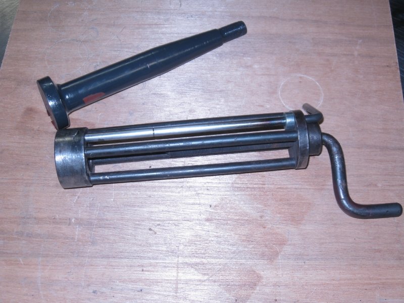

Did they ever have a tool to remove the outer axle housing cap?
Yes they did. It is shown in the photo below, the upper left item. If anyone has on I would definitely like to see some pictures of it.
