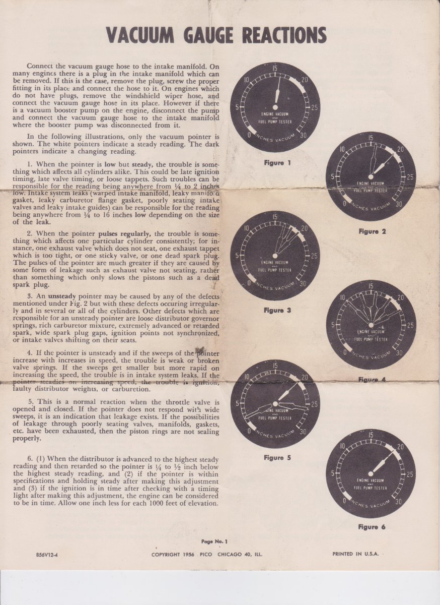

found these instructions in my 50 year old tester[image][/image]
