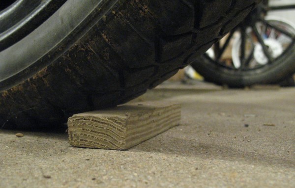

I put a short piece of 1 x 2 wood in front of each wheel. That keeps the car from creeping when it starts, and I can just drive over them when I leave.
