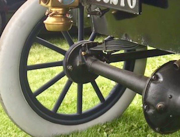

Your fixes may be best, Would first double check all the parts are fitting correctly. Sometimes the grease retainer cup on the axle housing isn't seated all the way, that could let the hub stand proud of the backing plate. Could check again and fit the rear wheel without the brake shoes on, to be sure the drum and hub are all the way on the axle, and fit as they should.
Early axle with normal like gap.
Much like my example, this early 09 rear end has similar random drum gap showing on both sides. This known car has the original style straight axles, where adjusting the gaps would be similarly complicated. I have to question whether these gaps would have been more problematic back in the day when this was an original driver, as the result of mud and debris accumulating inside the drum. I have retrofitted lined shoes with my drums, for improved E-Brake effectiveness, so cannot have the potential of some obstruction getting in there, that limits or prevents this performance.

Post by Scott_Conger » Sun Jan 05, 2020 3:44 pm
That '09 looks perfect to me

Regards,
Scott
Posts: 6708
Re: shorten real axle shaft
Post by Scott_Conger » Tue Jan 14, 2020 1:57 pm
Scott
I think that was an excellent route to take for aesthetics, safety, and (relative) ease of implementation's sake.
Thanks for sharing the results
Joe Bell
Posts: 1198
First Name: Joe
Last Name: Bell
Location: Tiffin Ohio
Post by Joe Bell » Tue Jan 14, 2020 2:52 pm
I have not been following this post, my first look at it, I picked up some NOS Ford axles recently, they have a fine surface rust from lying around for years some where in a warehouse if of interest I would trade you. Just trying to help out on these projects. Joe
Piewagon
Posts: 106
Joined: Thu Jan 10, 2019 8:38 pm
Last Name: Regan
* REQUIRED* Type and Year of Model Ts owned: 1911 Open Runabout, 1911 Touring, 1912 Delivery Cars (2), 1915 Roadster, 1916 Roadster, 1923 Touring Car
Location: St. Charles, IL
Post by Piewagon » Tue Jan 14, 2020 5:17 pm
I personally hate it when a vendor tries to compensate ahead of time for worn out parts which I guess are all supposed to be worn out some magic amount. Shims are available for worn hubs if you can't find good ones but there is no "negative shim" that comes in a length of -1/16 so that you can put a good hub on this incorrect length axle shaft. I have always made parts EXACTLY per the ford drawings when they are available and let the end user decide how to shim it or compensate for any wear in the parts he has.
Scott Rosenthal
Posts: 397
Joined: Sun Jan 13, 2019 11:29 am
Last Name: Rosenthal
* REQUIRED* Type and Year of Model Ts owned: 12 Towncar, 12 Touring, 09 Touring
Location: Cincinnati OH
Post by Scott Rosenthal » Tue Jan 14, 2020 5:57 pm
Hello Joe: Many thanks, but I believe I have arrived at the happy place. The axles are new, and they are the ones that are 1/16" over-length. At the time when I bought them, I was led to understand they were the best of the repos available, where I knew these parts had this specific potential, so it was me who created this challenge for me.
Hello John:
As per earlier in this post....looks like length is just one of multiple liberties that have been taken with these repro axles over the years. Some might call this a "fixing things that aren't broke" example.
Fun Projects parts are of unparalleled quality thanks to your commitment to accuracy....many thanks for these superb products.
Regards,
Scott
