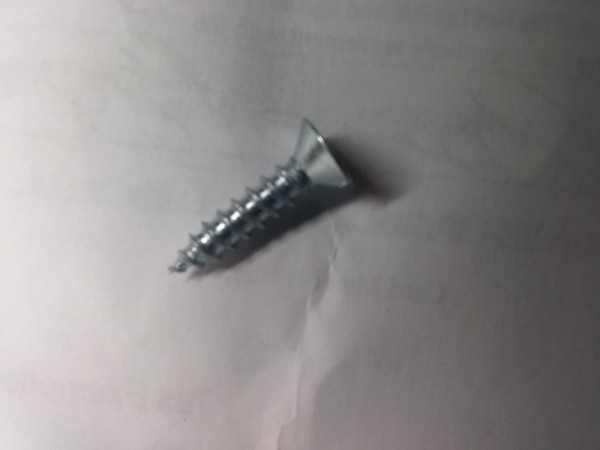

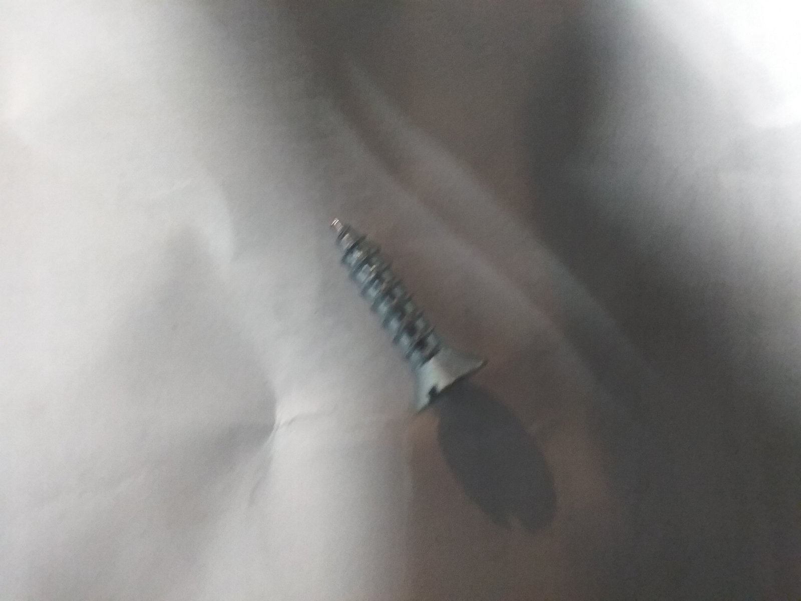

When John first posted this it reminded me that I needed some straight slot screws, so I ordered a bag of 100. I think the quality looks good but I don't know how the threads are made. They look like they are cut to me, tried to get a picture maybe you can tell from the picture. George

George, what you show is a self tapping screw used in metalwork. Wood screws will have a tapered thread for its length and there will be some plain shank. Once installed, the appearance will be the same.

I started out to disagree with you, but conclude that you are correct. In George's defense, though, the screw he posted is very commonly sold as a wood screw in the US.

Scott, in the interests of accuracy, I found a box of such screws in the stuff I just loaded for the Bendigo swap meet. They are labeled as chipboard screws!
My theory is that tapered wood screws would tend to work out of chipboard, but parallel threaded screwd would maintain their hold.
While chipboard is made of wood derivatives, the screws are still self tapping.
