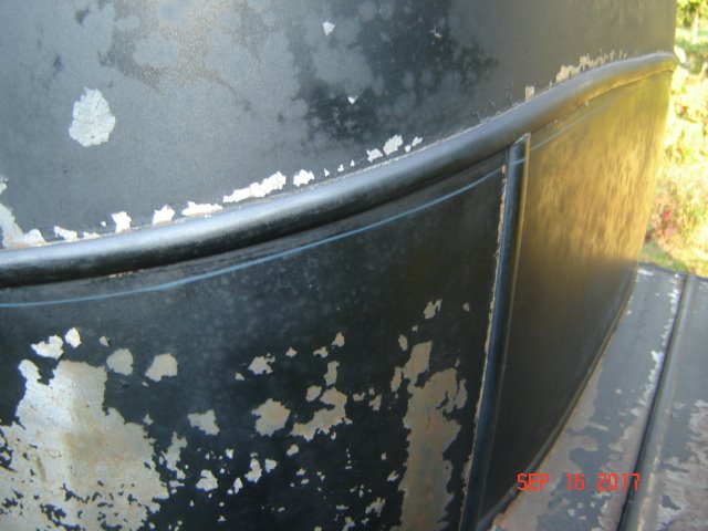

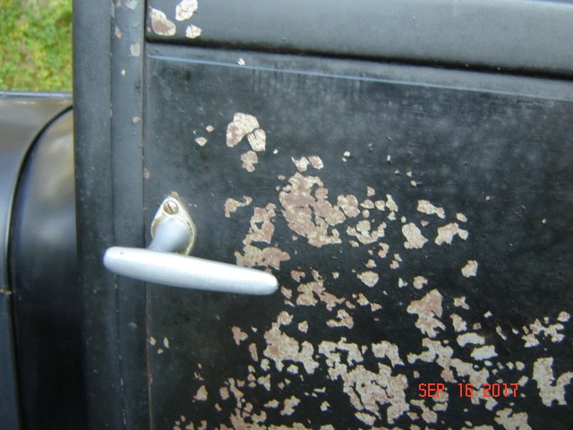

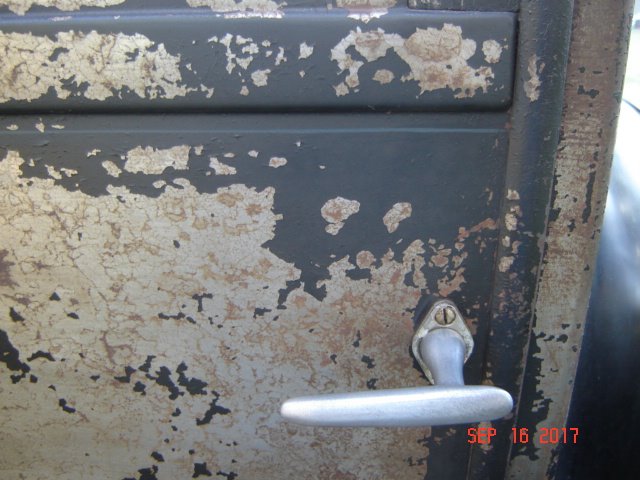

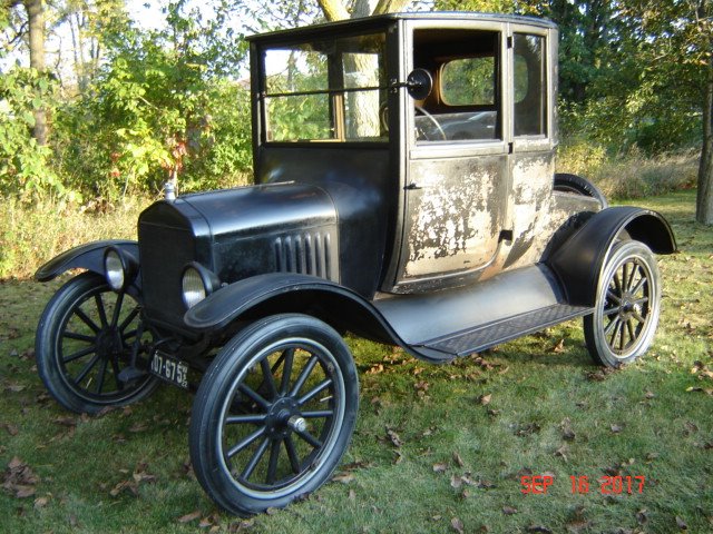

Post by Jim, Sr. » Fri Nov 15, 2019 11:59 pm
Adam is right about paint sometimes coming off in chunks, leaving clean, bare steel. This example is an original well preserved 1922 coupe that reportedly had nice original paint until it got stored in a cold damp steel pole barn in Wisconsin. There is no sign of any primer under the black paint on the body. These coupe bodies were supplied by Briggs, and most likely came to Ford all painted and trimmed out, ready to drop onto a chassis. The fenders, hood, running boards, splash aprons and such were made by Ford and had their factory paint on those parts.

Post by RustyFords » Sat Nov 16, 2019 8:26 am
That is a compelling case. I’d love to spend about an hour looking at it and the paint chunks that fell off, very closely.
I’ve heard of much later model cars shedding chunks of paint when they were suddenly moved to a very cold climate after spending their whole lives in a very warm one. Somewhere in my photo stash, I have some photos of a late 60’s Ford van that did this after spending its whole life in NM then being moved to ND, but this was an extraordinary case.
The coupe certainly fits those circumstances however. It is possible that it was resprayed very early in its life but it seems unlikely based on the photos.
There’s also a YouTube video (I’ll find a link to it and post it) of another van (oddly enough) doing this when it was moved to Canada after spending its whole life in Texas.
The T about which this thread was started had Texas tags on it and I think now lives in Connecticut. Hmmm

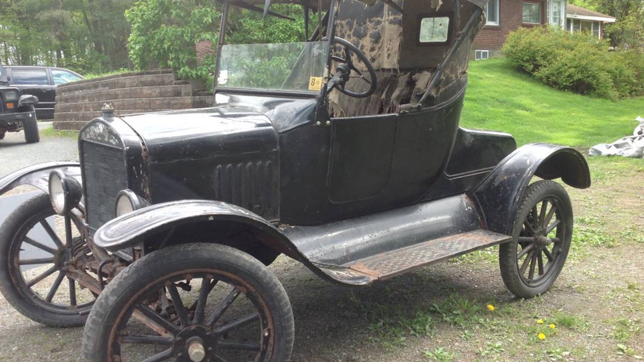

Post by Drkbp » Sat Nov 16, 2019 10:15 am
Looks like a nice runabout and I would love to have it. :)
It does appear to have a very faded 1980 Texas Vehicle Inspection sticker that would expire in August of 1981.
With that plate, seems to indicate the car was street legal in Texas in 1980-81.
Looks like a "runner"! Just needs a top and a quilt over the seat.... 8-)
1980 TEXAS VEHICLE INSPECTION STICKER
