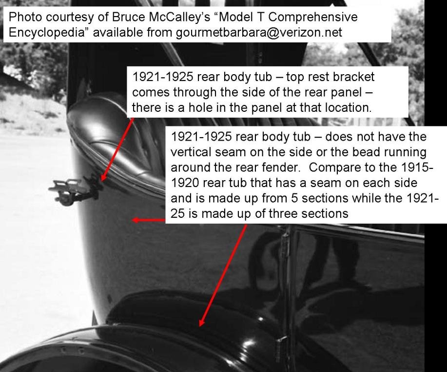

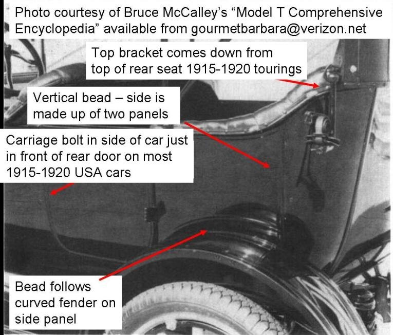

Tom,
Thank you so much for helping your friend with his T. With over 15,000,000 made and many of them modified to keep them in service over the years we all have questions about some part etc.
Photos below should help you see what folks above have been talking about with the earlier style verses later style touring bodies and how the top rest was changed from the old style to the new style. From the factory, both styles were offered with a lot of overlap. And depending on the source you will see the year listed a little differently for when the change occurred. But which ever style body your friend has, that is the style top rest that would have come with that body.
Caution -- if the body was rebuilt, you can mix and match different parts from an earlier body and a later body and come up with one that Ford never originally supplied, but that still functions "OK."
And of course are you sure it is a 1923 T? Engines, bodies, etc.may have been swapped out over the years.
I hope the illustrations below are of some help to you.
Good luck and again thank you for helping a friend with his T.
