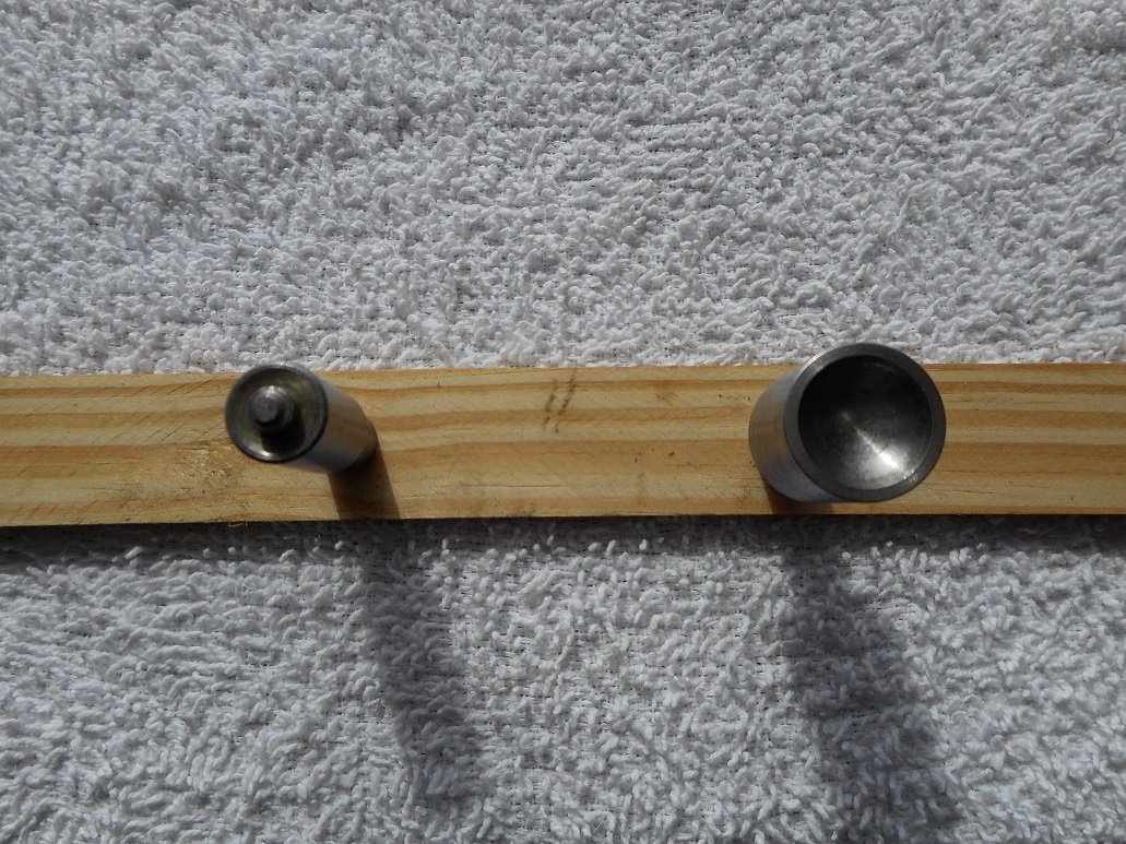

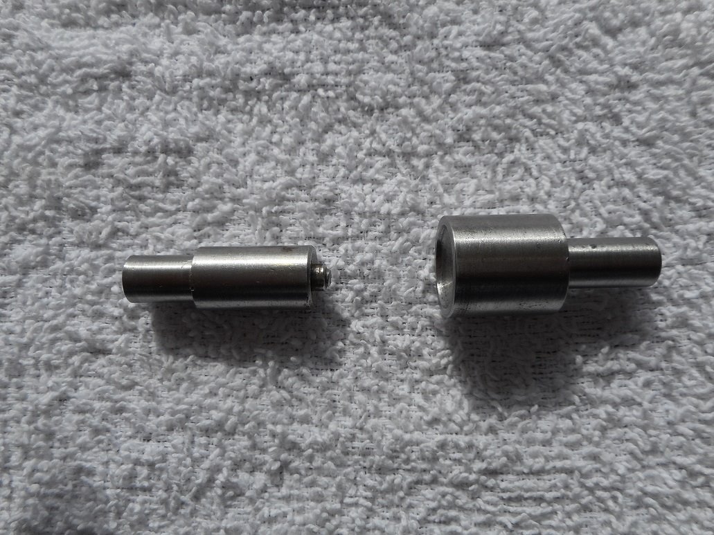

Those of you who know Model T's well also know that Ford used Anzo Fasteners throughout Model T production. The problem today is apparently Anzo is no longer in business. I pick up those fasteners whenever I can, and have enough for my use. When I restored my '25 pickup a few years ago, I was determined to use Anzo fasteners. I found a guy who had the original crimping tools, and he loaned me the tools to copy. Today I was able to use those tools to reconfigure the used fasteners from an original top. I've been having problems with the female fasteners coming loose on the sides of the rear top sockets. I determined those fasteners were slightly sprung, and was able to bring them back in shape with the tools I had made. I'd like to thank Don Skille for making the tools for me, and today was able to use it for the first time. Love those original parts!

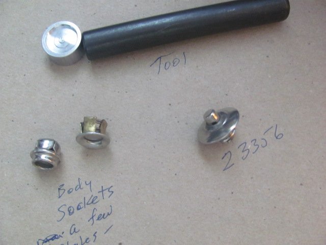

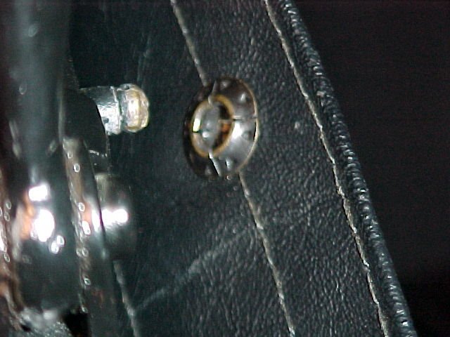

Thanks, Dan! I also did some searching on previous year forum threads and came up with these pictures:

Post by Original Smith » Tue Nov 19, 2019 11:27 am
Referring to the photos above, the only photo I recognize is the middle one. Who knows, that picture may even be my car! The female fastener in that photo is exactly the one I had to resize to work. I'll do my best to get some pictures for everyone before I put everything away today.

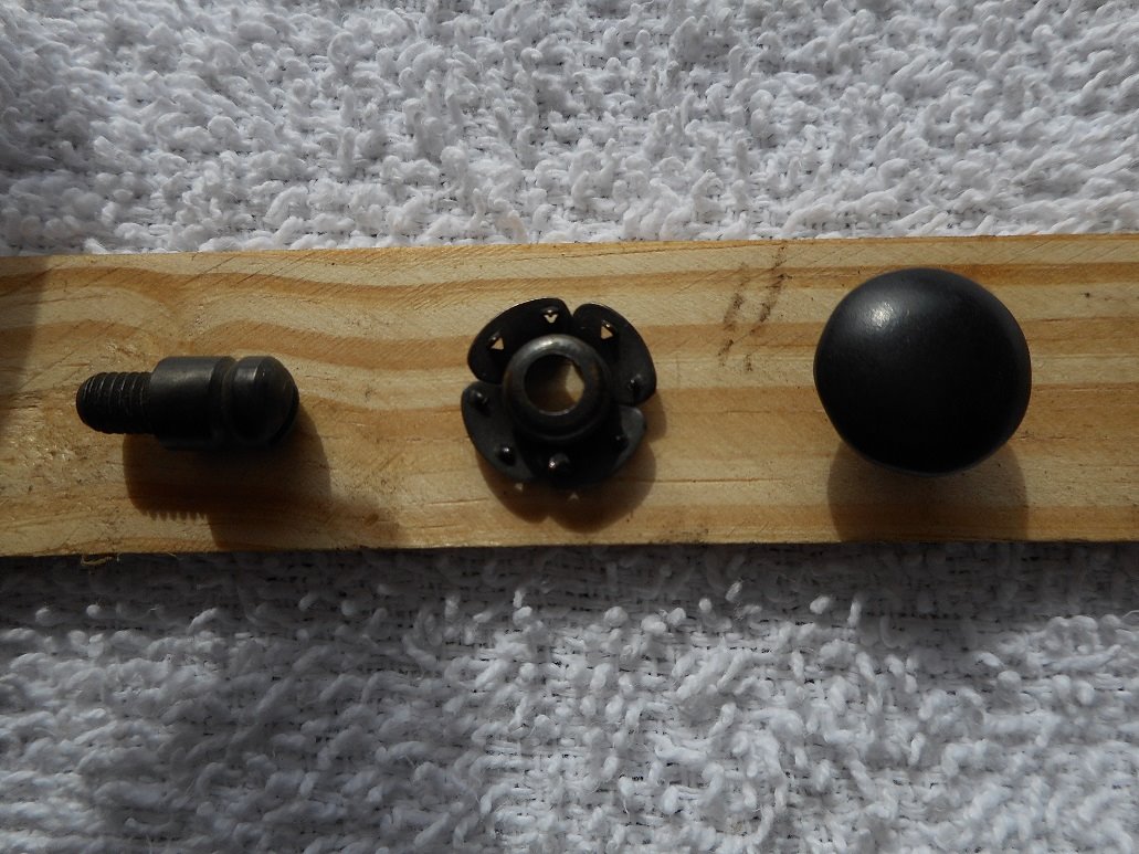

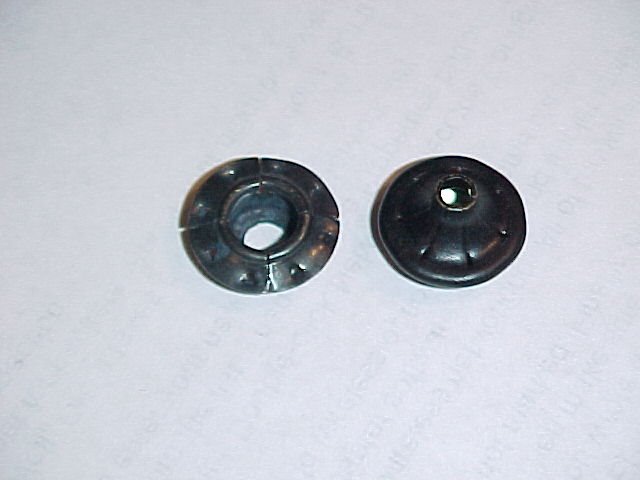

Post by Original Smith » Tue Nov 19, 2019 2:26 pm
Here are the most common Anzo's used from late 1922-1925. I don't know about any other year, but do know they were used throughout Model T production. The parts that I have are all NOS, and are made of brass, raven finished. I hope these photos will do for now. I'm not very good at taking pictures.
