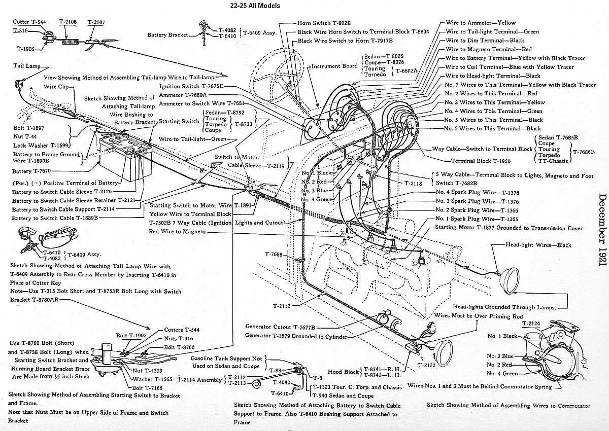

Re: Starter Wire Too Long
Here's a wire routing diagram I found elsewhere on the forum.
Thanks Mark. Going to work on tomorrow. Will fiddle around with it and take a photo. I hate the thought of putting a zip tie to hold it astride the rails.

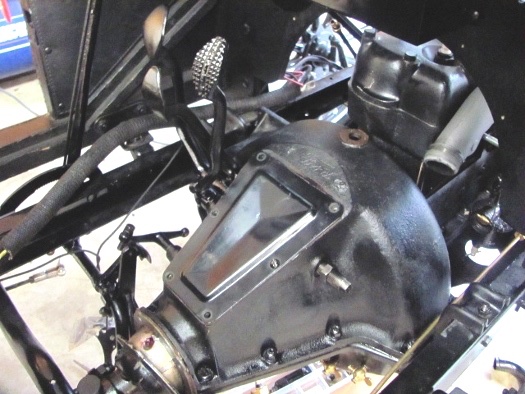

That p/# 5051, Switch to Starter Motor cable should be 28" length. Of course it's run thru the 5051B loom, so you need the length to be able to lay the loom with the starter cable, yellow battery wire and tail light wire inside that loom inside the frame rail to stay clear of the handbrake lever quadrant. Then loop the loom over the crankcase arm to have the cable go to the starter. Haven't had any problems with vendor wires.
Note: In this photo, the loom is moved up, to allow hand room for some final assembly of the motor and pieces, normally the loom rides most of the way inside the frame rail, then bent up some at the crankcase arm and angled as needed to clear pedals and quadrant. That nice thick, tar stiff fabric loom is useful here to keep the starter cable where you want it, and protect it from rubbing on pedals, floorboard, or frame as your T shakes it's way down the road
lmitch
Topic author - Posts: 53
- Joined: Sun Jan 06, 2019 4:11 pm
- First Name: Lee
- Last Name: Mitchell
- Location: Atlanta
Perfect Dan. Exactly what I needed. Thanks for your reply.
