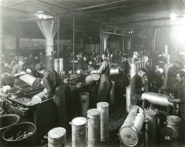

Factory photos good ref. Early sediment bulbs cast bronze, by 1916 cast iron, no finish on them. Just naked

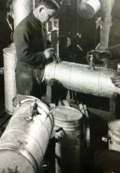

How do you know the ones in the picture are steel and not bronze? Appearance of both oval and round tanks? It doesn’t make sense that round and oval tanks would be in the same photo. The change-over was in ‘20. Is it possible that the photo is much earlier, maybe around ‘14, and the tanks that appear to be oval are in fact round tanks moving by on a conveyor?
- Posts: 4112
Re: Gas tank sediment bowl
Adam
Those are all round tanks, early photo, posted a cropped version, and camera angle made the upright tanks seem oval
