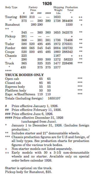

Stock, with generator coils and starter. Would also be handy to know the weight of a rolling chassis without bodywork. trying to assess the weight of a minimally bodied speedster compared to a stock roadsterSteve Jelf wrote: ↑Tue Nov 19, 2019 12:26 pmWith or without coils, generator, and starter would make a difference.

- Posts: 7359
Re: What does a stock 26 T engine and transmission weigh?
