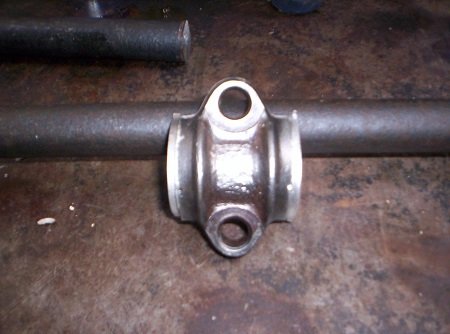

Does anyone have the factory specs for the main bearings?

What I want to know is how thick they are where the bolt goes through.
Are they filed too much?

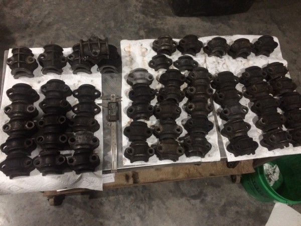

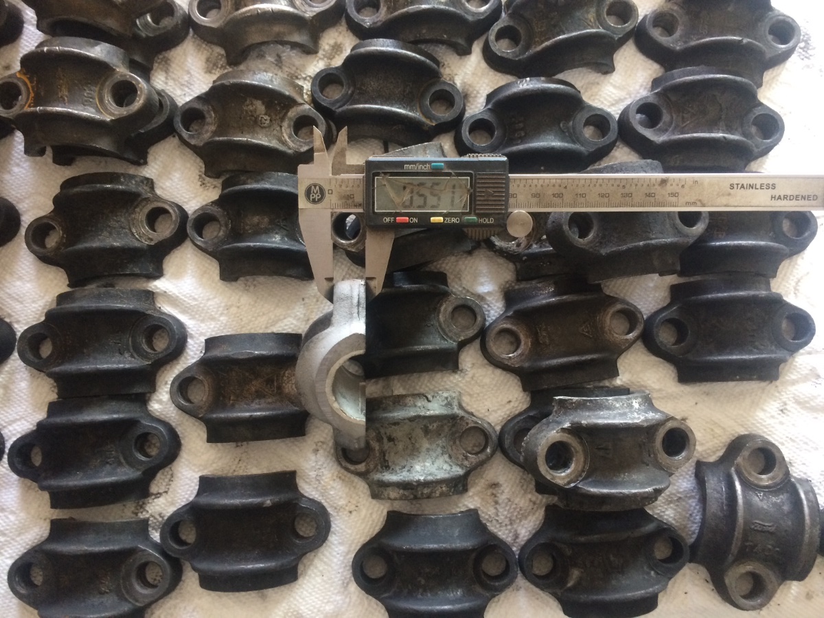

Can't help with what they started out as but checking a couple of dozen, I come up with the thickest at 575 and thin 535.

Kerry. That is about where mine run but have some thinner.
My next question. Why do I have more than twice as many center caps?

Why twice as many centre caps?
Because many a engine rebuild has ended up with a front bearing cap being used in the centre, therefore a surplus amount of centre caps turn up in collections. Which isn't a problem if the babbitting is done the full length to carry the crank jounal and match the block in bearing length.
