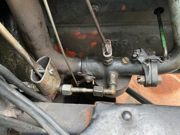

- Posts: 2948
- Last Name: Hjortnaes
- Location: Men Falls, WI
Re: Engine turn off after a short drive.
Kevin, can you post a photo of your carburetor?

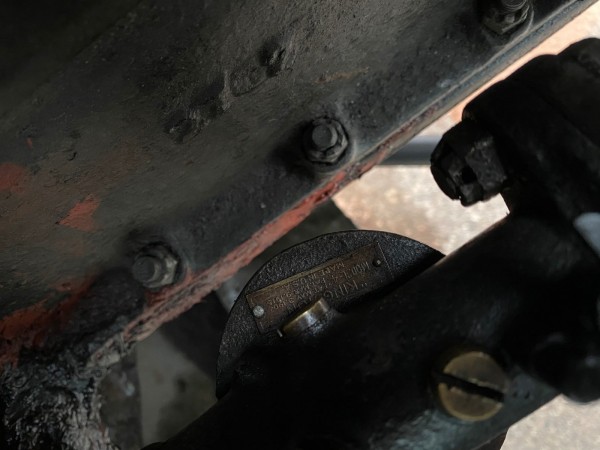

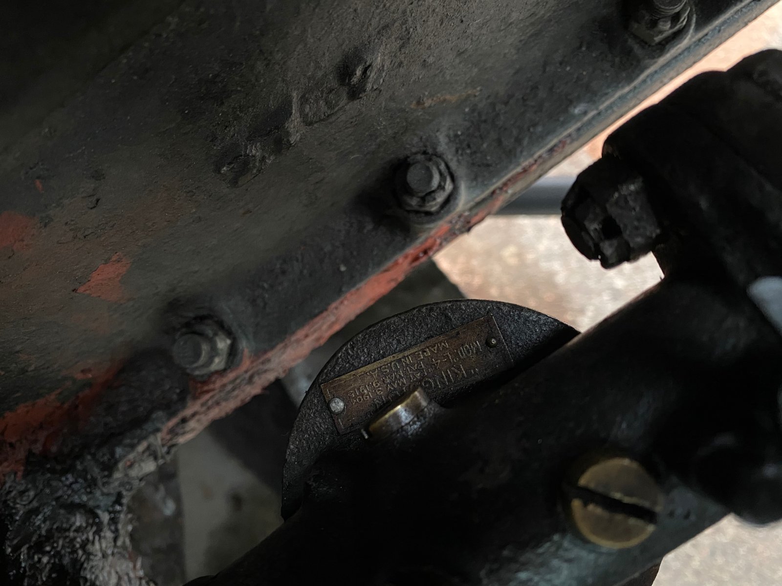

keevge
Topic author - Posts: 5
- Joined: Sat Nov 09, 2019 3:33 pm
- First Name: Kevin
- Last Name: Hitzler
- Location: Germany
Hi,

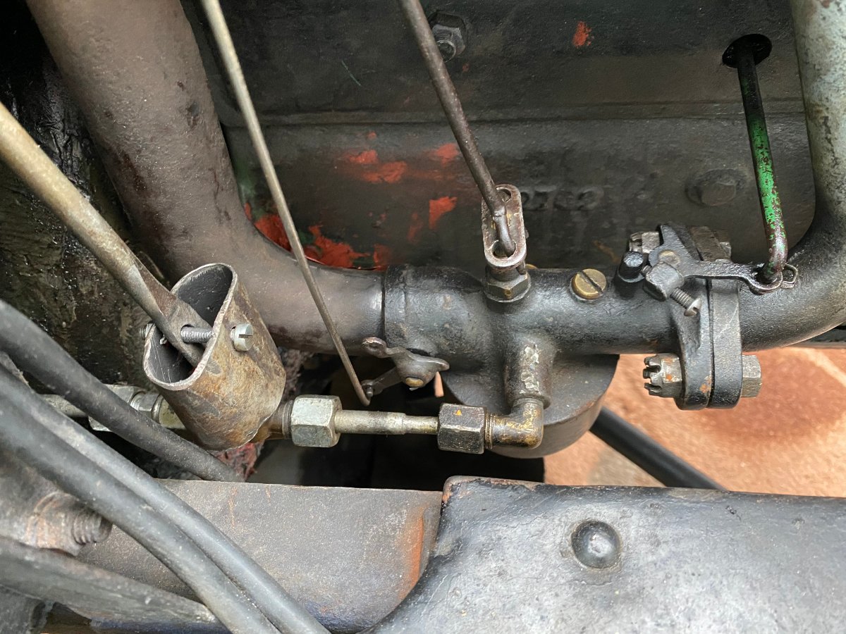

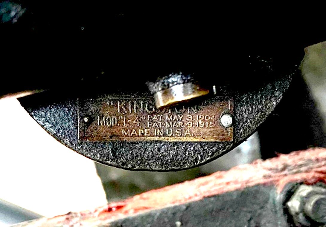

i attached 2 pics of the Carb. I ever thought it was the original one.
I've testet the Tankcap today and the ventilation works fine.
Then i've tested, if fuel applies to the carb, in the second the engine wont restart.
i opened the union nut? infront of the carb and the gasoline flows perfectly out of the lane, allthough thers a filter installed.
@ Frank: i mean the engine rpm does not increase and because of that the Car does not go faster.

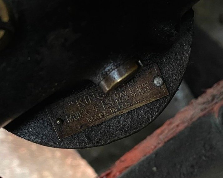

- Posts: 6544
I zoomed in on the carb picture to get the model. It is for a Model T. Also added some links about adjusting it etc. I'm certain others can provide better adjusting instructions for that Model Carb.
http://www.mtfca.com/discus/messages/29 ... 1183245409
http://www.mtfca.com/discus/messages/17 ... 1311227031

The Kingston L4 is a good carburetor but it is more complicated than the Holley NH. It has a flap which opens up the passage for higher speed driving. That flap must be loose enough to move by the pressure of the air going through. I would suspect that you have a problem with the float valve because you state that the carburetor drips when the fuel valve is left open and that it runs out of gas while you are driving it. Check the float valve. The original had a needle and seat. If dirt gets in that area, it will either cause the needle to not completely close which will allow gas to leak out when parked with the valve open. Also a bit of dirt in that area could restrict the flow of gas so it runs out of gas when you are driving. There are good valves available through the parts suppliers. I would recommend one with neoprine needle. Some rebuilt carburetors have a gros valve. This looks like a small ball bearing. I don't recommend that type. They tend to get clogged more easily than the needle type.

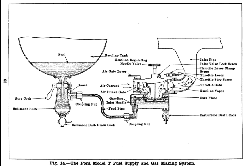

Kevin, almost everything in a Model T is manual: spark advance, throttle and air/fuel mixture. While there have been many suggestions on mechanical solutions perhaps, as a new driver, it would help to understand what you do when while driving to adjust the air/fuel mixture.
http://www.mtfca.com/discus/messages/50 ... 1224862310

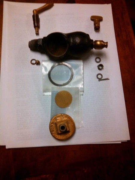

When the time comes to rebuild the Kingston L4... This link shows the steps to do it
https://modeltfordfix.com/repairing-a-k ... el-t-ford/
