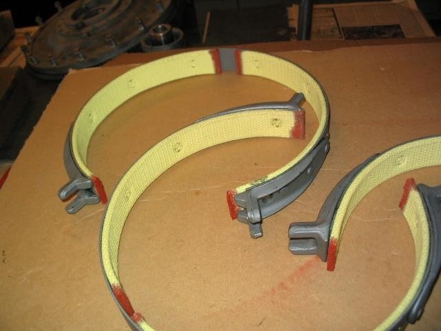

An Alternative Way to Install Transmission Bands
I am in the process of replacing the bands in my '13 Touring. A friend of mine sent me the photograph below showing a gap in the bands. The picture came from the website of Kohnke Re-babbiting. Clearly Mr. Kohnke is a Model T expert, which gives him great credibility. What is the opinion of other experts? Good? Bad? Not necessary?

The recommended way, where you first mount the rivets at the upper end and have a bulge at the bottom that you straighten out once the rivets are in place, will ensure that the band sits tight to the band. I can fear you dont get that with the shown method.
I also takes my bands through a pair of rollers to make sure the band is truely circular and not somewhat oval.

I am not sure of what you are saying. The thread you are referencing is probably from where my friend saw the gap in the bands. I am assuming that you feel this is a good way to do Kevlar bands.
Mike

My take, I understand the thought process behind the gap but I would do it different. I would install them the normal way, then after installed trim out a section and seal the ends. IF I was to install them that way, but am not going too, I do not see the need for me so would just install the normal way.

Before I found the Herms thread about the transmission rebuild I broke a few drums on both of my model T's and start to use wooden bands on them. I didn't brake any drums with the wooden bands. Is it the wood or is it because I get more drive experience, I just leave it in the middle.
As I am a mechanic and repairing engines for freinds an later friends of friends of friends, not all of them like the wooden bands, I started to install the kevlar bands the way Herm shows us in 2013.
I am not rebuilding model T transmissions at the scale Herm does but since I use his way to do it, I have never had problems with the drums or the bands.
First of all the drums must be in good conditions and the surface must be smooth as a mirror, the bands must be clean, clean, clean, clean.
By leaving a gap in the middle of the lining you get more oil on the drum and in the band material so you get better cooling and less chance to crack a drum by overheating.
The gap makes the band also better flexible and make it take better the shape of the drum, less slip better block so less heat on the drum.
To install the lining I set a mark on the middle of the steel band that indicates the gap and start to install from that point both of the linings. Than take the other side of the lining to the ear side. With the ears installed, I make the lining going 1/8" pass the ears so the ears can not touch the drum. As bothe sides are fixed, I take a drum and tighten the band around the drum so the lining is pushed against the band, leave it a few minutes and push the other rivets in the kevlar. Take it all of the drum and push the rivets all the way down on a drum shaped piece of wood and fix them.
Before I install the bands in the transmission, I put them all in oil for at least 24 hours .

When you install a lining that is cut in half, do you rivet the two ends first and then push the bulge down in the center to make them tight against the band as you would with traditional band lining?

The length of the lining is mesured on the outside of the steel band. The reason is, the cercle on the outside is longer as at the inside. It is just what is needed at the inside to make the lining the bulge to make it fit just the way it should.
