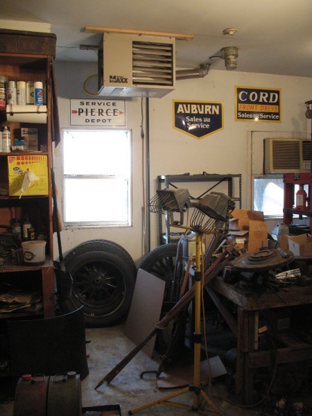

Post by Steve Jelf » Sat Nov 30, 2019 11:39 am

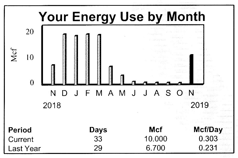

My shop is 22' x 38' with a 9' ceiling. I heat it with a Mr. Heater Big Maxx ceiling mounted gas heater. That's way above any potential gasoline fumes, which are heavier than air and go to the floor. I am a cold weather sissy, so my thermostat is set at 68º F. My office/storage room above the shop is also 22' x 38', and has an 8' 4" ceiling. Warm air coming up the stairwell keeps it about as warm as the shop downstairs.The building is well insulated but has single pane windows.
My most expensive gas bill last winter was for January 17-February 15, when I used 17.2 MCF and paid $139.86. My only other gas usage is for the water heater in the house, which is about $25 a month, so I figure my winter spending for shop heat is about $100 to $115 a month.
If I ever build a new shop I'll go with pipes-in-the-floor heat.

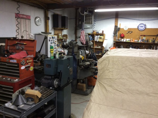

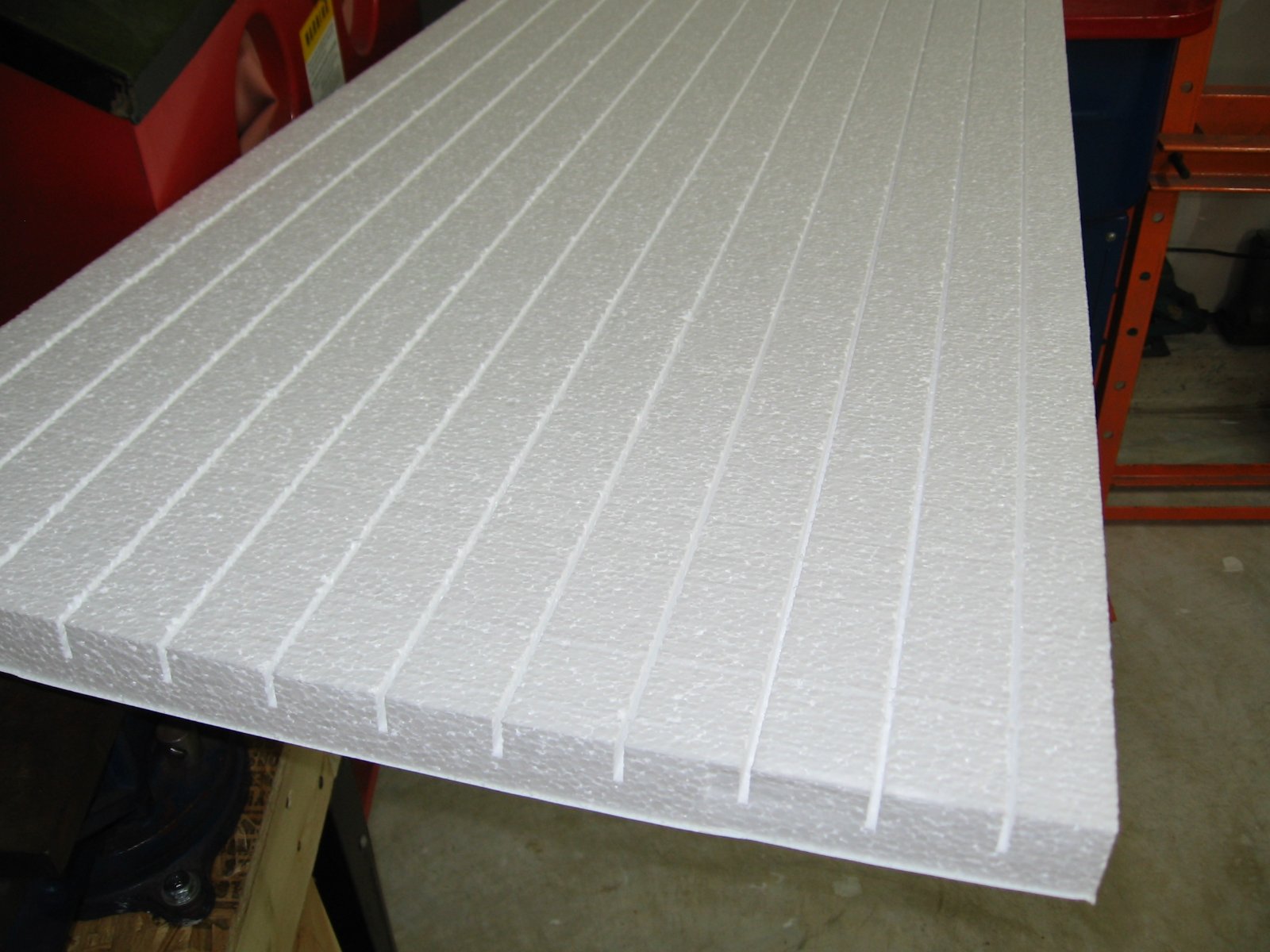

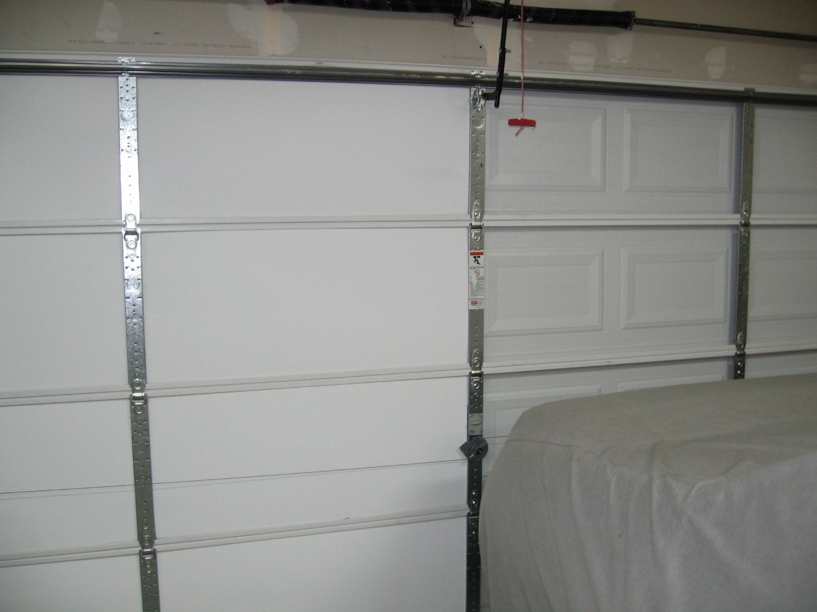

Post by John Illinois » Wed Dec 04, 2019 8:50 am
I have had this shop and propane heater for about 30 years. It was first a small engine shop to supplement my farming income.
Now it holds 3 hobby cars and 1 driver. Several years ago I updated the insulation to 4” foam. I have a program thermostat and keep it 45* at night and 68* day during winter.

Post by Piewagon » Wed Dec 04, 2019 9:39 am
I have a "T stall" where I work on my T's. I bought a surplus "in the wall" furnace made by Williams which was new but dented on the side where it would never show. It uses natural gas and is a "counterflow" furnace pulling air from above and exhausting it down at the floor. No ducting at all required. It comes with a wall thermostat that controls its output and I only bring it up to work temperatures when I am out there and otherwise is doesn't turn on. It vents directly through the wall since it is mounted in an outside wall cavity. It measures 14-3/8 wide and about 6 or 7 feet top to bottom so it slips between studs. I also installed the same item in my son's 2 car garage so he could work on his cars. They come in various BTU amounts and both units have been trouble free. These are a bit pricey if purchased new from Grainger but shop around and you can find them new at less than half the retail price. Can't remember what I paid but it wasn't too much money. It was easy to install and hook up. They don't cost you any shop space and are up off the floor which helps at cleaning time.

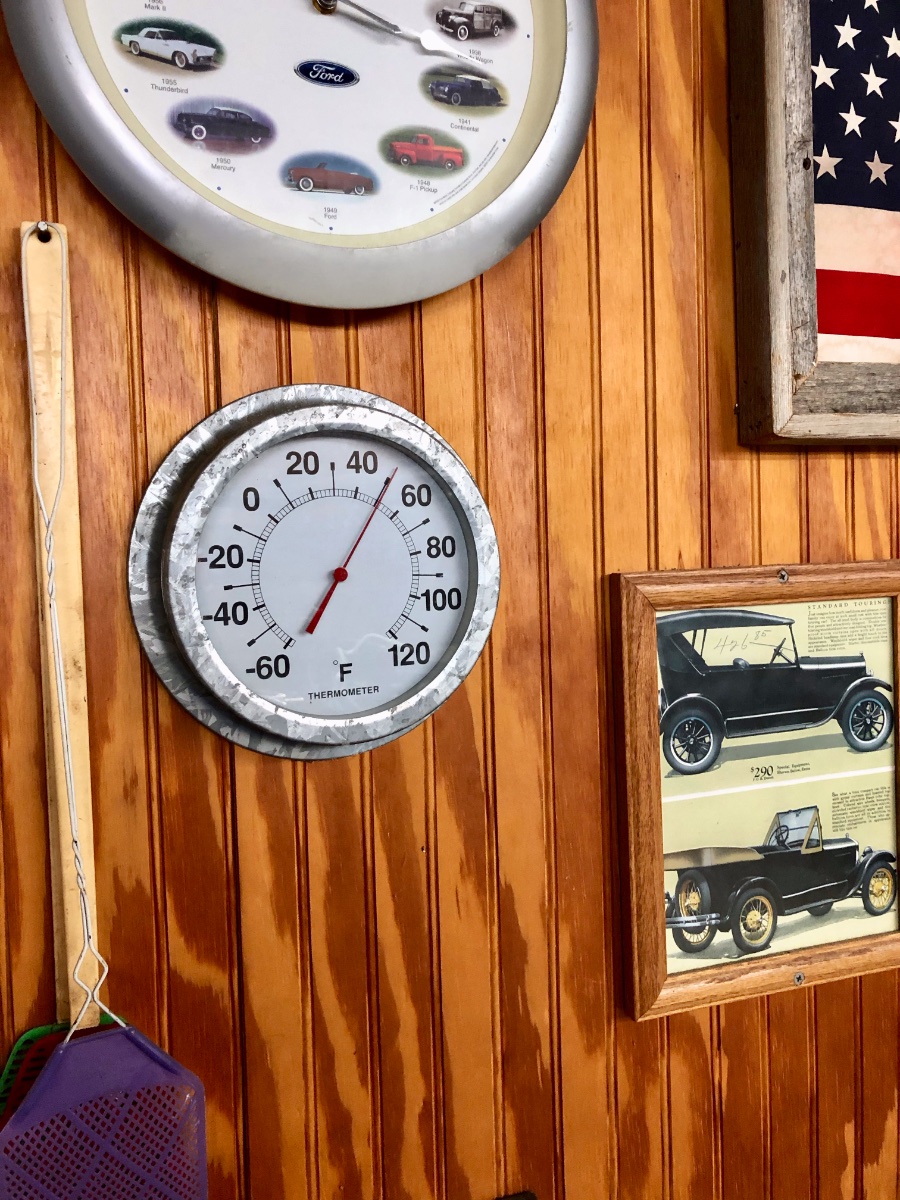

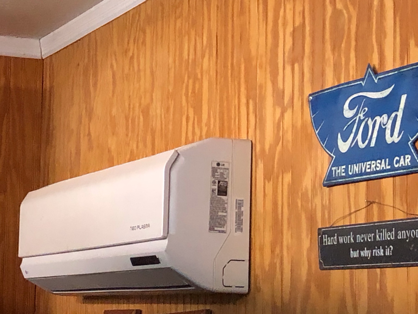

Post by DanTreace » Fri Dec 06, 2019 9:31 am
Garage too is separated with storage and work/storage.
Since weather is mostly hot in summer, the little split system heat pump cools the 30 x 24 work area that is fully insulated with insulated overhead doors just great. When the cold sets in the heat pump is so nice ;) Actually use it more than the A/C.
Now since last night was chilly, the shop is cold from overnight, just have to open the doors and let in the warm today air, expecting 71 degrees by noon :lol:

Post by Novice » Fri Dec 06, 2019 2:07 pm
Most Heat Pumps use outside air heat exchangers and stop working when the temp gets close to 40 degrees . and switch over to a resistance heating element. A water source heat pump that uses a loop of pipe buried under the ground or well water is most efficient and will work year round. even up North. I have a Frigidaire Window A/C heat pump work great gets up to 86 degrees but heat output drops rapidly when it get's into the low 50/40s and switches over to Resistance heating. works off 110 Volts would take a large 220 volt heater to put out the same amount of heat. great down South.

Post by Scott_Conger » Fri Dec 06, 2019 6:20 pm
Jim
the data you're refering to is old data. I was amazed to find that (some) heat pumps will now work down to -4F with heat strips conditioning the coil and then switch over to pure resistance heat strips below that temperature.
I am waiting a year or two to start getting feedback on their reliability vs brand, and then am considering switching my cabin over, at that time.
I'm not an expert, but have seen the system. For anyone who wishes to dispute the low temp operating range, I can't/won't get into that contest: https://www.nordicghp.com/2017/01/heat- ... ure-range/
