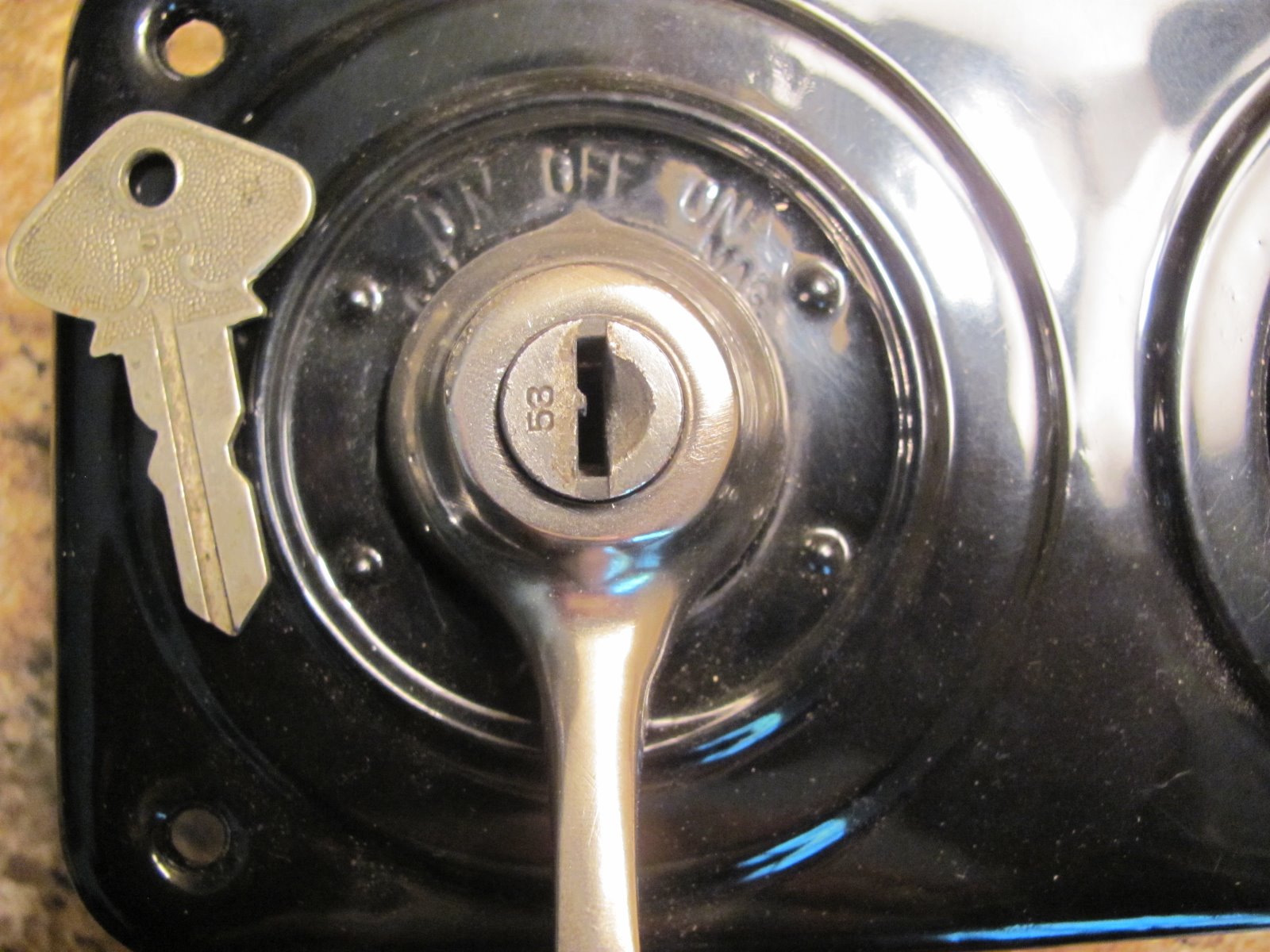

There should be a number stamped on the face of the tumbler. That number is the number of the key you need. Or you could try this. https://www.modeltford.com/item/5013-MSTR.aspx

In very small type above the key slot there is a number stamped on the tumbler and that will be your key number for that switch.

Okay, so you fellows made me look again. The tumbler had been painted and I could not see the numbers. Even this time I couldn't see the numbers unless I held a flashlight at about a 23 degree angle they were faintly visible. Scraped the paint off and there it was!! Just like in Dan's picture and mine is #53. Feel kind of stupid but with the paint and poor lighting in my garage, I didn't see it. I also now think this is an original switch.

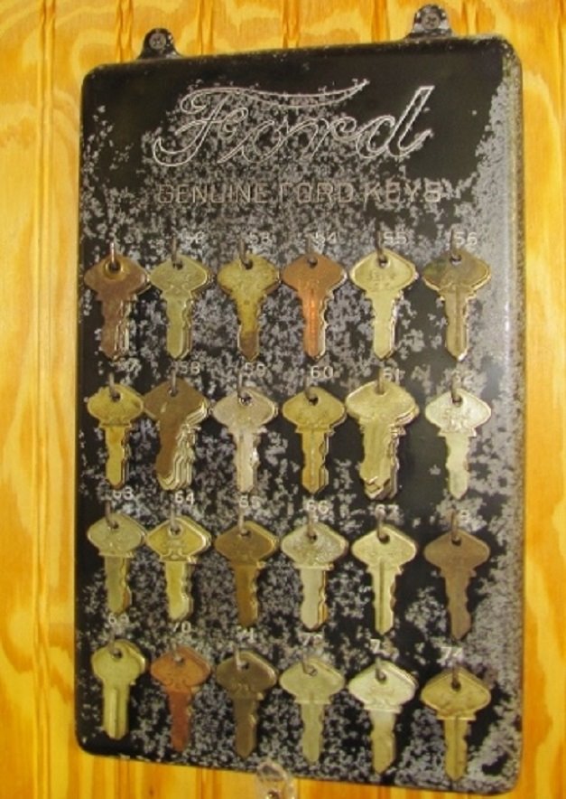

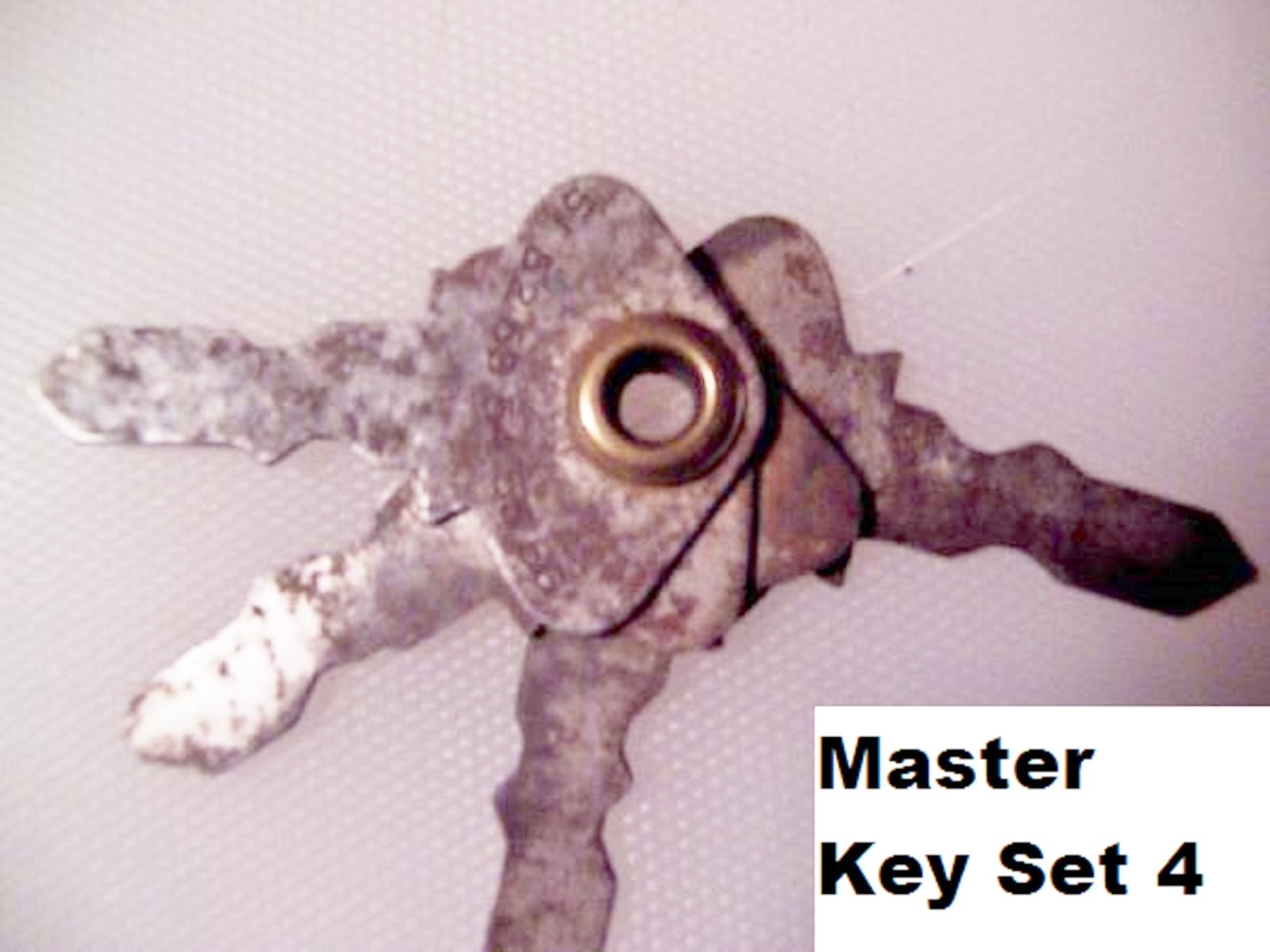

Really isn't a single 'universal key' Model T ignition key, (except for the early coil box mounted switch
), but a set of 4 keys that are masters for the 24 different Model T key numbers.
Each master covers 6 of the 4 series of tumblers.

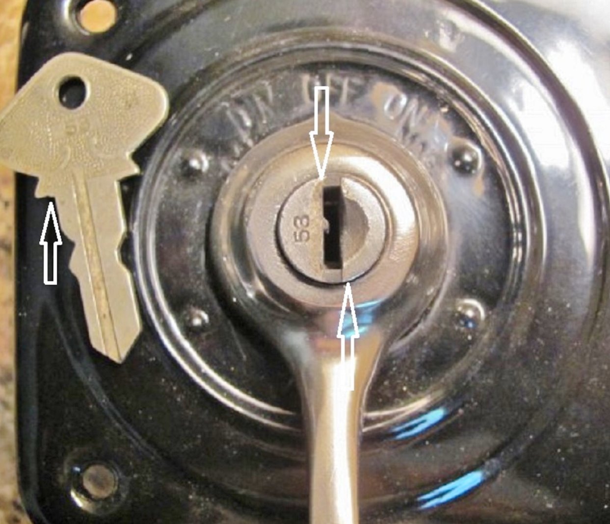

And these master keys are very thin, without a 'key way groove' as each of the number keys must have. Ford was able to make these many different keys for the ignition tumblers by alternating the location of that groove.

Dan, thanks for the info on the universal keys. I knew they existed but didn't know much about them. They show them on eBay, but like you stated one key for a series of numbers.

If you note the design of the key it has sharp shoulders at the top of the blade. Those two shoulders are made to fit into the recess matching shoulders on the pot metal body.
The reason is to give a full surface of the outer edge of the tumbler for the key to take the pressure off the insides while turning the switch body. So take care on insertion of the key each time prior to twisting to BAT or MAG
