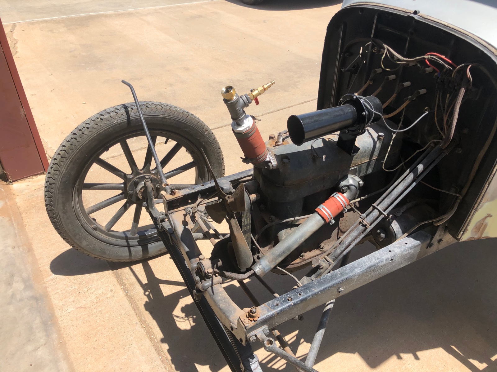

As I approach substantial completion on my 1924 c-cab project, I now am in the fine tuning phase, which also highlights how much I still don”t know about these machines. Overheating, timing adjustment , tire replacement etc are all still to address and a common theme in this forum is to find a nearby fellow owner to provide guidance. Being out here in Lubbock, it appears that the closest club is Dallas, just a short 5 hour drive.Any body any closer? Coffee’s on and beer’s cold...

Don’t know how much you had to do get your TT going but looks like your doing a good job. If you are a hands on guy you can figure out what needs to be done as far as fine tuning your truck can be found on the forum. And in the end nothing is a better teacher than using a hands own approach. You probably have the Ford T service manual and maybe some of the MTFCA publications. Hopefully there is someone in your area to help but if not this forum has a LOT of info to be accessed.

Thanks John, I’ve been doing just that. I’ve learned a lot from the forum and by pouring through the Ford literature. I’m sure I’m most of the way there but nothing like the personal influence of someone who has “been there, done that”.
As to what the truck needed, it barely ran when I got it and had been sitting for many years. The body work was showing its signs of age on a poorly done 1970’s restoration and basically had to be taken to bare metal. A rewire job, engine and radiator flush, and lots of body work. The engine sounds good now for the most part but have not had the head off so I may just be hoping against hope that it won’t need as much work as the rest of the truck has.

As you have probably read on the forum if the radiator is an original it may or may not cool even after a clean up. Hopefully it’s still good but old radiators can fool you even though they may look good. Pulling the head off isn’t all that difficult.
And if you do that cleaning out the water passageways can be done and probably help cooling.
Carefully using a 1/4” drill bit when drilling out the small water passageway holes in the head and block can really help in circulation.
I finally bought a new Bergs radiator after going through 3 old originals and it was amazing running and driving my 24 Coupe and no having a boil over after a few miles of driving. It makes a REAL and enjoyable difference.

John - I have read about the lack of cooling from original radiators. I actually finished setting the timing this morning so will see if that helps at all before I look at a new radiator. It looks relative clean but the previous owner appears to have left raw water sitting it for some time and it took a bit to deal with that issue.
