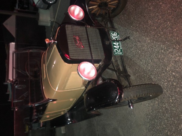

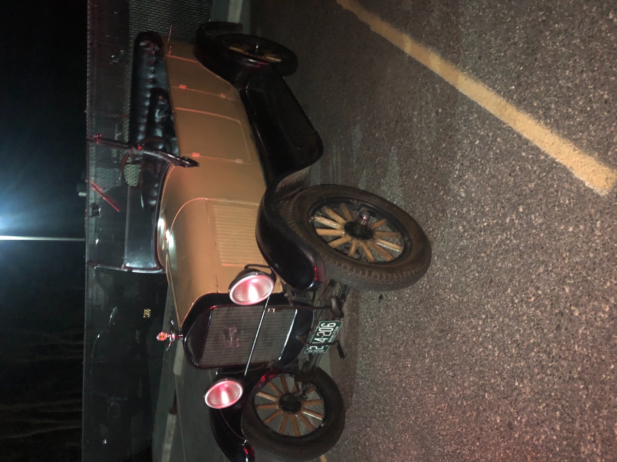

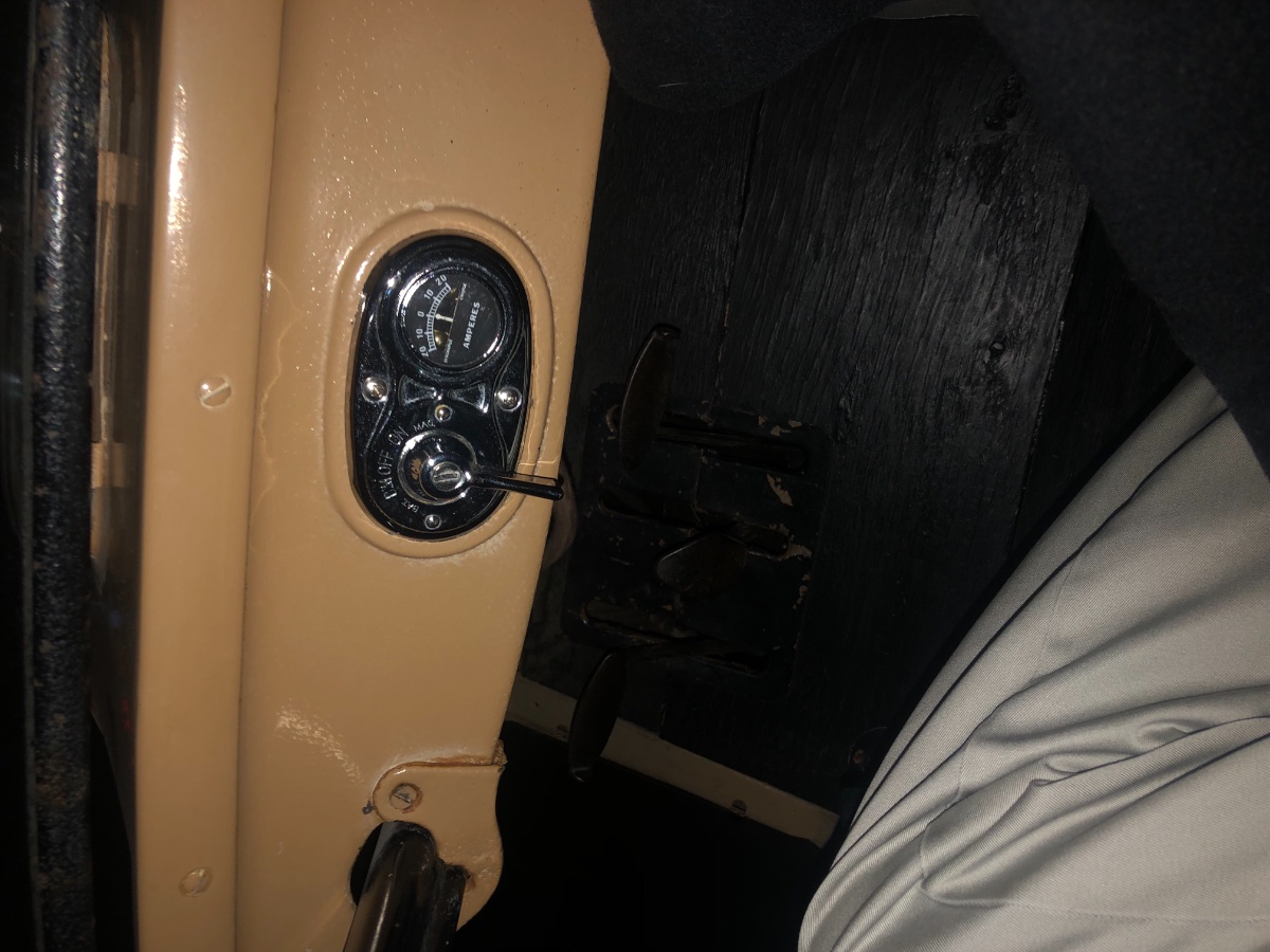

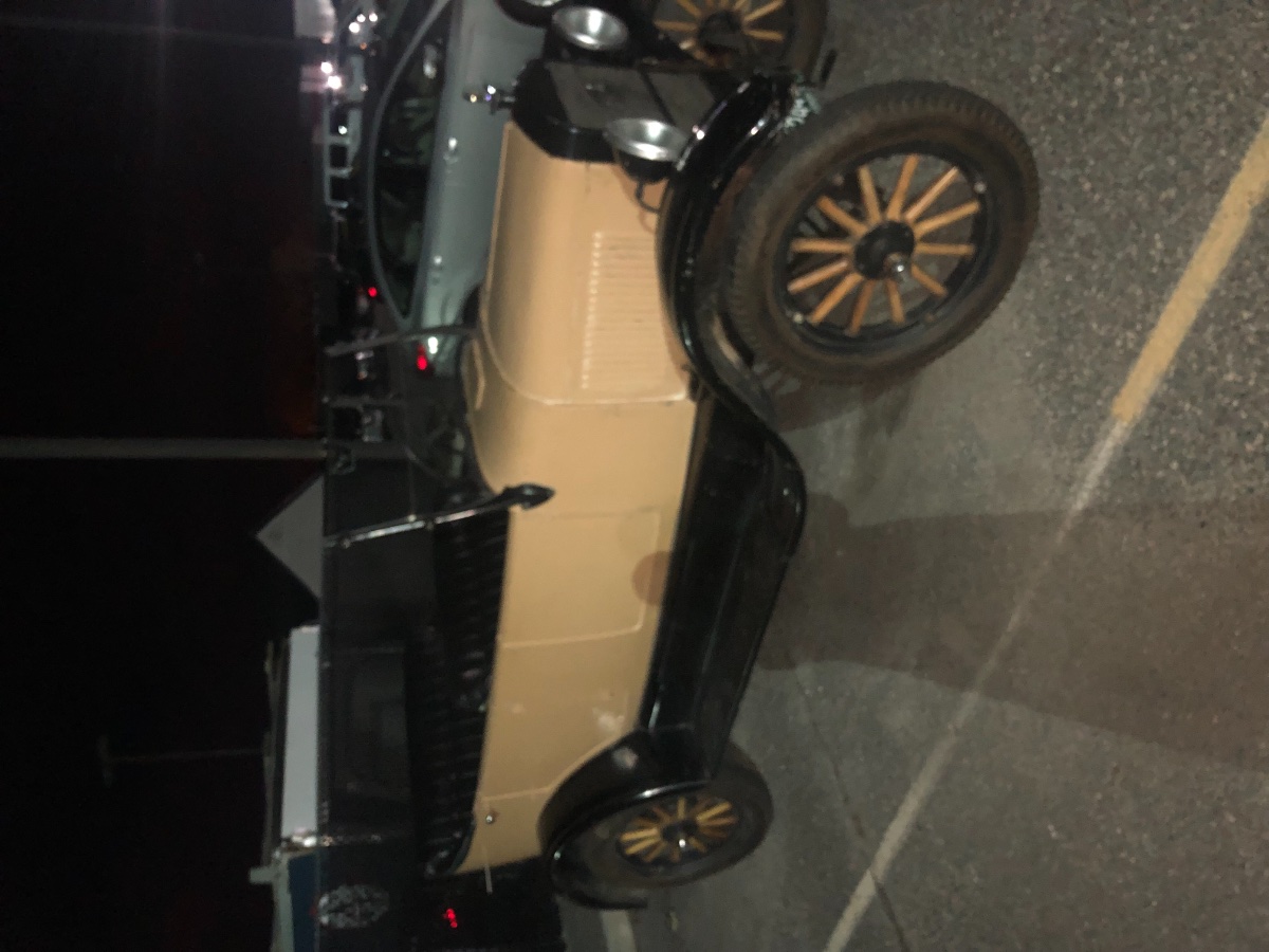

Hello, everyone out there in Model T land!
After intently watching from the sidelines, (Especially during TROG.) I’ve decided to finally pull the trigger and adopt my first T-A 1926 Touring car....
....After a few hitches pulled by some unscrupulous “transportation broker/Jokers,” the car is due to be dropped off in Wildwood NJ in the wee hours of the morning....I can’t wait!
I’ve worked with and on a local 1918-So I’m reasonably well-versed thus far....My car is a solid original with only *one* hiccup; Although a new convertible top is included, the top irons were inadvertently thrown away! If I may ask, were the top irons different in 1926-7 than any other years, or is it possible I can use earlier Touring irons and make them fit? Thanks in advance! -Rob

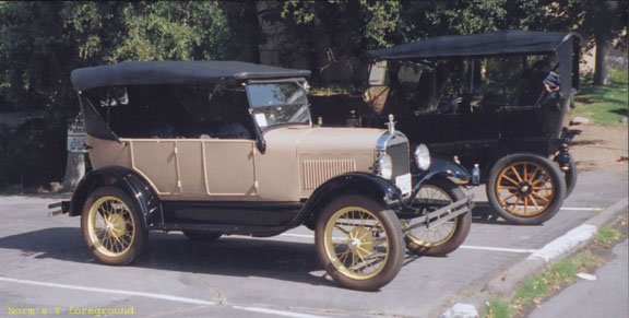

Post by Norman Kling » Thu Dec 05, 2019 9:30 pm
you can get brand new ones for about $1000 from the vendors. The 26 and 27 irons were different from the older ones. You can sometimes find used ones for sale but are usually in very poor condition because they were formed from thick sheet metal which was rolled and has an open seam. So over the years water gets inside and rusts them out from the inside out. Sometimes you can weld or braze them up but you need to be very careful not to force them when you put the top up or down. New ones will last a long time, but cost quite a bit.
Welcome to the club. See my 26 touring I will post 2 pictures. One was the day I bought it and the other as it is today.
