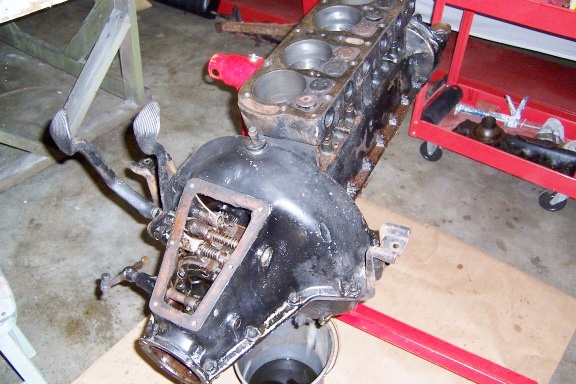

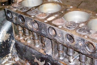

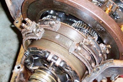

In 2012 ran across a couple of engines, at bargain price for all. A complete '15 and a rough '17, along with a '22 that I put to use. Sold this '15 to friend for $350 and parted out the '17, leaving the '22 free and clear.
The 2012 sold '15, ribbed pedals, good trans drums, original cast iron pistons and valves, narrow nose pan was nice too.
