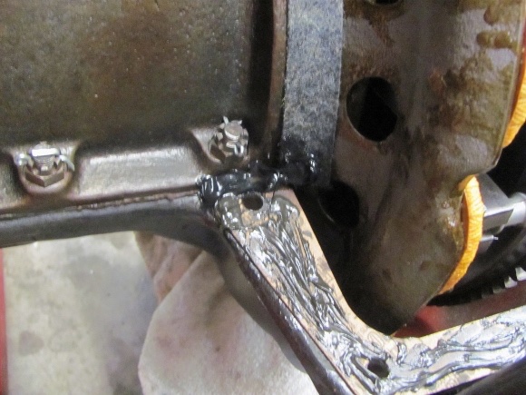

You can wrestle off that hogshead with both hands, but question is why?
Normally the felt seal over the block doesn't degrade. Unless someone left it off, and you have lots of oil streaming from the top of the hogshead.
The typical leaks at the hogshead are at the lower corners, where the hogshead joins the pan. There a bit of extra sealant is helpful, the Ford manual states to use a piece of candle wick, but good silicone sealant is useful too. Note the extra dab of black silicone on top of the fiber gasket that is sealed with Permantex. That felt gasket has been pre-soaked in varnish, that squeezes out and dries to a nice seal around the engine block curve.
IMG_2809 (1024x768) (580x435).jpg (132.67 KiB) Viewed 8015 times
Have fixed leaks at the lower side of the hogshead there, without pulling the hogshead, by cleaning very well all oil/dirt/grease at that corner on the outside, then wiped with lacquer thinner and get those outside lower corners very clean. Then apply a large dab of black silicone sealant on the outside at the lower corners, that will stop oil seeps.

I’d try Dan’s silicone suggestion first.

I, too, agree with Dan's comments and will add my opinion/clarification to his message: The black silicone sealant to use is Ultra Black Gasket Maker RTV. This is far FAR superior to other springy/stretchy products on the market. They have a purpose and use in life; just not this one.

I have removed and replaced the hogshead on a couple of engines. The two most recent I had the leak between the felt seal and the pan. Good to see that I am not the only one:) Also a good reminder to put silicon there BEFORE putting it back together. I did the clean/and try to get silicon method after the fact now it doesn't leak too much.
