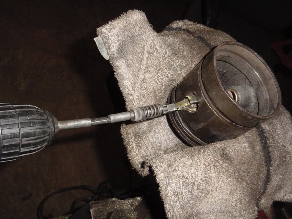

So I got the Timesaver out I have had for years in the cabinet. I got the 1/2 inch brake cylinder hone and such out of the tool box.

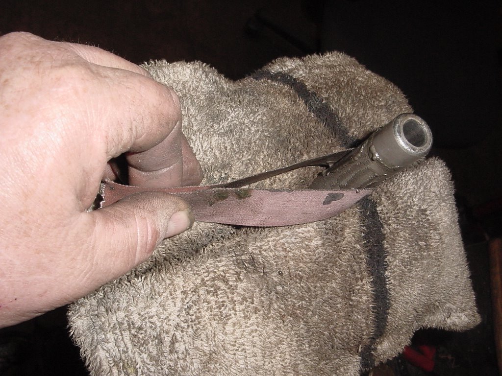

I determined there was wear on the wrist pins.Darn,I woulda thought brass would wear out before steel. So I worked on the wrist pins and got 4 cleaned up a bit.To remove the high spots I used emery paper with valve lapping compound and then went to time saver and oil on some more emery paper. seems to cut down the metal faster than just emery paper alone.
I then went thru the pins and tried each 1 into each piston till I found 1 that would sorda start. I kept those together and went thru the other 3.
I honed each side until both ends of the wrist pin would go in.then I would rub the high spots off the wrist pins using a magic marker to indicate first until the neighbor showed up and loaned me his can of dykem.

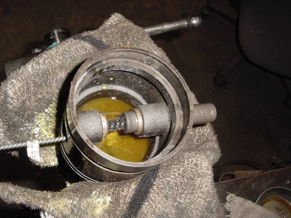

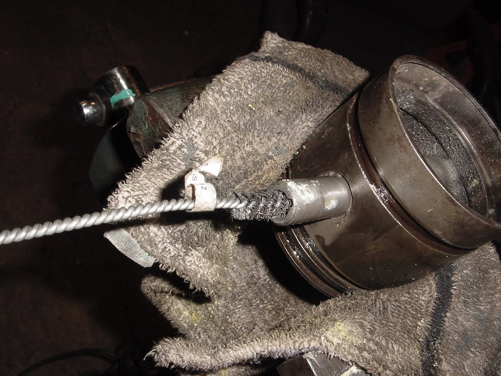

Once I got the wrist pin going thru the 2 bushings I then got to thinking about this pin needs to be straight and free to turn. What could I use to do the final fit? HUM ,the wrist pin it's self with oil and timesaver on it.HUm,how to turn the wrist pin? I remembered trying to use a boiler tube brush to clean out the wrist pins and it was a very tight fit. So I stuck the brush in the cordless drill, oiled the wrist pin,put Timer saver course in both bushings and started in, after a short time I added more time saver,then went to the fine grade,and it spun and went back and forth just fine.

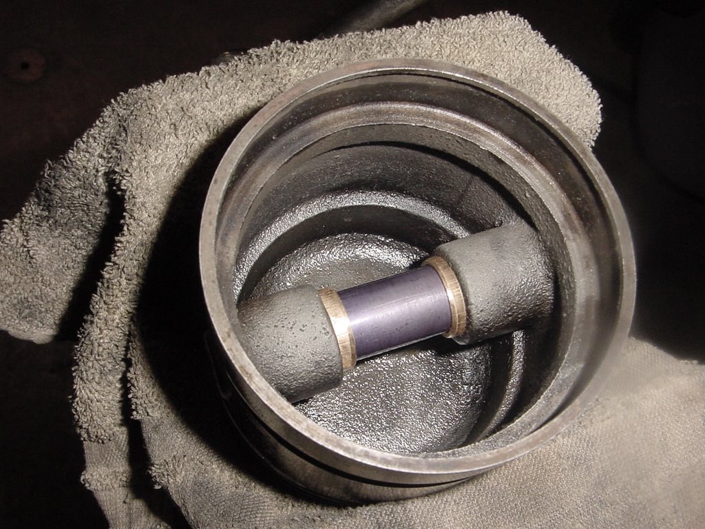

I cleaned everything up,put oil on the wrist pin and if you hold the piston sideways, the pins falls out easy,pushes back and forth inside easy and spins easy inside the bushings. No up and down slop like they had before bushing replacement.
I think being inline is the most important aspect of the thing and I think using the wrist pin and yellow Ajax as I call it,made sure of it being inline.
