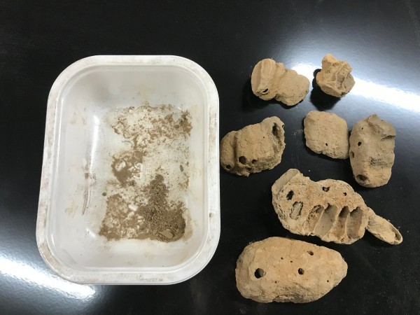

I had a nice oval tank that had a distinct rattle. Was told it was likely a rusted out tank baffle. There have been a few threads about the baffle that should be on the underside of the gas cap. Mine was gone so maybe that was the cause. I shook the heck out of it and pulled out a few wasp nests. Even so that didn't get one stubborn one and given the size of what I got out it must have been really big (the biggest piece is thumb size).
Vinegar is used to expose fossils in lime stone. So I tried pouring some vinegar in the tank and position it to dissolve the remaining nest (some of what is in the white dish). Flushed the tank with hydrogen dioxide — H₂O to get the remaining grit out. And repeated the vinegar wash for any rust. It did such a good job dissolving rust, it opened up two small pin holes on the wasp end of the tank from the inside!
