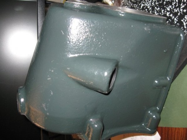

I have never had any problems or complaints with Bill Hirsch paints, especially the engine enamels that the sell. I have used them on Model A's, Packards, Buicks and Dodge Brothers and they always look fantastic. The photo below is of a spare Model A transmission case that I had on the shelf, it is painted with the Bill Hirsch, Ford Model A engine enamel.
They offer it in aerosol or in a 1 quart can as well. Just be aware that "full cure" for their enamels takes a little bit of time, probably the only drawback. I know that Bill Hirsch supplies at least one of the Model A vendors, but I do not remember which one
