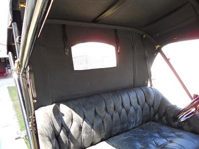

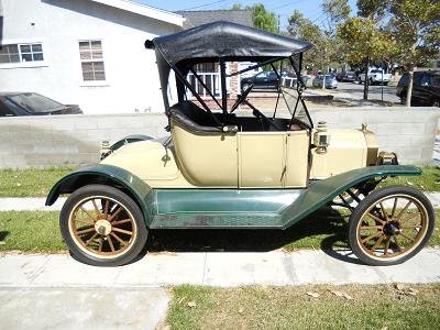

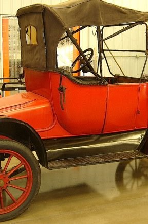

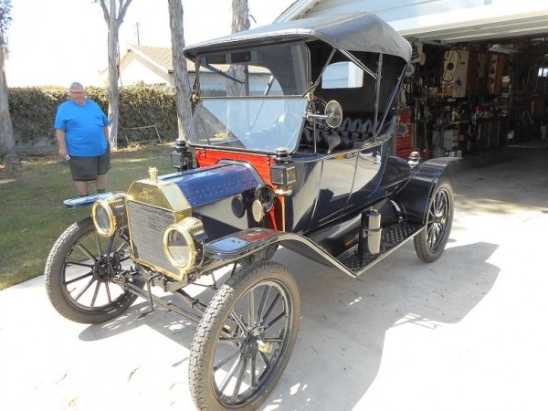

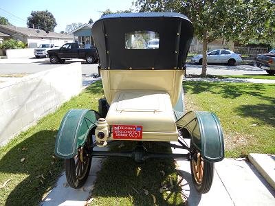

I'm no expert, but I did copy the original top exactly from my car. A '14 top would probably work, but is not correct if you are into authenticity. My cars top came out fine, and still has the original wood bows too. I placed original common sense fasteners in the correct locations as well.
The top was completed before I restored the car, so there are a lot of features that are not correct. The car is now restored, and I received a first place trophy with it at a recent AACA Western National Meet. If I had not have bought the blue paint previously, I would not have painted the car blue. There was no evidence anywhere on this car that it was ever blue. Everything was black.

Had the pleasure of seeing this T at the recent AACA meet in Fallbrook CA and actually used it for a judges training seminar. Nice job on it and thanks again for your willingness to allow some judges to learn about it.

Larry,
Thanks for you input and pictures, I am not into having my car judged and as for Authenticity, I'm OK with the top looking good and being functional. I will try a 1914 top, unless, there are plans that show the correct measurements for a 1913 Top. Possibly I could get a copy and send them off to Cartouche and have them make a period correct 1913 Roadster Top, as I was told they DO NOT HAVE A PATTERN to produce the top from.

Take a look at the second attachment posted by Mark Strange. It should answer a lot of questions for anyone doing research on a 1913, including the top for the roadster. One thing I would like to share, is the common sense fasteners for the side curtains were placed into the bow drill before being sewn into the top and rear corner pieces.

WOW! Sure does look SWEET Larry!
