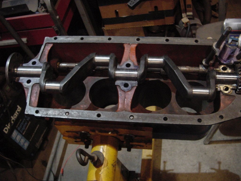

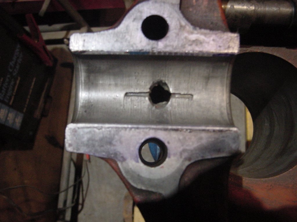

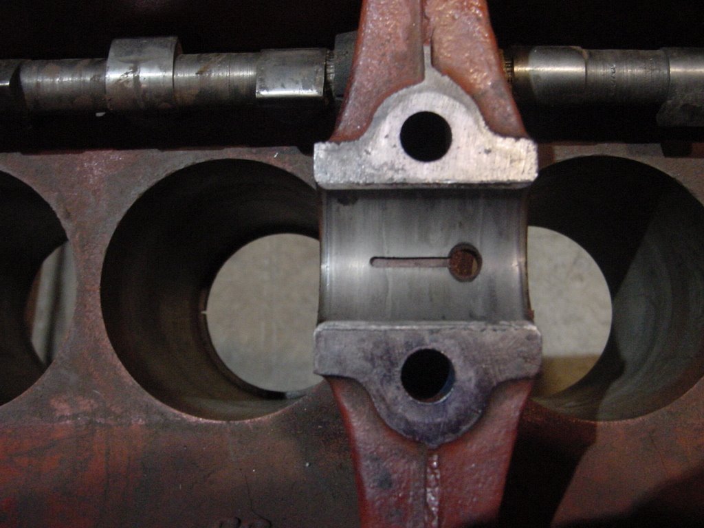

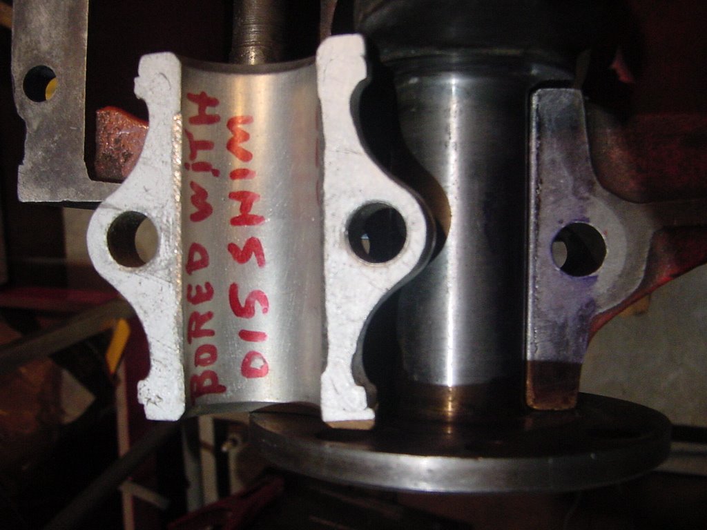

Well,I watched a couple of the videos. I saw how they turned the crank checking it for tightness and such.
The method of measureing I think was my issue.My calipers are cheapos. It is hard to explain,but I will say,it was user error with the measureing.
I went down to the shop and I decided to check something. I took a main cap,and I held that cap down hard as I could with 1 hand and turned the crank.I figured if it was as bad tapered as my silly readings were indicating,I should be able to feel it raise the cap. I did not..I assembled the crankshaft to the block with the new shims which were around .018 or so accordning to my cheapo tool.I put some 60 grit time saver under them and turned the crank some ,cleaned it and . I then used the finer grit.
I took it apart,cleaned everything.And the rear main on the crank was grey and no shiny spots, the center was mostly grey with a litle shine here and there.The front was mostly grey. I decided,nothing to loose by trying,I did not scrape anything. To get the rear main to seize with a piece of news paper,it has .011 worth of shims. Now until today I had totally forgot that Jack Daron had sent me a nice rebabbited rear main cap probably back in 2008 or so. So that is the 1 I used. It had been cut to the right size and such for the end play.If I have any end play it aint much.
On the middle bearing,.007 in shims and with a peice of paper,it was tight,but not seized.I had not read the new entrys on this thread at that time.I will reread all the stuff above and see if that is to much or to little shim or something.
The front main,has about .0135 in shims.
Now when I turn the crank,it turns smooth,all the way around. Forgive me if I am not making sense,something slipped while I was tighting a main and it wretched my back bad and I am gritting my teeth to keep from squalling right now.
The way I look at it,nothing I did today hurt anything or is irreversable. So I will let you folks read this and then come back with opionions.
I can turn the crank fairly smooth with a rod stuck in the front hole of the crankshaft.Not sloppy loose,the weight of the rod will not turn the crank.

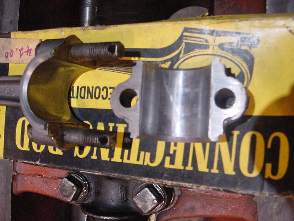

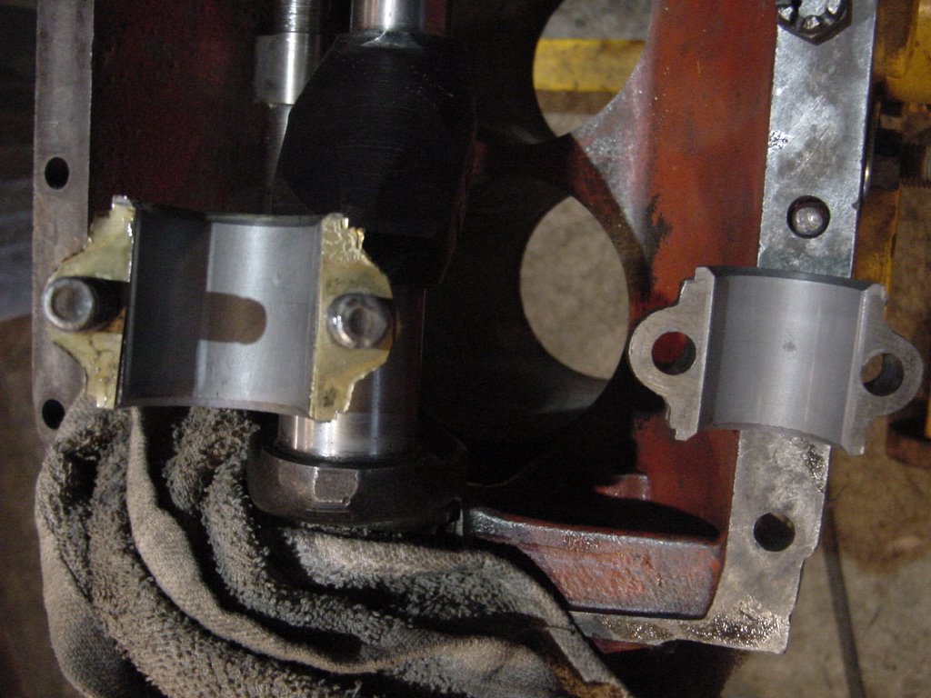

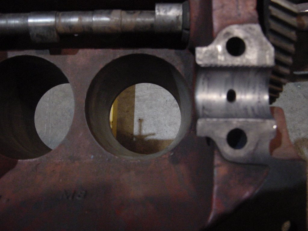

Ok,I have put the rods to the crankshaft,torqued to 30 pounds. A peice of news paper siezes them,remove it and the rods are free to move.I think that is close.Each of the rods has .020 in shims.only 1 rod,number 2,did i have remove about .002 or so to keep it like the others. Best I can tell the rod bearings on the crank measure 1.243 to 1.245 or so,
I did find 3 bolts in the rebuilt rods had to be replaced as when I took the nuts off the rod bolts they were way to tight.
and stripped the threads when I went back to torque them.I had plenty so no biggie.

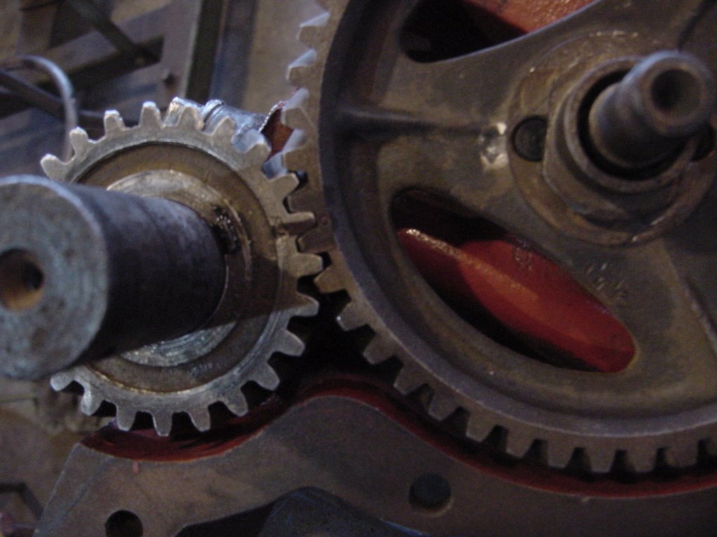

Cam gear was changed for a almost perfect 1 on the crankshaft this morning.Fits good to the NOS Ford gear I found somewhere 10 years ago or more. Valves come up a 1/4 inch, I set the clearance to .014 to .015 .I looked around on the old forums and .010 and .012 were listed alot,but then others were saying more.Chaffins catalot says .015 so I went with that.
The rod bearing has had some 100 grit timesaver on it for a few back and forth waves of the rod on the crank shaft. Turned out grey all over! Strange,I would have expected shiny spots!
My next concern is trying to get the wrist pin bolts to stay.I read some argueing on the old forum about wire and cotter pins ,sheesh,couldnt make heads nor tails.
I also had bought some dippers for the rods,my rods are not even x'ed.
I never could find a definate answer as to rather to x them or not,drill them for dippers,just a bunch of back and forth So I may just not do any of it and run as Ford made it. The rods were old stock from a Napa store .Raylock rebuilt is in yellow on the rod.

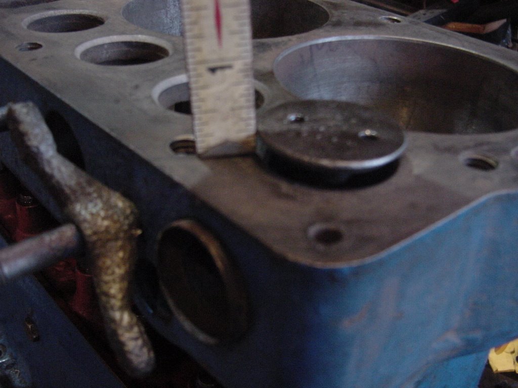

Get rid of the two piece valves before they break off and ruin your day.
- Posts: 4381
Re: fitting crankshaft mains,bearing scrapeing
Looking good so far Mack!
To echo what Joe Bell said, IF that is a two-piece valve, get rid of it! Of course, that goes for any two-piece valves in any engine you plan to actually drive. However, be aware, not all valves with two little holes on the top of the head are in fact "two-piece". Good (so-called) "one-piece" valves where made and sold as far back as the late '10s as replacements for model T Fords. And they continued to be made up into the 1960s that way.
Personally, I use good looking one-piece valves with two holes in the head.
tdump
Topic author - Posts: 1428
- First Name: Mack
- Last Name: Cole
- Location: North Carolina

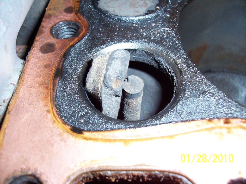

Where are they put together? I cleaned each 1 and they seem to be seemless all the way.I had read about a 2 peice valve but these are made like a old briggs and stratton valve. Can someone show me a picture of the joint in the valve?
- Posts: 5470
Here's where those 2 pc. valves are put together and they do have a tendency to "come from together" !!!
tdump
- First Name: Mack
- Last Name: Cole

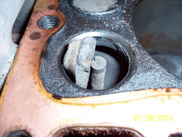

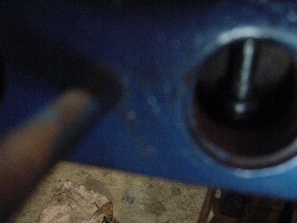

I stuck a camera in a hole and came up with this. I hope they are not bad 1s as they are good and thick and could be refaced a couple more times.
I was so tickled when I noticed they weren't thin and ready to burn.
Looks like all that is avalaible new is stainless steel at 8.50 a pop! Stainless for a valve?
