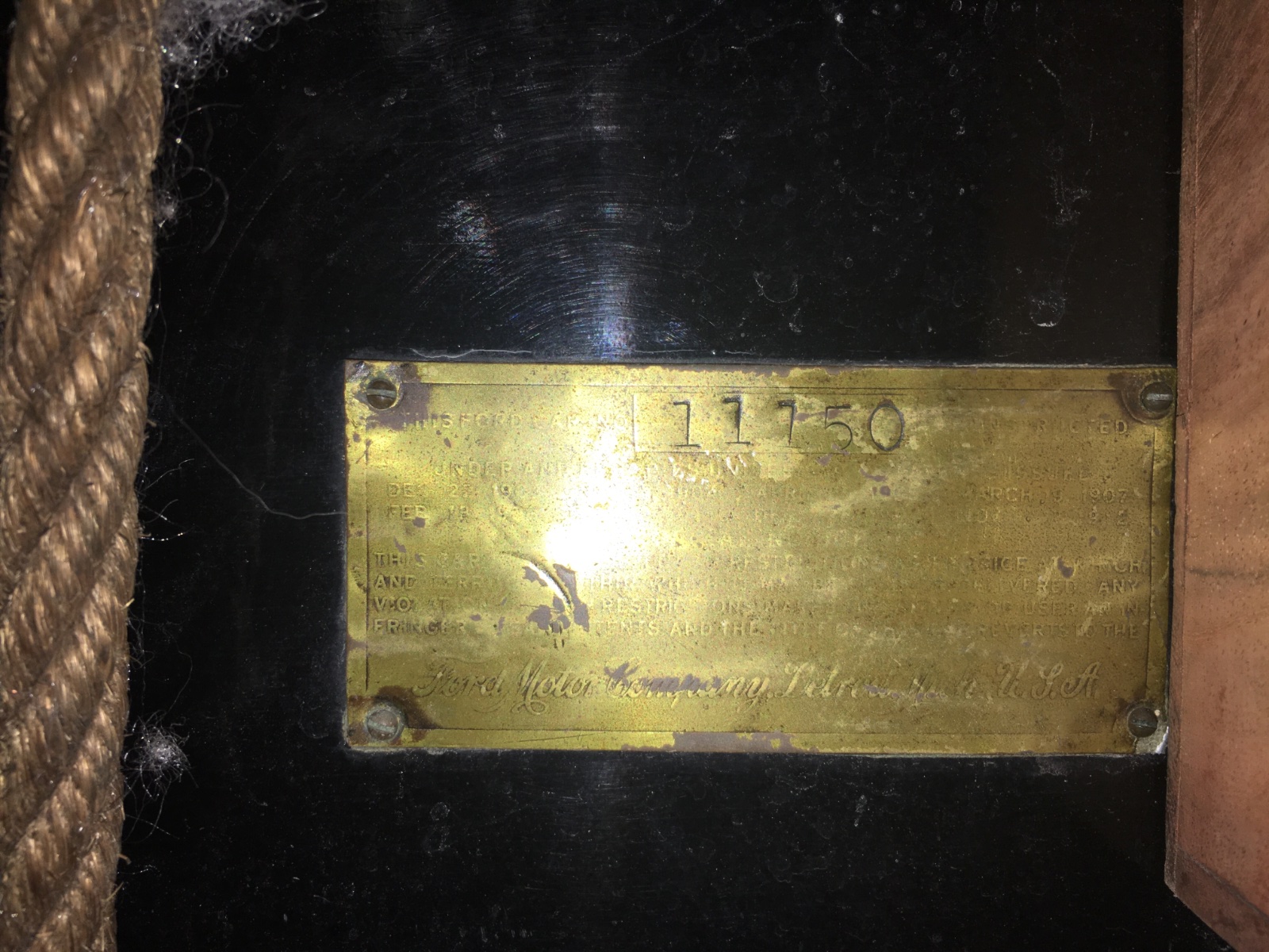

Re: Piquette Ave. numbers
Bill, could you post a picture of the location of the “Ford body number” so I know just where to look on mine.

Tony, I don't have any photos but I think I've misspoke; it's called a patent data plate and it's the metal one that Ford attached to the front of the front seat riser.
TonyB
- Posts: 663
- First Name: Tony
- Last Name: Bowker
- Location: La Mesa, CA
I have that plate but it Is illegible, I’ll look more closely and report back.
This is a photo of the body plate that was on the top of the kick panel
Tony:
That is what happens when someone takes a buffer to a patent plate. What a shame!
Tony, I believe that patent plate is incorrect for your 1909; the early ones (1909-11) were a smaller, vertical rectangular plate with the number stamped at the bottom of the plate. Yours appears to be a pretty old looking 1913-16 patent plate that someone stamped an early number on. Do you know if your body is original to your engine?
I believe the body and engine were original to the chassis. The holes in the body match the holes in the patent plate. However I suspect the vehicle was first restored in the 1950’s as it has a replacement firewall with the manufacturers name and town stamped under the coil box. The manufacturer moved towns in the early 60’s,so I’m fairly confident about the date of the first restoration.
