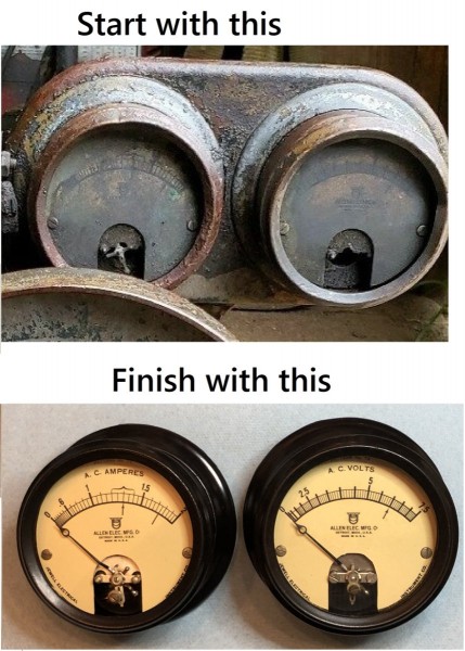

Here are the meters from a HCCT I picked up recently.

The only parts that were salvageable from the original meters were the cases.
I replaced the movements and coils and calibrated them.
The ammeter had to be wound from scratch.

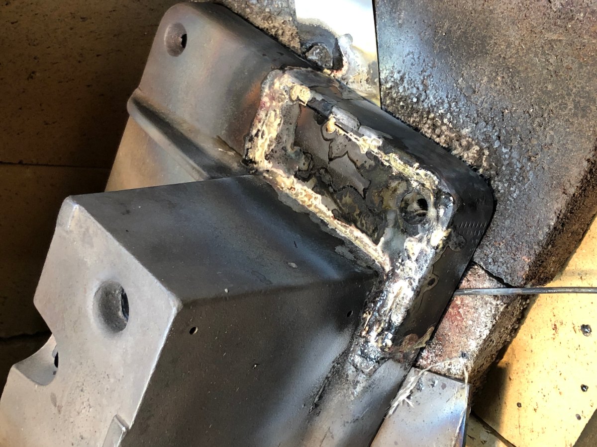

Here is the next part that needed fixing.
eBay-1 Cropped.jpg (65.42 KiB) Viewed 4075 times
I had a friend machine the broken area and make apiece to fit.
It is silver soldered in place.

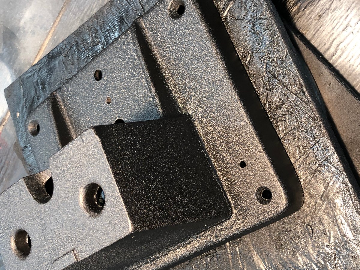

Here is the finished product.
The black wrinkle finish paint masks the repair.

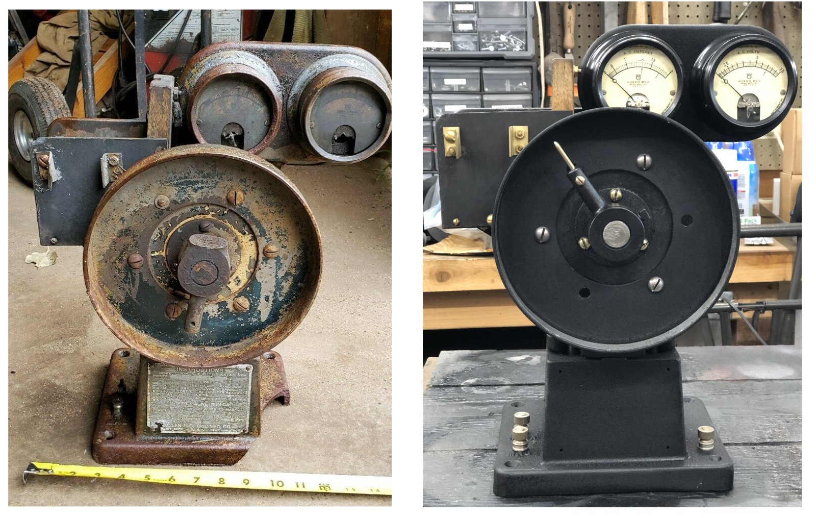

Here is the final outcome.
It still needs a Mag-Ring and a flywheel.
The hand crank was broken so I will make this a motorized unit.
