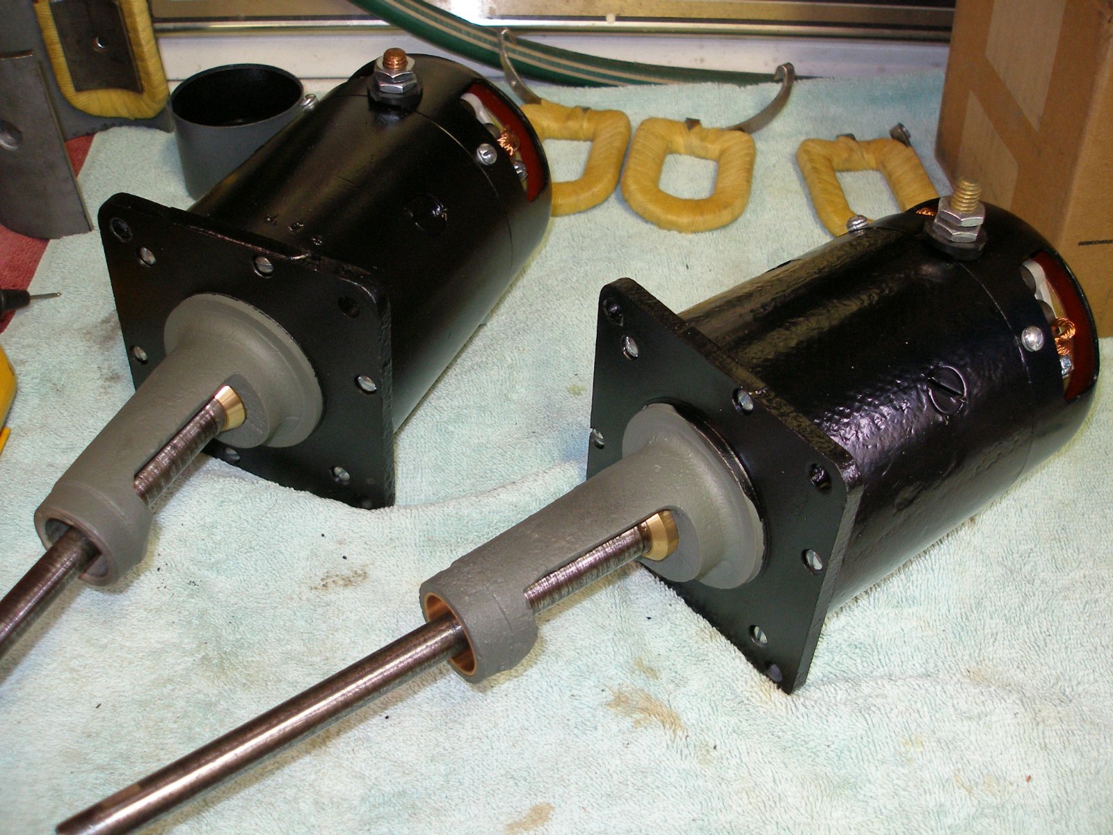

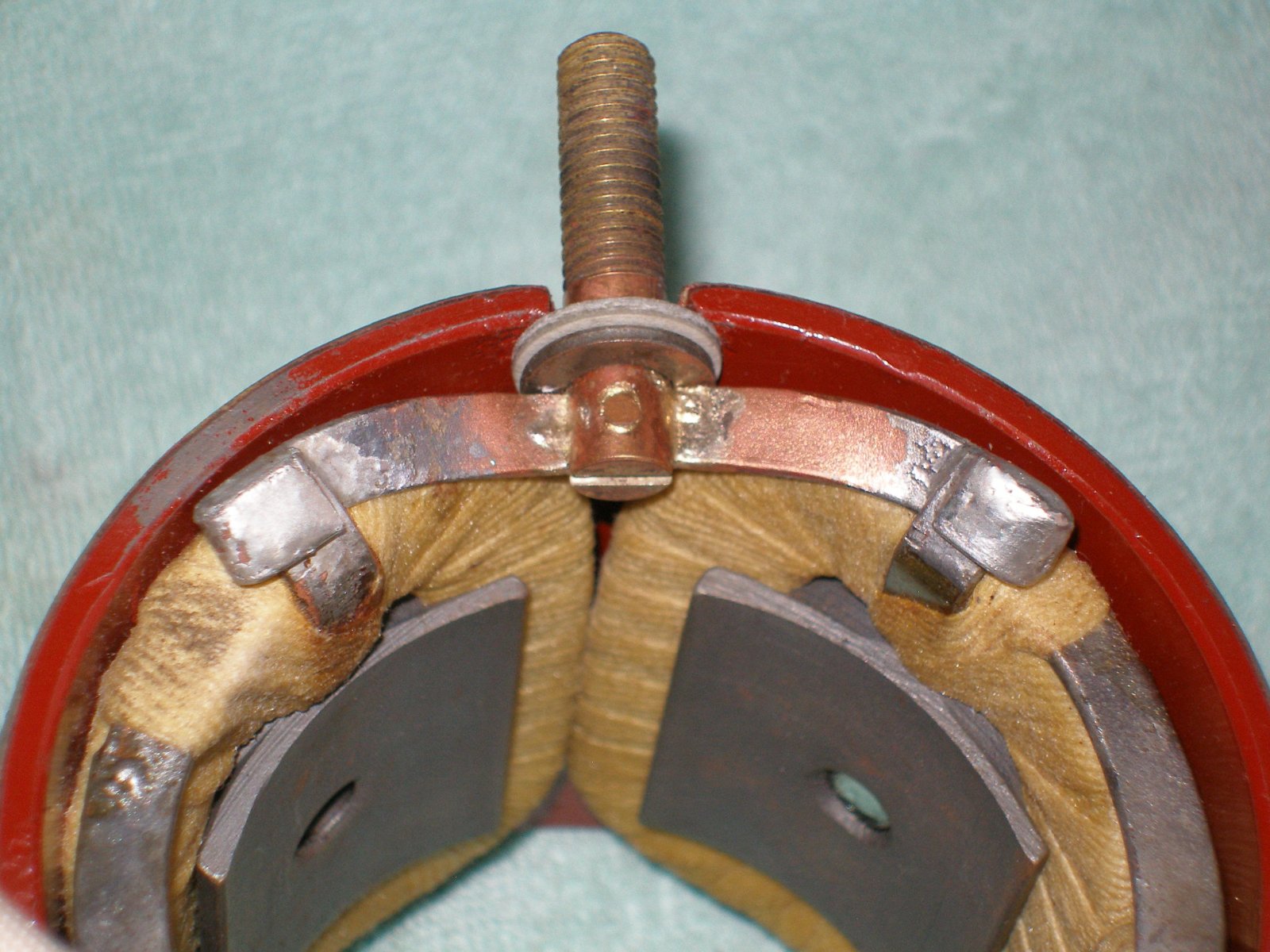

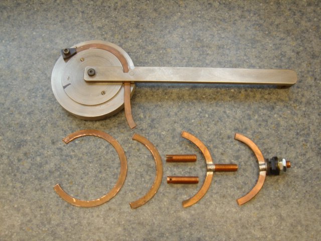

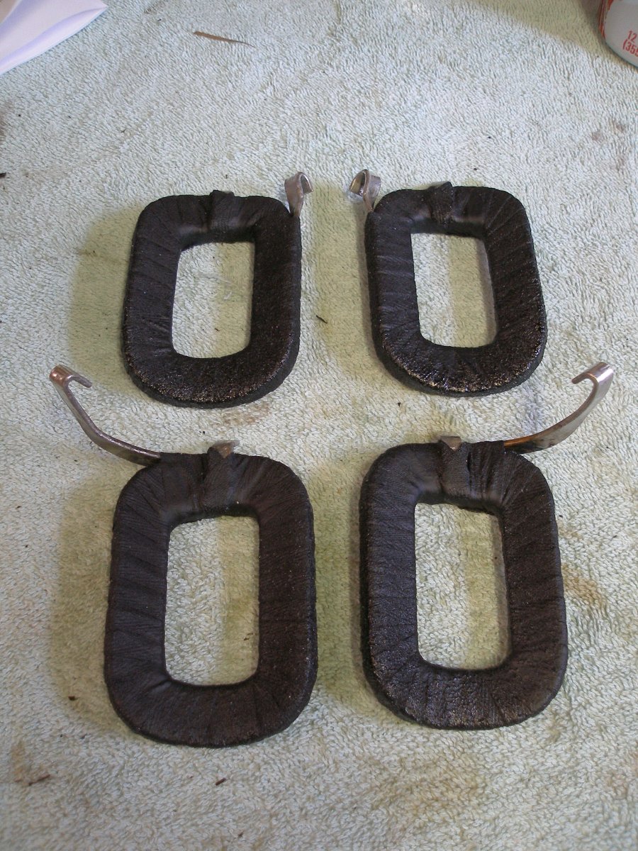

This is not opinion, as I've done many and until you've done one, a person cannot imagine the pitfalls that can await them. Photos below are included only to show I am not spouting guesses or opinion as to the work involved. It is NOT an ad or solicitation for work. From ANYONE. It is quite a job which entails far more than one would suspect. With tools, tooling, machinery, specialty test equipment and knowledge, it's not so bad. I thought for awhile that I'd do these as a service to the hobby, but there are enough people with years of name recognition in the hobby doing this work already, that for me, it just wasn't a good use of my time to be one more competitor driving the price down just to get their beak wet. In any event, no one gets rich doing this stuff and for those worried about spending the $$$, for the money these things presently fetch, the guy you chose to do it is all but giving you a gift...
this is a buss bar in the starter and how it's made: coils reformed and rewrapped: completed buss installation on rewrapped coils: completed job including (among many other things) straightened shaft, straightened casting and new bendix bushing:
