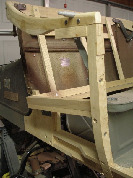

Let’s see some pictures. Is it a wood or steel firewall? And if steel, is it a high or low hood?

I will post some pictures tonight when I get home. It has a low radiator and wooden firewall. The firewall has become somewhat soggy and will be replaced in addition to whatever else is damaged.

My ‘23 roadster needs some minor wood replaced at the passenger door to cowl area; the post and an ‘S’ style top piece. Seems we have to buy an entire kit to get two pieces. We gave up trying to call Fordwood and leaving messages. We’re just going to try and cut/ carve ourselves. Good luck on your re-Wooding project.

There was an article in Vol. 22 #6 (Nov./Dec. 1987) of The Vintage Ford about re-wooding a '23 roadster, with lots of photos. It may be of some help to you. Copies may still be available from the MTFCA.
- Posts: 6743
Re: 23 Roadster needs wood repair: Any suggestions?
RV's article was excellent and helped me out on my '23
anyone doing full or partial wood replacement is welcome to email me privately for photos...I have lots. Here's an example:

R.V. is being really modest...he wrote that article and did the rewooding on his 1923 (a low cowl roadster).
The club allows us to share his article to help promote the hobby as well as to help get a few more T's back on the road. If you would like a free scanned copy, for non-commercial use, drop me an e-mail with "send 1923 Roadster Rewooding" or similar subject and I will send you a copy. Please be sure to include your e-mail address as I don't know of any way to attach a document to a private message. My e-mail address is listed in my profile or you can also send me a Private Message -- but remember to include your e-mail.
If someone knows how I can attach a PDF to a Private Message -- please let me know -- but so far I haven't figured out a way to do that.

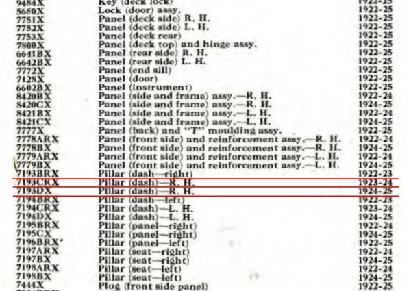

I believe that Classic Wood will sell individual pieces see: https://www.shop.classicwoodproductsllc ... OD_c36.htm . You will need to call them to confirm that. And it may be a case where they once did that but no longer do that? But if you call you can find out for sure one way or the other. Remember we are in the holidays so they may not get back to you until after the holidays. And if you provide them with some photos and a sketch with dimensions, one of their existing parts may fit.
Note on the Classic Wood web site they list a wood kit for a 1923-1925 roadster. I believe that can be a little misleading. The low cowl cars ended production in calendar year 1923 and are considered by many folks including original Ford literature to be a 1923 car. But the high cowl roadster and tourings were introduced around Aug 1923 and they are unfortunately are considered by some to be a 1923 car also [and many that were sold before 1924 were registered as 1923s when sold new]-- but Ford USA usually referred to them as 1924 models when it came to body parts. ( Ref: https://www.mtfca.com/encyclo/1923.htm )
I look foward to learning more about this. And I would encourage folks to also look at the 1925 Price List of Body Parts at: http://www.cimorelli.com/mtdl/1925/1925 ... istapr.pdf and note that there is not a really nice "this is a 1923 and that is a 1924." Some parts fit different years. Below is taken from a Roadster page. I drew the three red lines under the same part that changed enough to be listed with a different suffix for the same part. Note the overlap also in that each part overlapped with the follow on part. And they span 1922 to 1925.

Hap, the reason for the two different pillars on your list is the 23 roadsters have a wooden pillar where the door attaches whereas the 24-25, I believe, have a steel pillar there.
Stephen

In addition to R V's wonderful article, I would recommend anyone considering a re-wood project, reading a current thread on Don Booth's center-door restoration. He is not near done yet, but there are some good tips on how re-wooding should be done.
Link to page two, where the wood work begins;
viewtopic.php?f=2&t=7824&start=100
Kathy T, (et al), One of the good points is that it is a good idea to rough in a piece of cheap wood. Using scraps of pine or whatever is laying around, hack it a bit, oops, glue or tack a bit on, shims or wedges as needed. Once you get it to fit, and shaped basically how you want it? THEN use it as a pattern to copy for cutting out of your proper good wood. If most of your wood is good to use, and you need just a few pieces? This is the way to do it!

The 24-25 tourings have a steel pillar on the RH side. I bought one from someone on the forum 10 years ago and wound up not using it, and just opted for wood when I rewooded my car.
