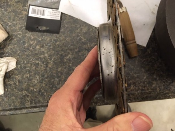

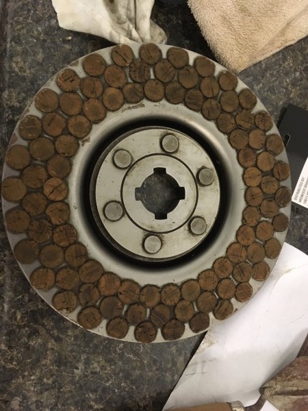

Does it look something like this?
I sent you a PM

Certainly it resembles your picture!!

How thick is the steel plate?
How much do the corks project each side?

I don't remember if I measured them or not.
And this disc is not available now. I'll see what I can find out tomorrow.

The dimensions appear to be what I expected. Looks like about 12-14 gauge steel and the cork projects a good 1/16” or a little more. So a total thickness of 1/4-5/16” for the finished disc.

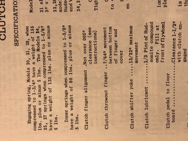

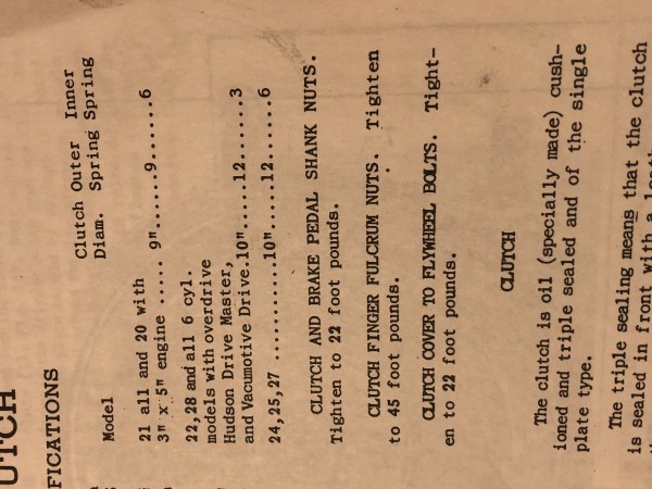

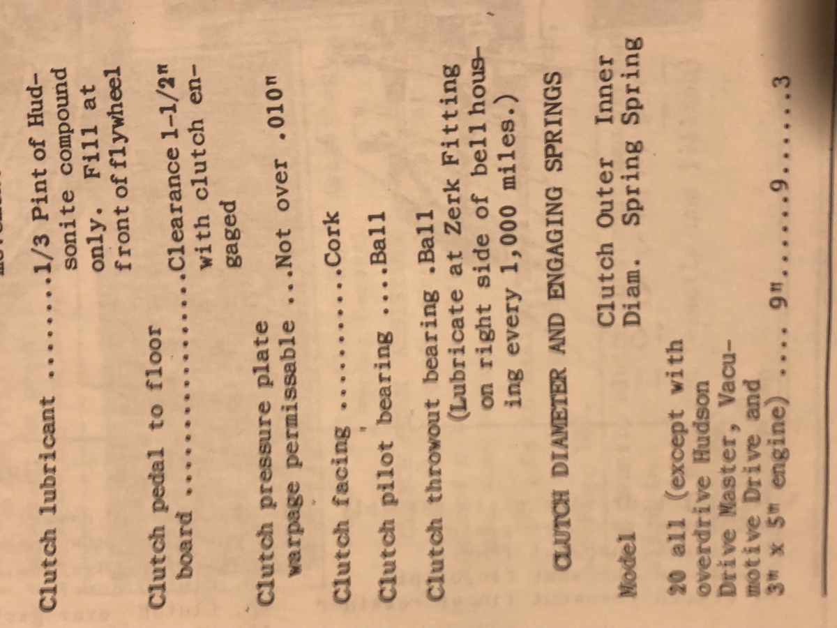

Here are the only specs it the shop manual. It seems like i found more online somewhere back then.

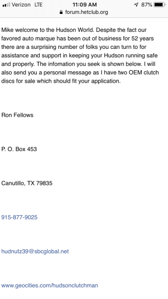

This is who I talked to, Ron Fellows, just outside of El Paso. This is from the 2008 forum so I’m not sure if the phone number is the same and I believe he told me he was moving. It seems like he told me about the process. I remember something about inserting the corks and facing them down on a lathe. I’ve never spoken to Doug Wildrick, only have seen his name on the Hudson sites.
