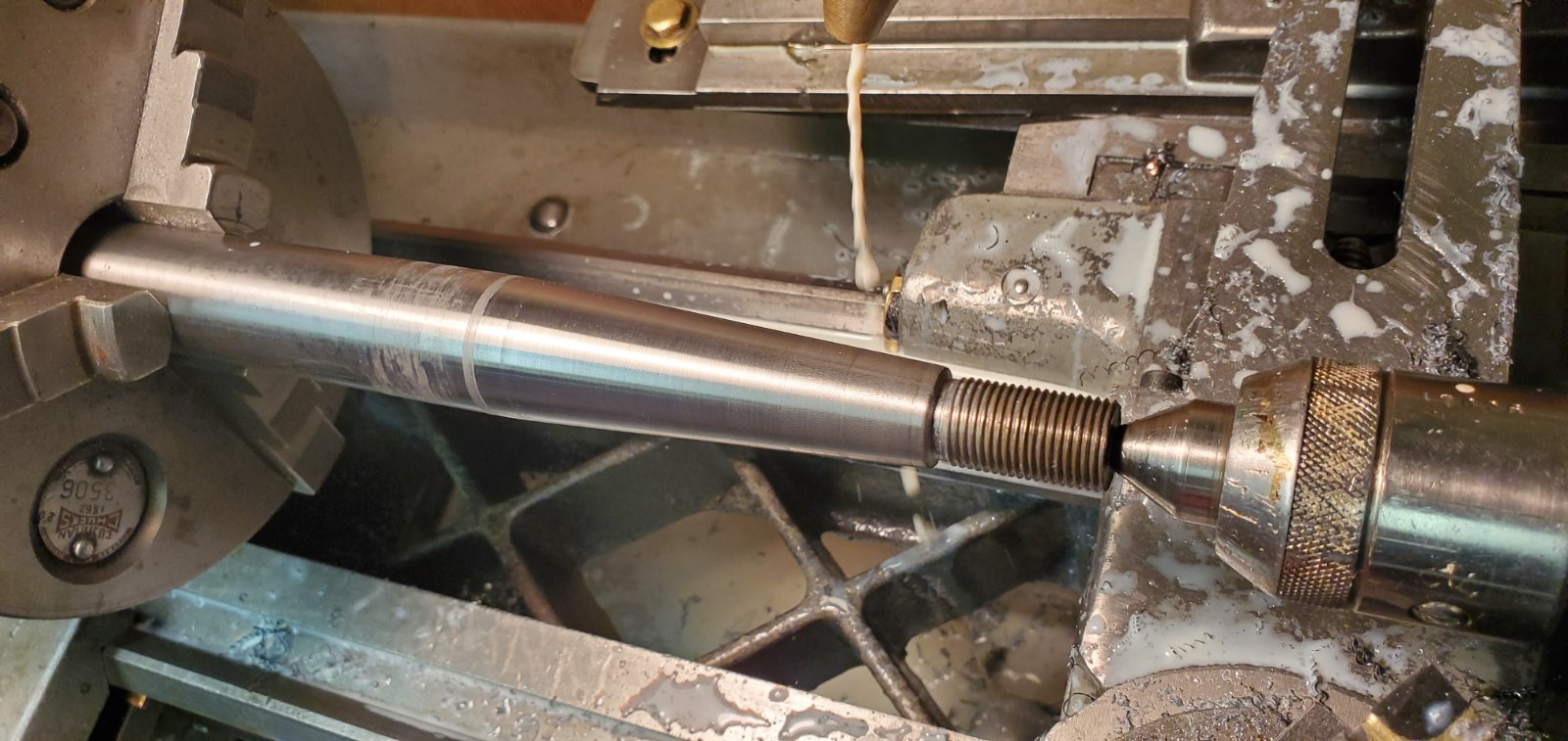

They are not available from the vendors any more due to demand.
We (mainly Glen) did the work on a South Bend 10" lathe. Have the thread, taper and keyway done.
Notice taper attachment behind lathe bed.

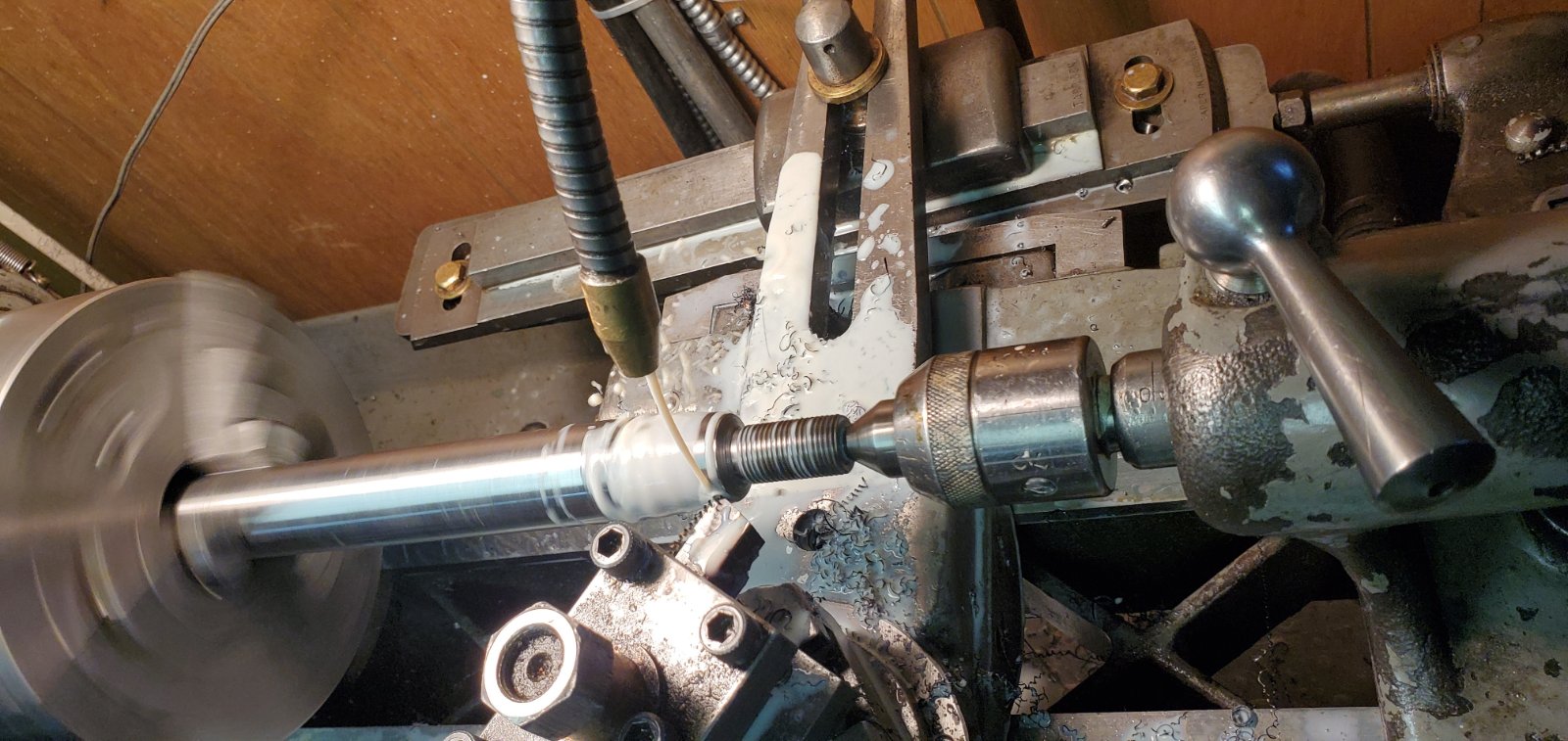

Better picture of the taper attachment.
