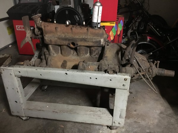

first post here. I've wanted a T since working on them in college, finally decided to start shopping at Thanksgiving time. While I've been looking for that *just right* car, I picked up a December '25 engine on a stand, to mess with. I'm hoping to collect the stuff, and have it running, or close to it, in the next couple weeks.
I'm going to give image posting a try here, so bear with me

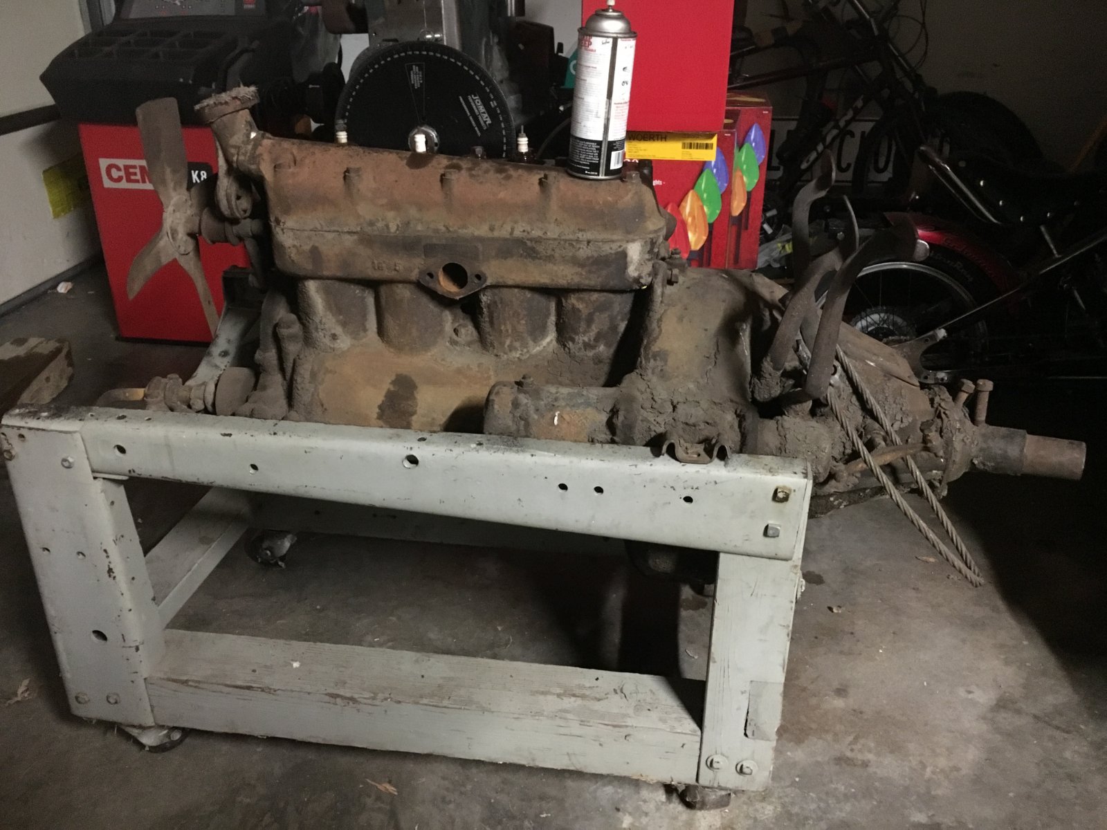

I'll repost your photo as I'm not sure if it will show up 2 years from now with the URL way you added it. It might, I just don't know. And you can click on the photo below and it will be much larger.
I like your engine stand - it looks very solid. I could not read the serial number on the engine but a Dec 1925 engine would be a 1926 model year engine. And it appears your engine has the bolts to hold the transmission cover to the rear of the engine block. If there are not any holes on the block for the bolts to screw into then the block is likely to be earlier than Dec 1925. It also has the wider low pedal and brake pedal that were introduced with the 1926 model year USA cars.
Note the cylinder head also has the 1926 - 1927 style water outlet that would have held the fan on a 1926-27 engine. But it is incomplete and the fan is missing. It appears that your engine has the earlier 1917-1925 fan arm and an early 1917-20ish fan and fan hub pulley.

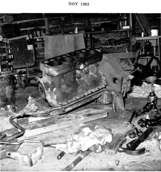

How that reminds me of my first Model T engine. It was happily covered in rust and solid grease like your picture. 57 years later it's still the best hobby I know. I hope you enjoy it as much as most of us do.

Yeah, you came to the right place. Welcome to the Forum. A lot of us have tons of parts so you should find a Model T Club close to your home to join. The parts you’re missing on that engine are easily available. I have 8-9 of the later ‘26-‘27 fan/water outlets and several later rear ends w/ torque tubes. Most others will too. What year and body style are you looking for?

I believe this to be a 26 model year engine and trans, because of the extra mount bolts, 4 dip pan, pedals, etc. I didn’t know about the earlier fan stuff, so...thanks !
I’ve pulled the drain plug and the inspection cover from the bottom. Looks great up in there, so i’ll probably just try to wipe the gunk out and reassemble with new gaskets.
The carb is a fail. I can’t get the main jet out. I’ll be on the hunt for one now.

Don't give up on that carburetor yet. Heat that jet up a bit and quench it. It will probably screw right out.
