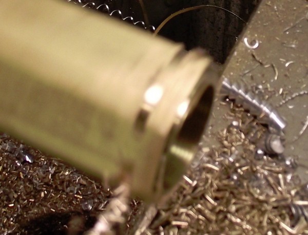

So today I'm finishing up an H-1 carb for a customer in Australia.  I had a couple nuts off of the carb I'm rebuilding and one I'd saved off some project but decided they looked too scummy for a nice restoration so had a few minutes before a Dr Appt. and thought I should make a small supply for the several H-1's I have coming up.

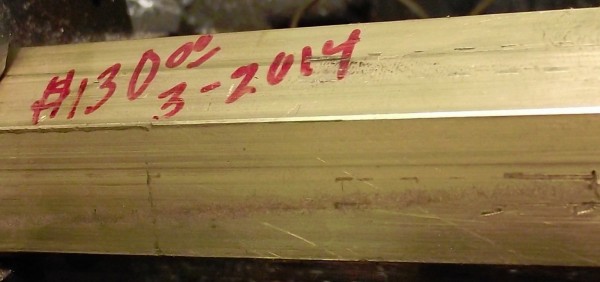

First is the $130 stick of 1 1/4 Brass Hex stock, I use spec 260 because it machines so nice.  Spec 360 is hard to find in brass and more expensive.

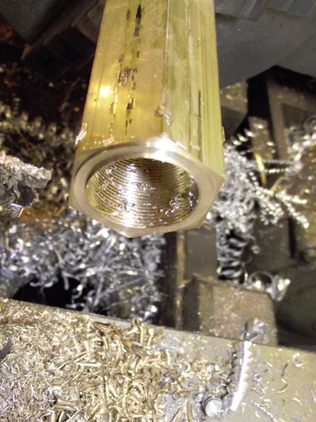

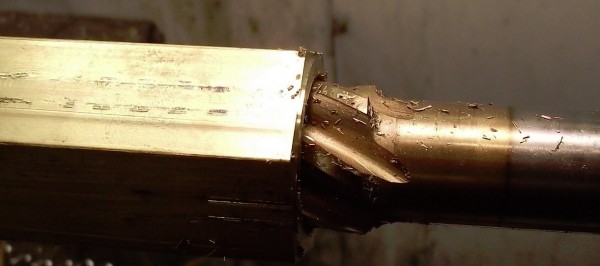

Drill a hole, then run the new $125 ball end tin coated reamer through to get the correct minor diameter.  I do this on my 13 x 40 Engine lathe.

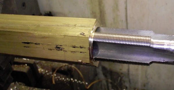

Then thread them to 1-24 with the special thread $112 tap.
Threaded.
Then relieve the mating side and part them off in the proper thickness.

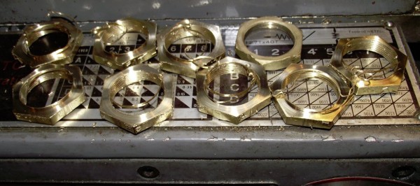

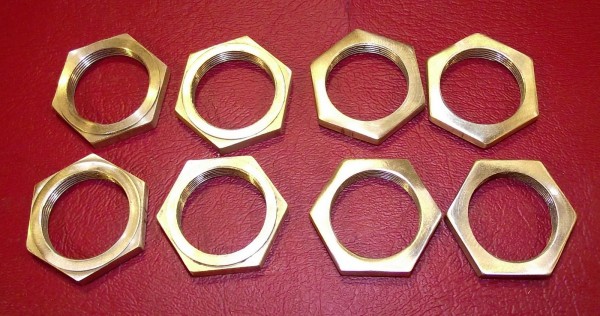

Stack em up on the side of the lathe for now.
Clean the up on a flap sander and polish them a little. Eight ready to go.
No, I'm not selling them, just showing how little equipment and tooling it takes to do this and how easy it is! =) ----- (Note that I have my safety glasses on)

Smallest I have I think is 3/16's, every size from there up except 1/18. It has really gotten expensive, this stick of 36 inch 1 1/4 was $130 in 2014, I think it's about $175 now.
