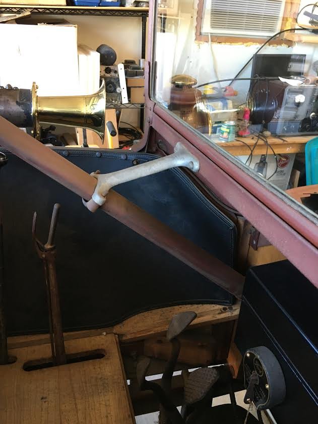

Here is a picture of the bracket in my 15 Runabout

Re: Installing a steering column support bracket on a 1915 firewall?
Post by NealW » Sat Jan 11, 2020 1:58 pm
JEC wrote:
Sat Jan 11, 2020 1:21 pm
Thanks John. That looks more stable than mounting it to the firewall. I guess I'd just need to build up the nerve to drill a hole in my cross piece!
Neal

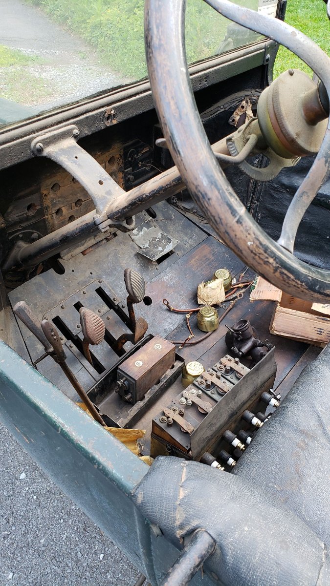

Post by Retro54 » Sat Jan 11, 2020 6:57 pm
Here is mine... 1915 Beaudette touring body.
Mounted in the same location.
