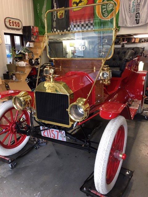

I finished my 1911 Touring restauration but I do not have the Top when I bought the car. I'm ready to go ahead with the top but I would like to know what is the dimension? I found that dimension bellow on MTFCA forum. I have the bows and I bought the top wood Bows laminated at Lang's but I would like to know how deep I shape the end of these bows to fit in the metal bows?
Any suggestion place for the top ? I heard classtique Upholstery do great job. I'm leaving in East part of the country near to the border and close to Plattsberg City in New York State.
Thank you in advance for the help.

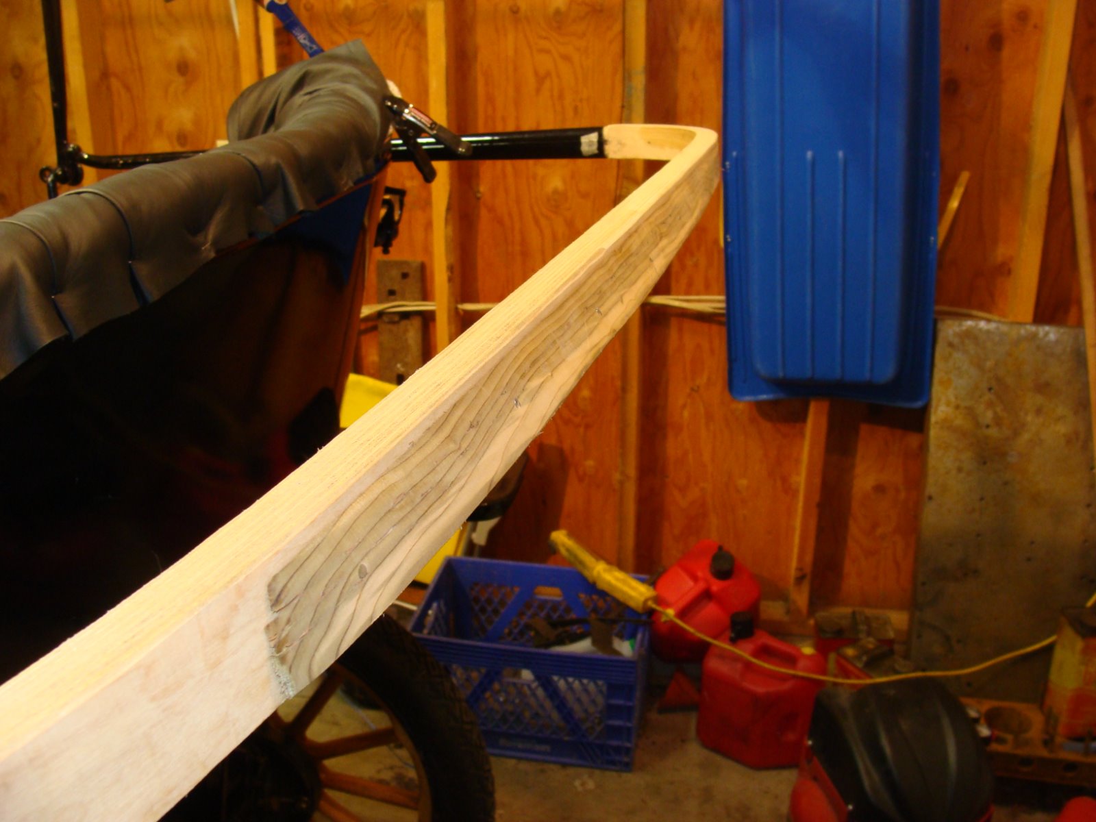

I shaped the bows to fit into the sockets using a draw knife. It is a trial and error fitting process.
Here are some pictures of the wedge on the 4th bow when I did my top:
I have some other notes I will e-mail to you.
-Keith
