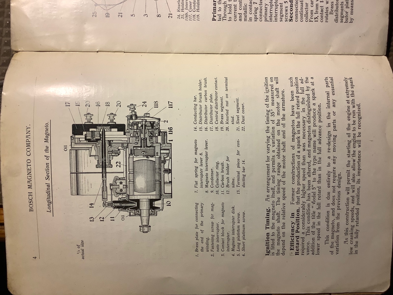

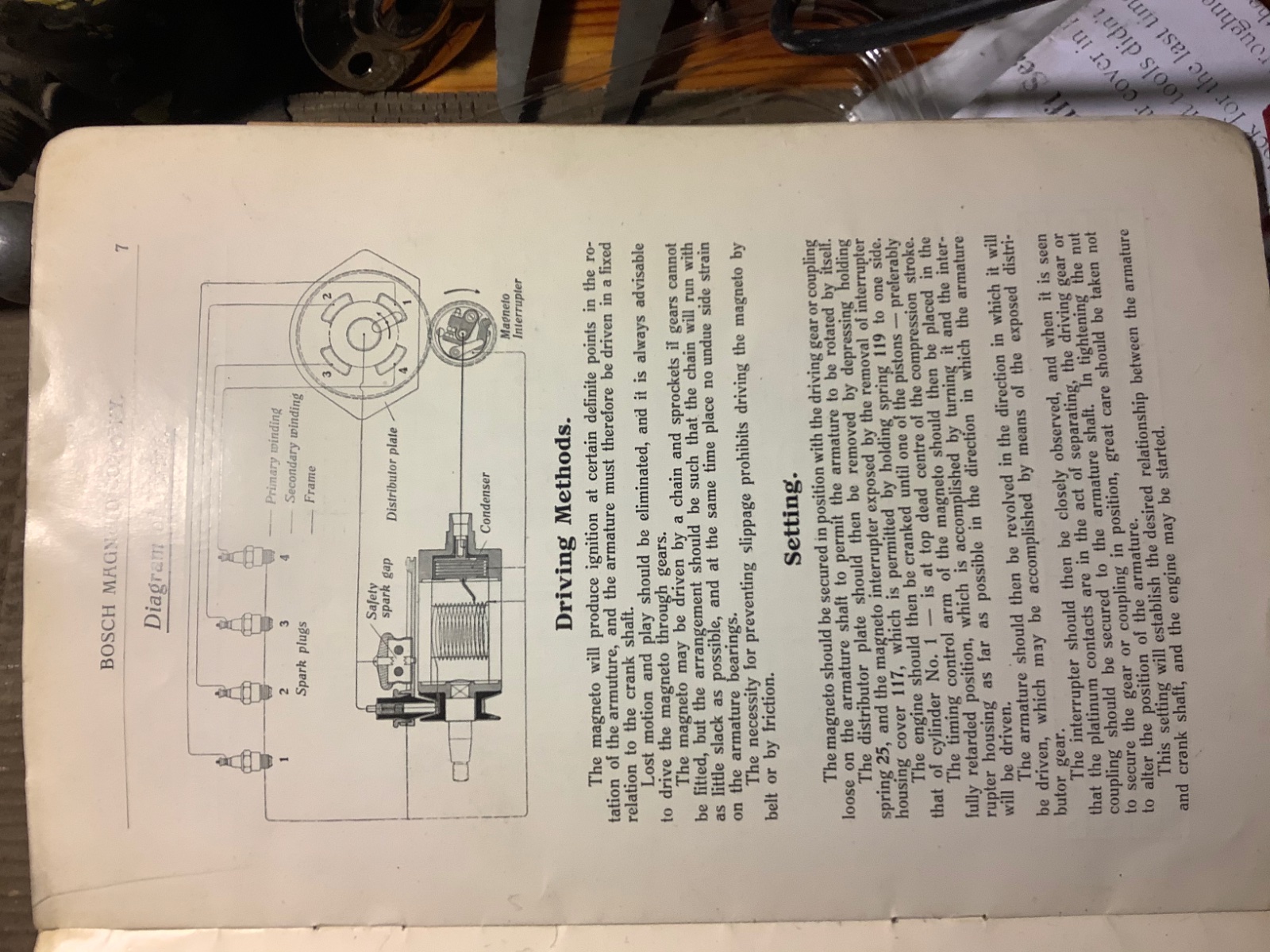

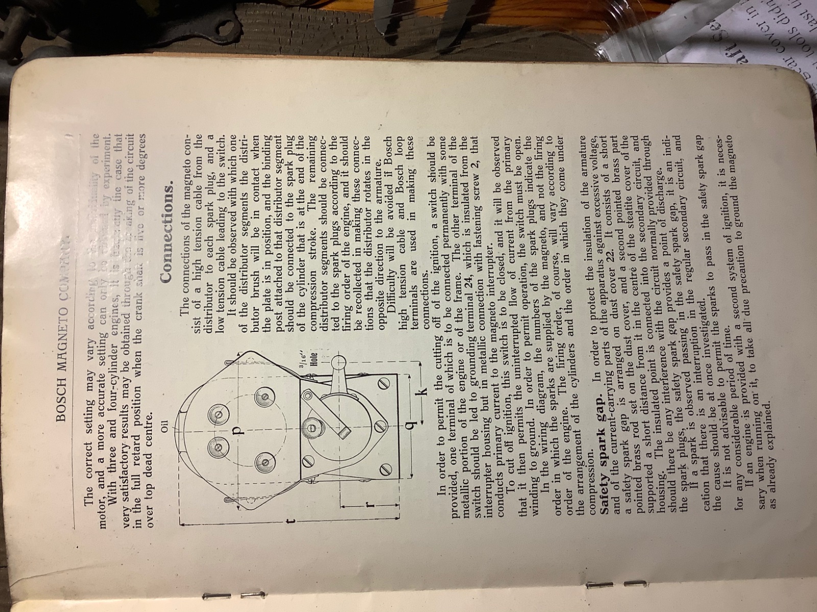

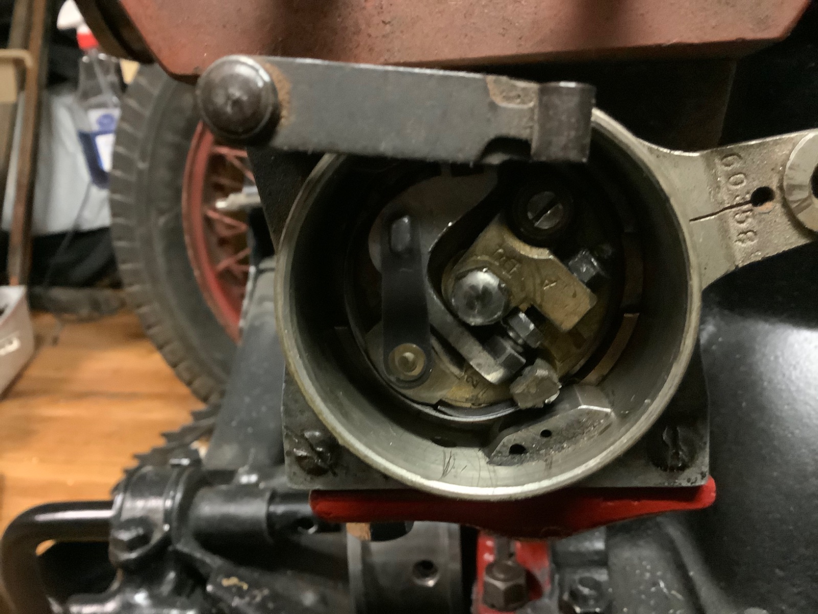

Bob, hope this helps. This is what the points set (Bosch) should look like for a crossdrive front magneto plate. I’d have to dig into it as to what it’s called, clockwise or anti-clockwise. The side drive ,that mounts on a shelf and attached where the generator would go uses the same rotation. The 3 gear side drive (splitdorf) uses the opposite rotation as shown.

Post by Dropacent » Tue Jan 14, 2020 11:27 pm

Book Columbo cross drive
Post by Dropacent » Tue Jan 14, 2020 11:30 pm

Getting my head wrapped around it again, it’s called a clockwise rotation. It’s important to remember this. The Bosch DU4 mag will revolve either way, but you need to have the correct interrupter plate ( points plate ) in place. The rest can easily be changed by moving the gears to time.
