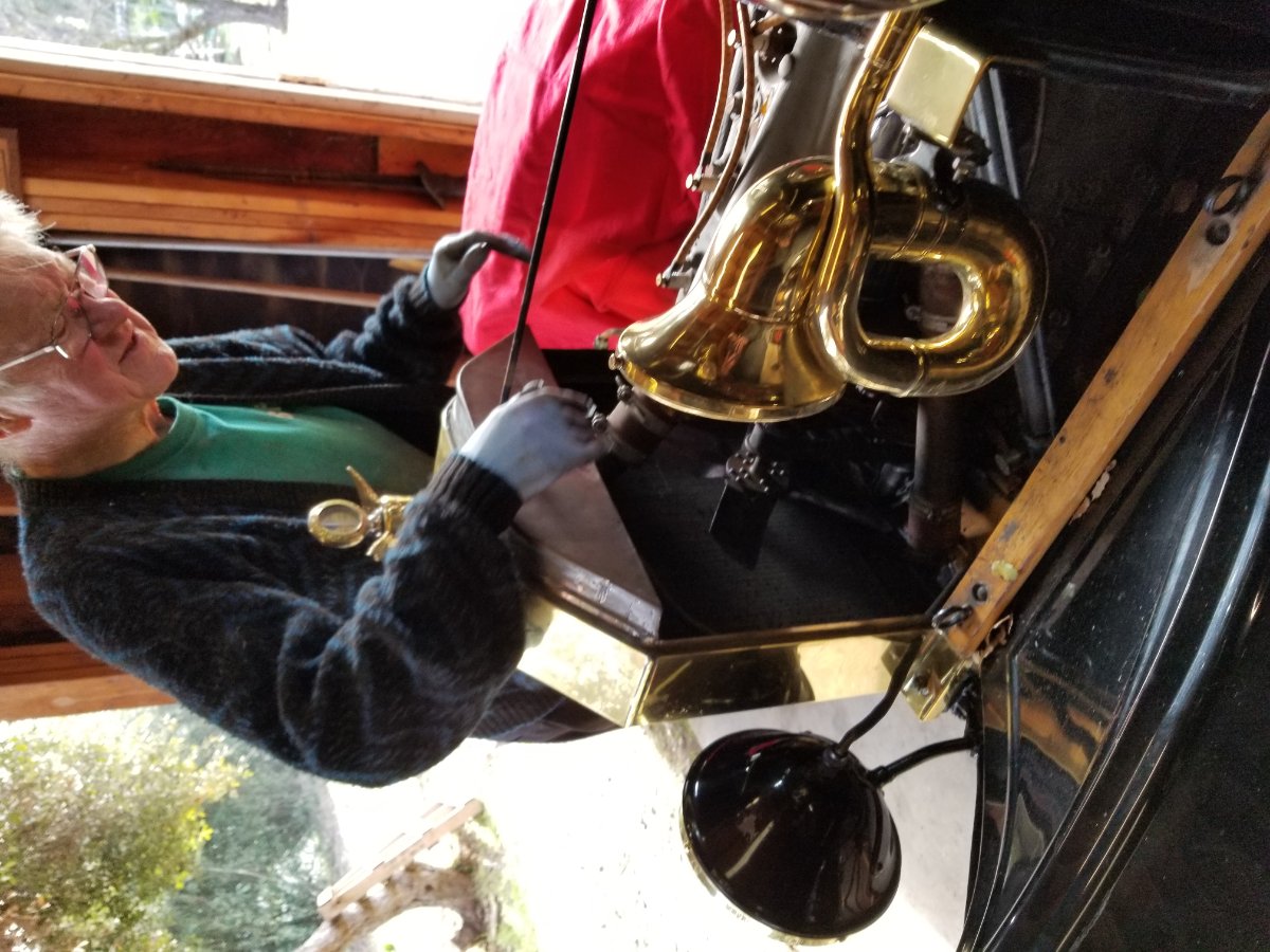

TonyB
- Posts: 663
- First Name: Tony
- Last Name: Bowker
- Location: La Mesa, CA
Re: Why won't my 1915 engine start unless I tow (bump-start) the car.
I looked it over and decided the following.
1. The plugs were dry and sooty even on full choke
2. Lots of suck at carb inlet
3. Timing Is rather restarted. The lever is at nine o’clock at top dead center. I’ve seen this previously when switching from roller timers to the carbon brush version.
4. We pulled the NH carb apart and all looks good, the needle could do with sharpening but the shut off needle looks fine and the float is a fraction less than 1/4” from the top.
5. We did a compression check. It’s hard with only a hand crank but it appeared to be 25-35 pounds.
