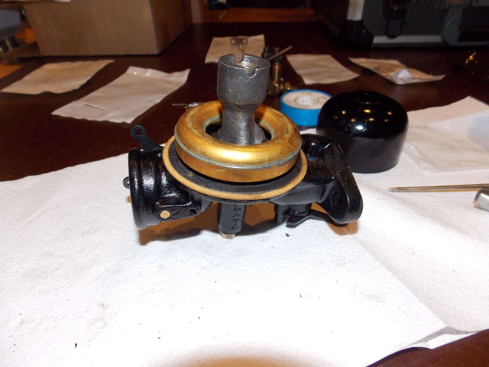

here is the way I do it:
Good luck
Andre
