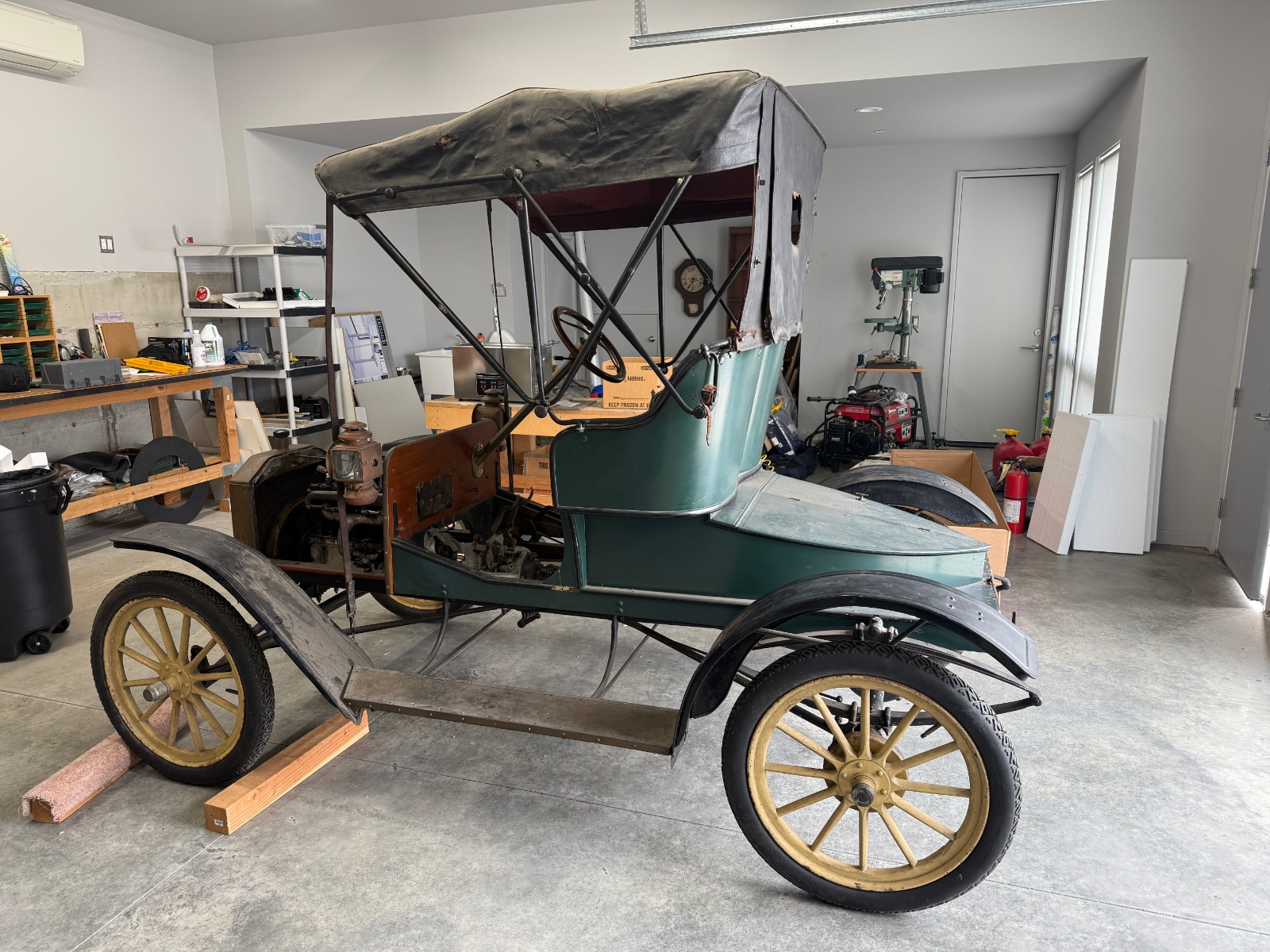

Hello all,
After restoring several model t and a fords is started a new challenge with this early project ford. See picture.
Best regards Gerard from the Netherlands

I allready became member and found a lot of grear usable information at the website. Car is 95% complete some small parts are missing the crank to start the car and the axle that drives the oiler.

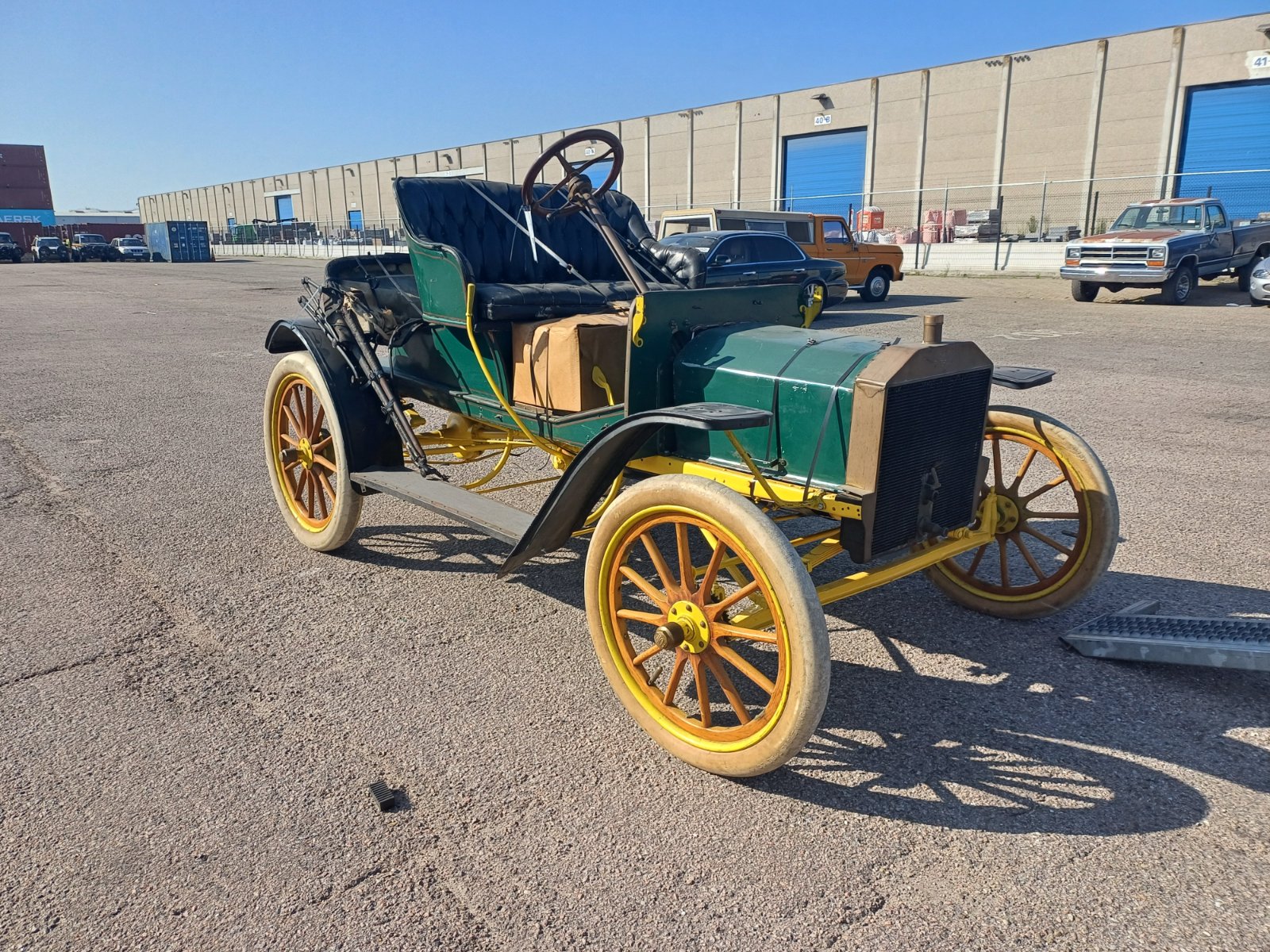

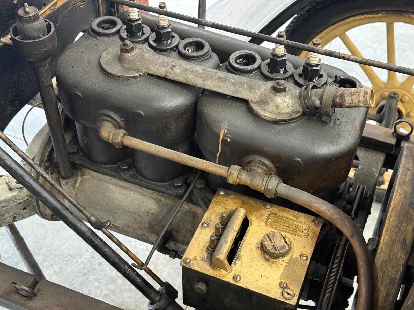

I have started restoration of a 1908 Model S which seems to be in similar condition to your car, with half of the oiler shaft missing and half rusted in the radiator. No rust or wood rot. Engine #1454.
I will be visiting Amsterdam in September. It would be nice to meet. Please send contact info.

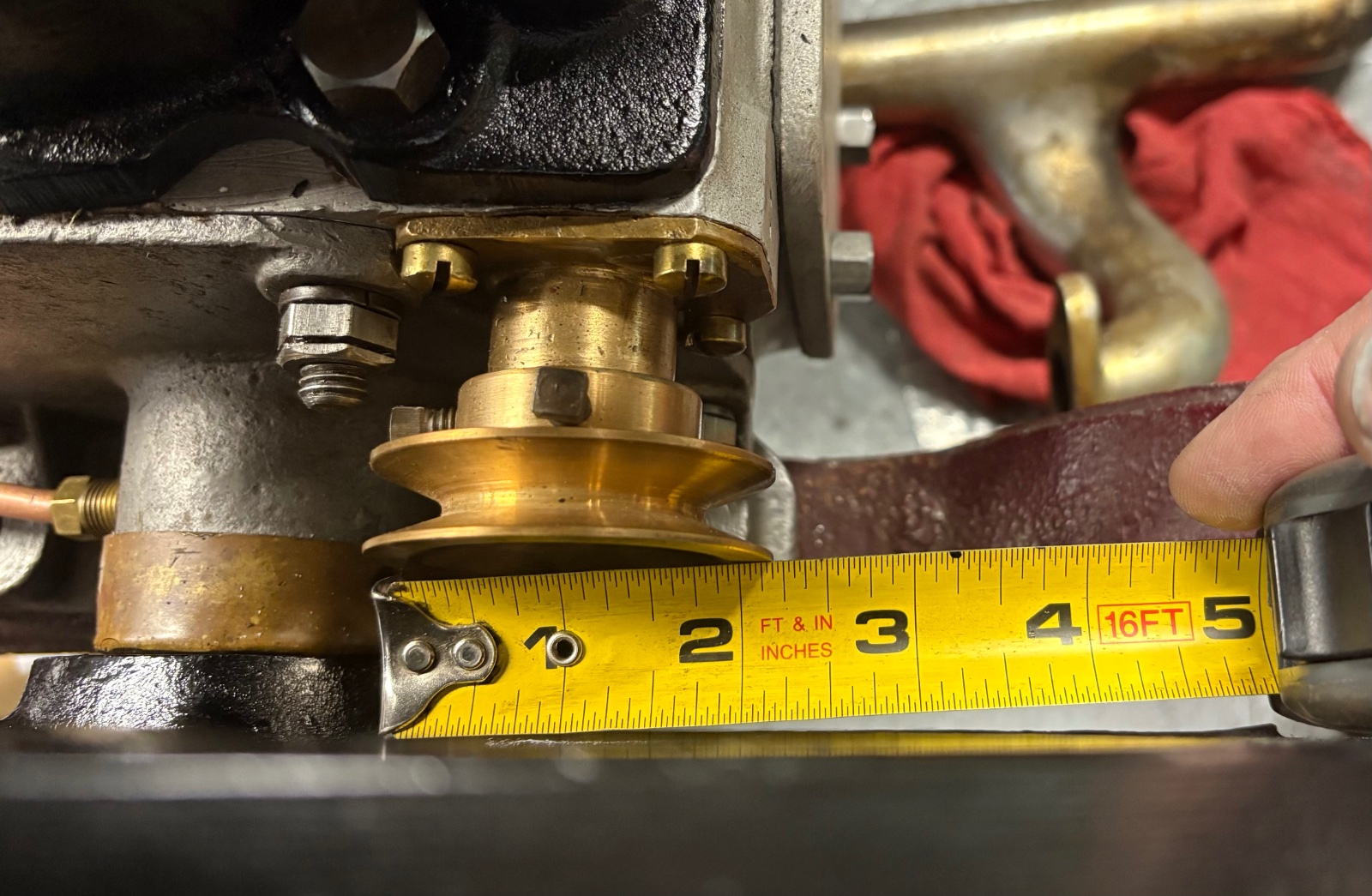

First question from my side at this moment.of someone could measure the diameter of the pulleys of the oiler and the one at the engine side
Thanks for the reply I think we have more or less the same car, serial number are also close together. You are always welcome. I send you an email.

It just so happens that I have the McCord Oiler for my 1908 Model S Roadster on a bench at the moment so I took a picture of the pulley with a tape measure next to it.

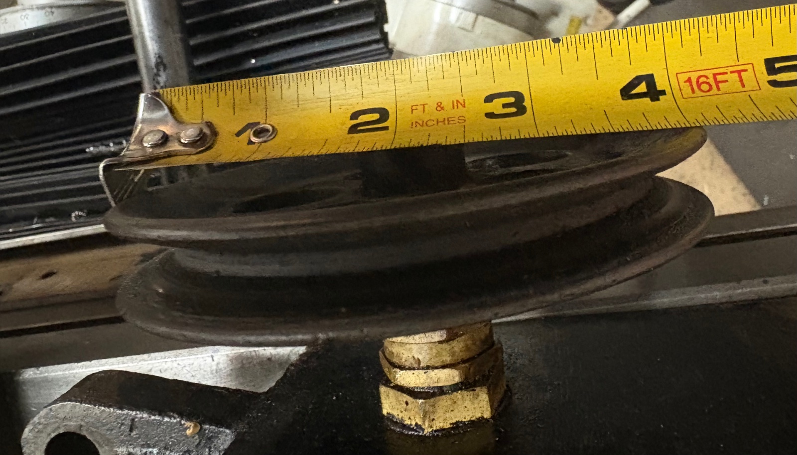

The S Roadster’s engine is on another bench nearby, so here is a picture of the drive pulley.
Hope these are useful,
Trent Boggess

Thanks a lot for the pictures, this helps a lot. Does someone has the small gear in the oiler for sale? Or eventually a complete mc cord oiler
