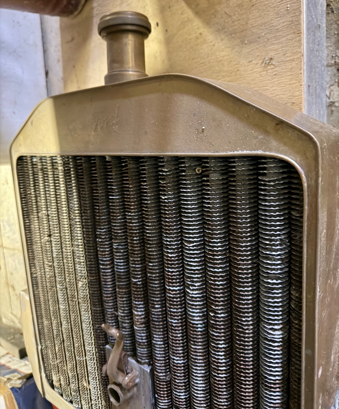

Below is a photo that my notes say Trent took of a very early Model N radiator that was hanging on a garage wall. It may very well be one from an N in the photo above. (OK that is a real longshot…) Note it also has the seam at the top tank.
And below is a photo of what I believe is a 1907 Model R Runabout. It also has the seam at the top of the tank. And I believe that is a typical Rome Turney radiator with the larger round tubes with individual crinkled washers around the tubes. Note the larger filler neck. My Dad's Model S Runabout has that style radiator and it also has the seam on the top tank.

Hap,
I believe the the Rome radiator you show is the style with a removable shell. Meaning, what appeasrs to be the upper tank is really just the shell, with the tank beneath. One of the spare parts donated by to the EFR by Oswald, was such a shell.

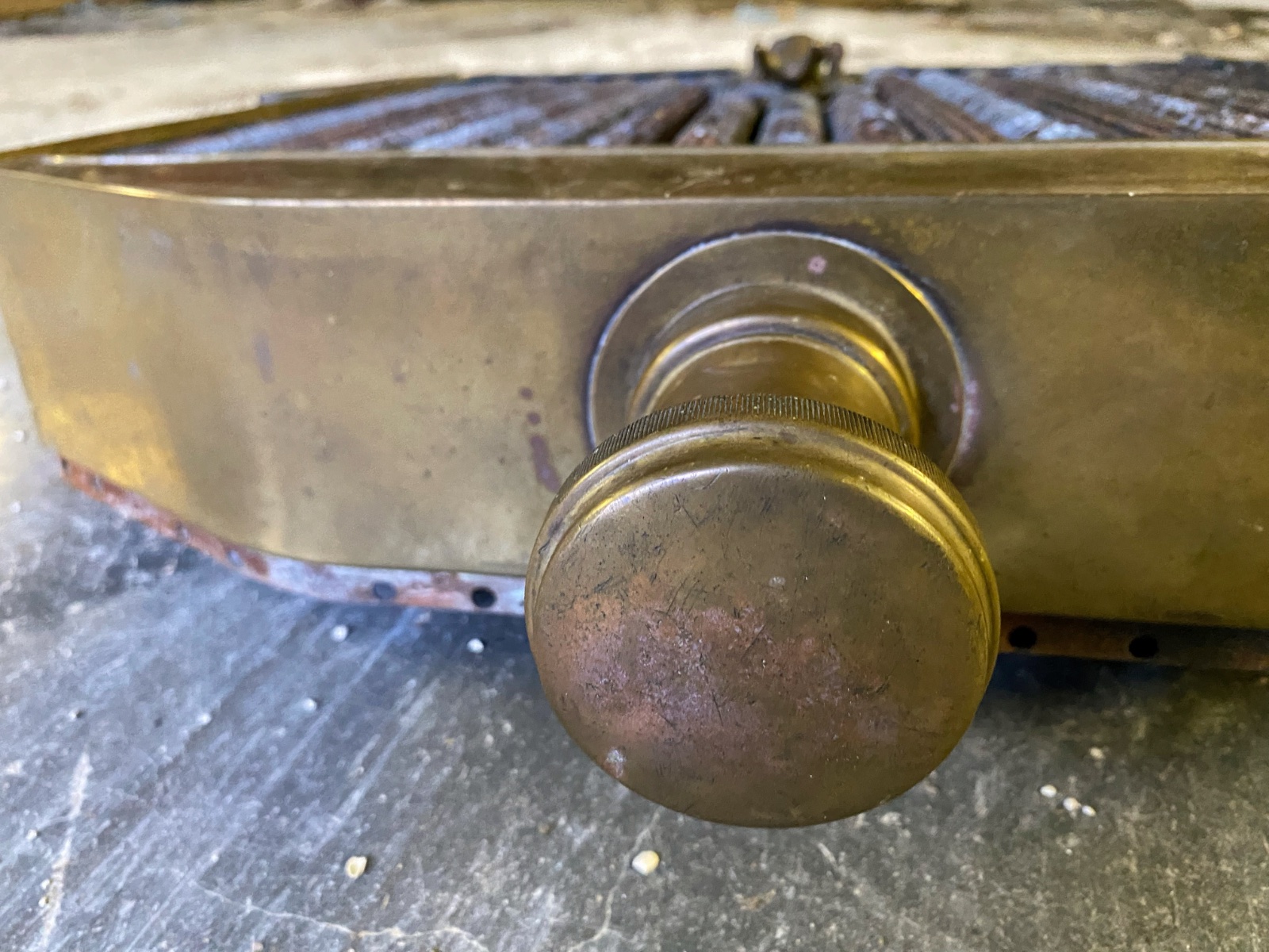

Here are several photos of an early Model N radiator sent to me by a friend.
There are several distinctive features of early Model N radiators that distinguish them from radiators used later in NRS production. First, the core of the radiator appears to be of the honeycomb or cellular design similar to the photograph of the chassis being assembled at Piquette in the 1906 photo. Most period photos of NRS cars show radiators of the more conventional tube and fin design. Second, the radiator neck and cap are very distinctive. I have heard this design referred to as the “light bulb thread” radiator cap because of the size and design of the caps threads. The Ford script that appears on the top radiator tank is smaller and is stamped into the tank at an angle. The winged Ford script was used on later NRS radiators. It was larger and stamped horizontally into the top tank. Also, the tank on the early radiator similar to the design used during Model T production, while later NRS top tanks were a one-piece stamping.
All NRS radiators were made by outside suppliers. At the beginning of 1907 (according to Canadian duty documents) radiators were supplied by Whitlock Coil Pipe Company, (Hartford CT) and McCord & Company (Chicago, IL). Ford did not begin producing their own radiators until 1912.

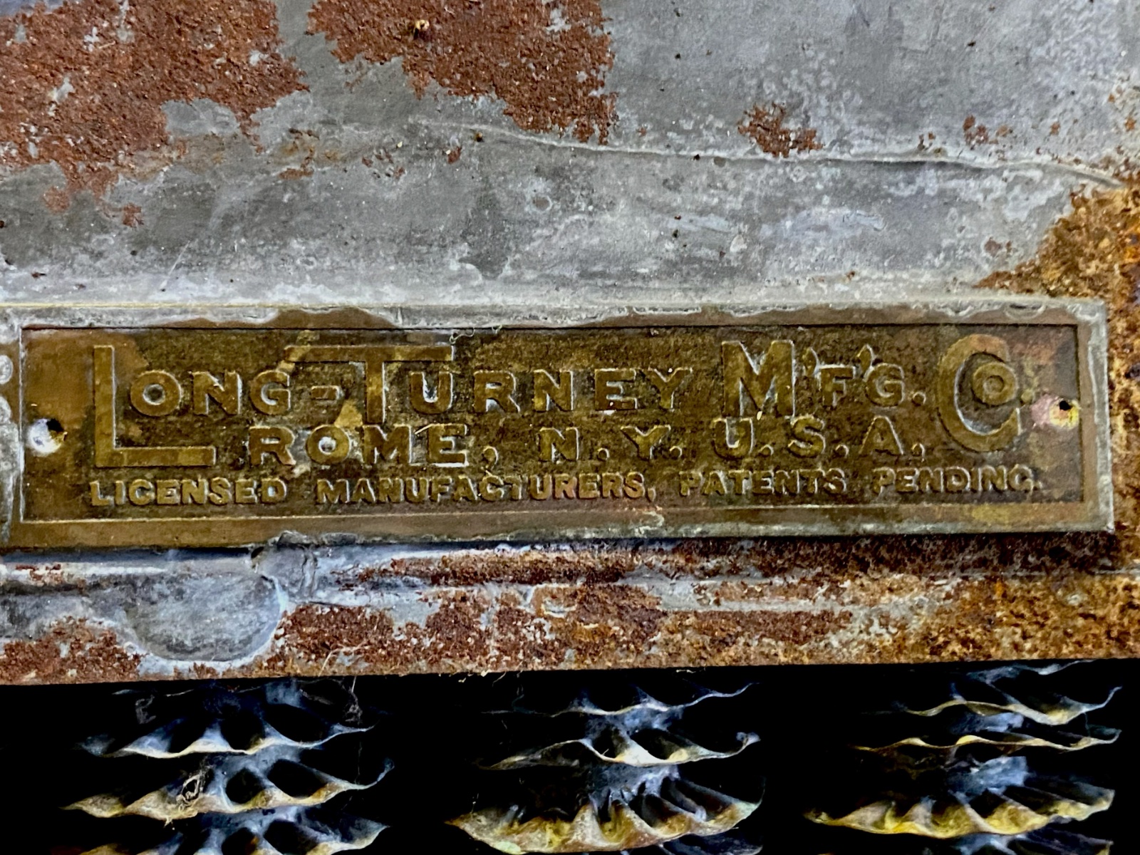

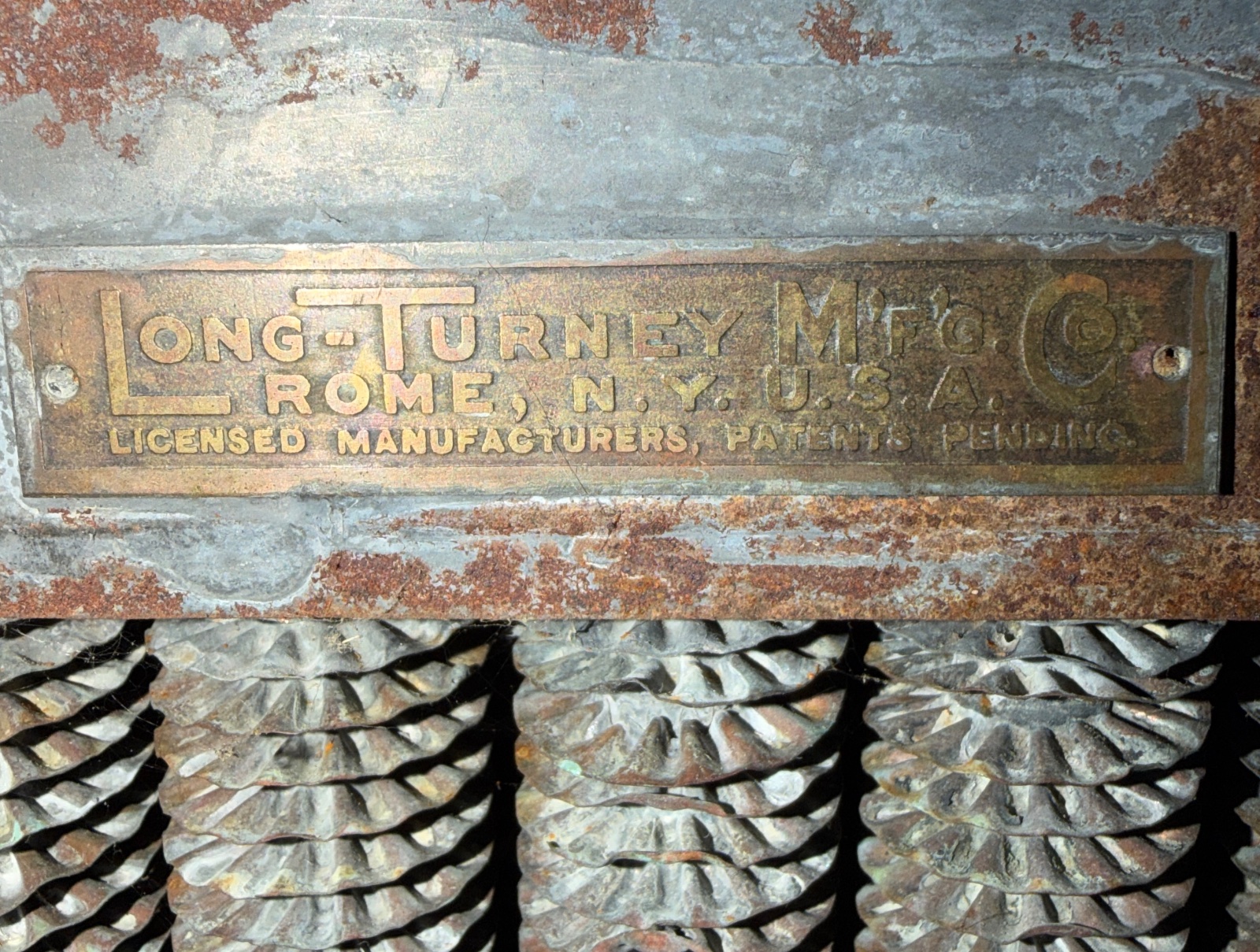

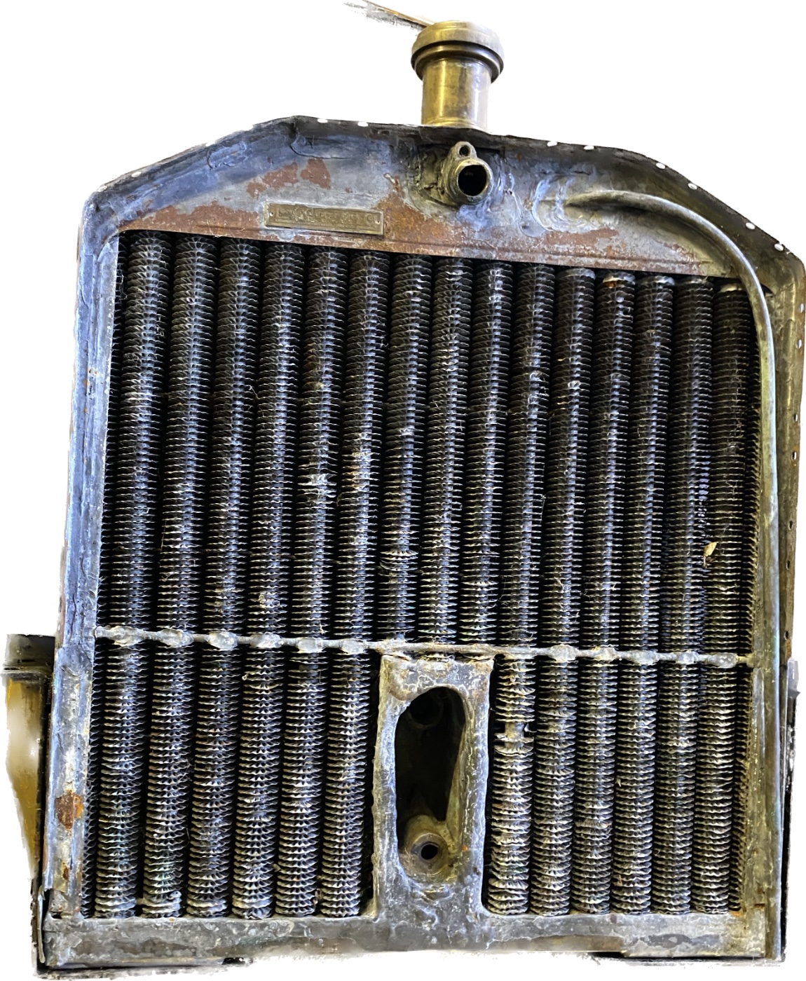

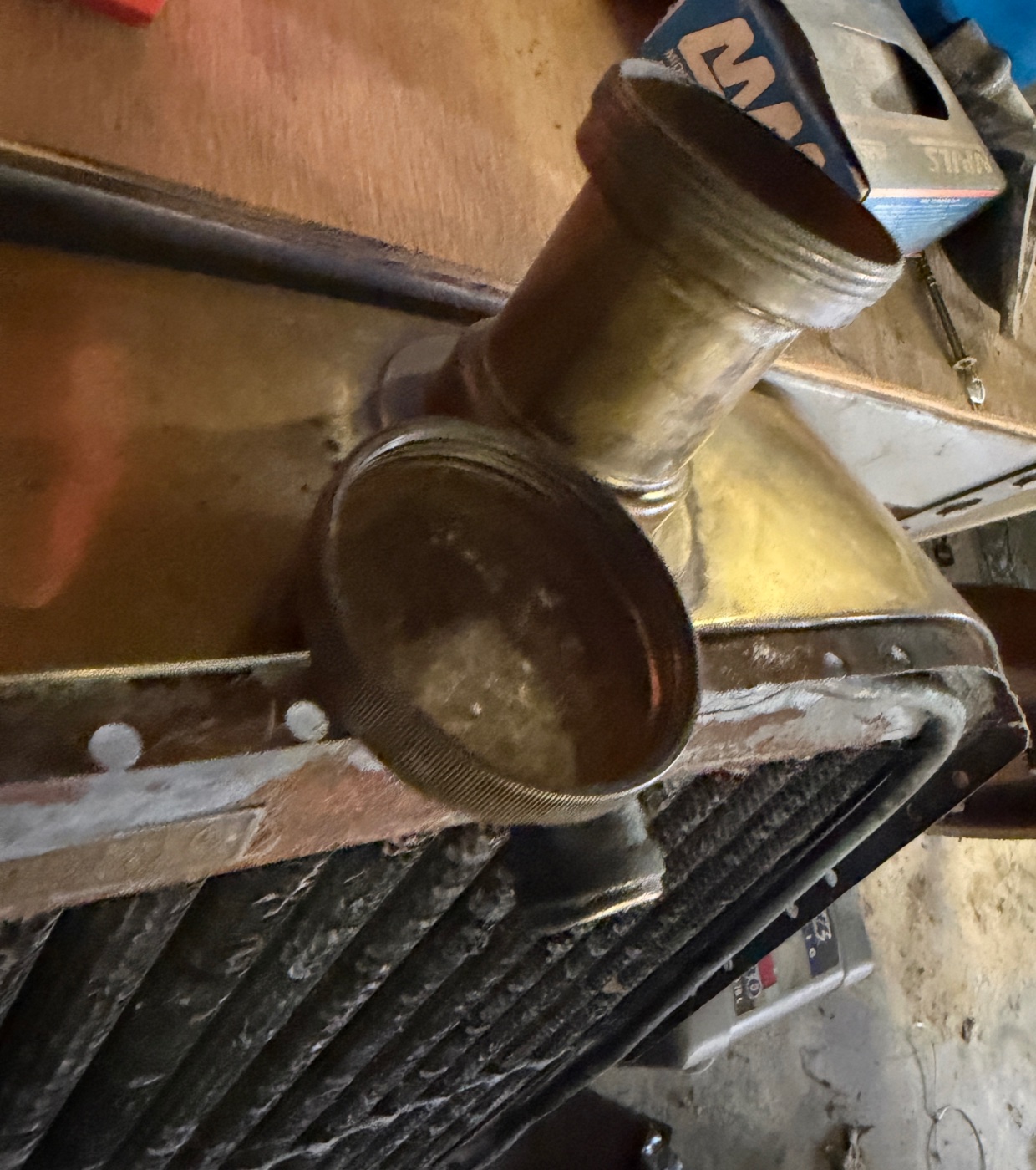

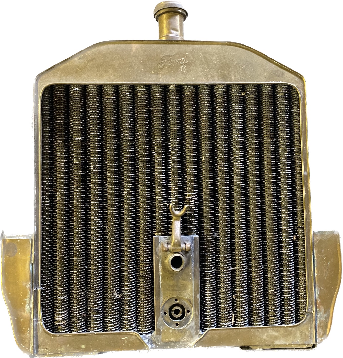

Here is another, seldom seen 1906 style rad, produced by Long-Turney (NY). The large neck “light bulb) neck with older style circular fins. My early 1906 (#3) N has a later 07-08 style radiator, but the hood still shows where it was re-formed to attempt to fit the different angles of the later rad. I have another early radiator in my shop that I’ll try to put pics up later.
Long-Turney:
Long-Turney:

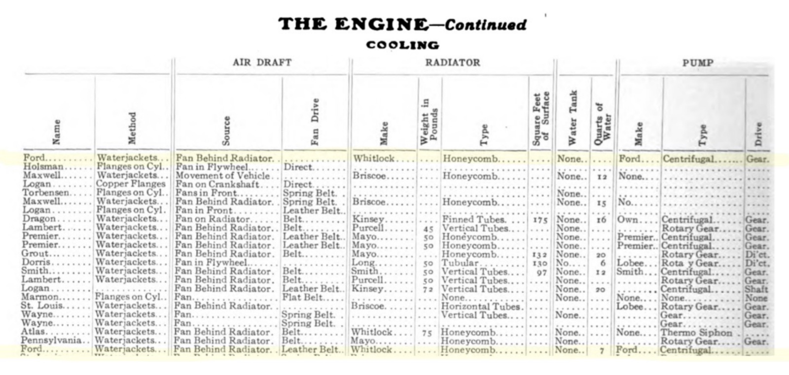

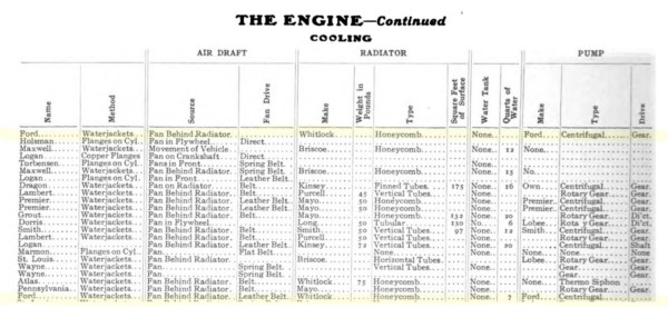

A little more-
This specifications page is an excerpt from “The Automobile,” December, 1906 report. The link below includes several specs on both K and N from that article.
The radiator for both models (1907 models) is listed as “Whitlock honeycomb”. My guess is FMC needed several vendors to supply the record number of radiators needed for the upcoming (1907) year, when FMC became the accepted largest automobile maker in the world.
