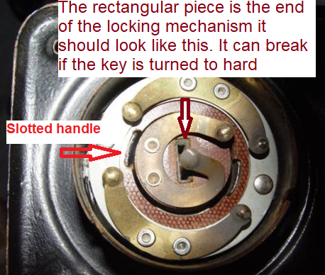

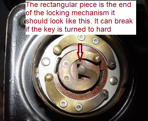

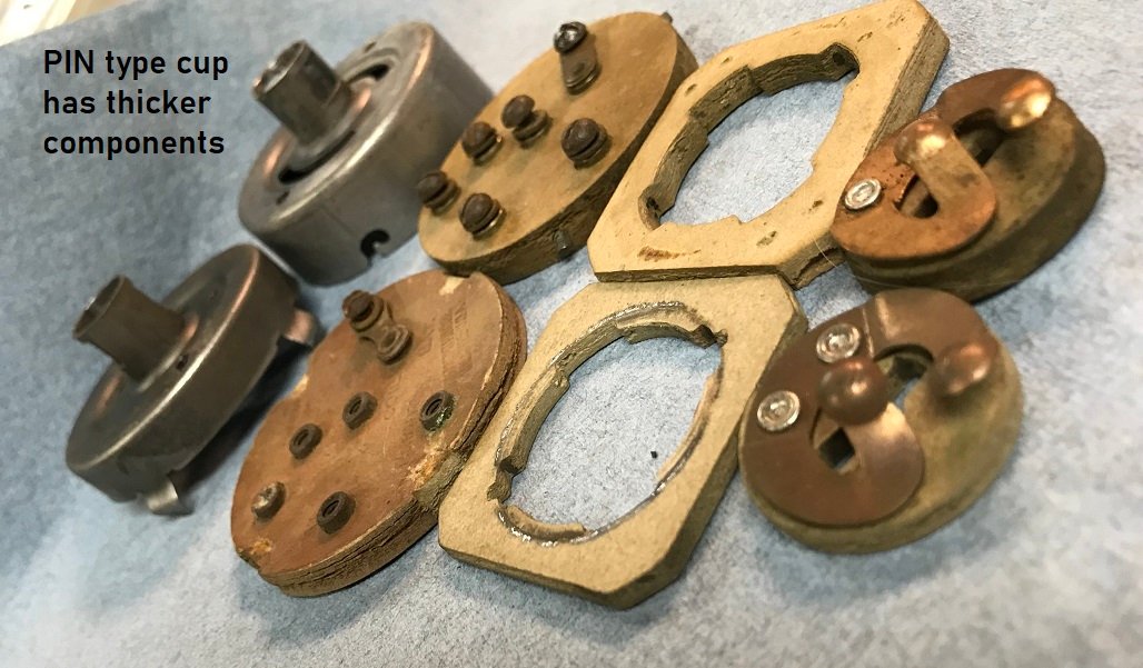

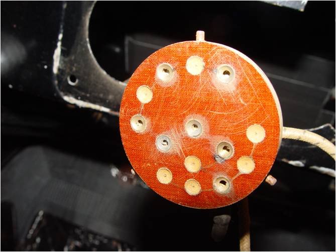

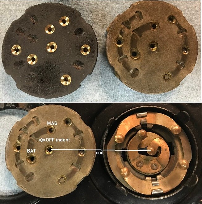

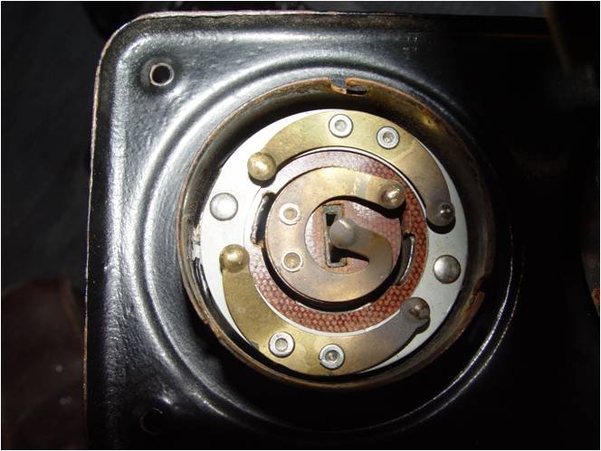

Mark as shown in his attachments a pin type backing plate and the internal parts. The inner ring is turned by the key to select the voltage choice for starting and driving while the outer ring is used to power the lights. So if you have an issue is with the inner ring and wiring to it. First how does the key feel when switching from Mag to Bat (does it seem to need a bit more effort to index it onto the brass contact?) Next you need to confirm that there are no loose or frayed wires. If all Okay then you need to do a continuity test on the inner screws when switching from MAG to BAT
The backing plate usually has wear marks/tracks or initial groves from the contact movement.
The original backing plates were compressed paper & subject to warping --
Reproductions have been made with different materials. This is a picture of the latest --
Note that the switch parts are different thicknesses for Pin & Clip types --

With the screws removed from the back and the switch contacts polished, you can look in th screw hole to determine if the contact is centered on the terminal.
You do have to be sure the screws that hold the wires in place are not long enough to go through the contact area on the switch side.

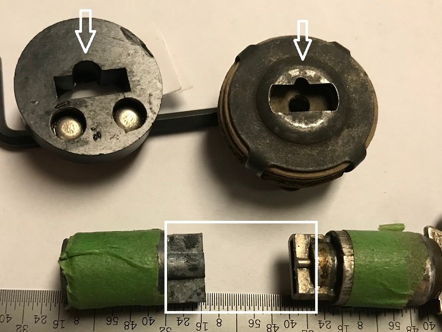

Finding a good key cylinder is the hard part.
All the repros are .015 to .020 too large and cannot be turned down to the proper size.

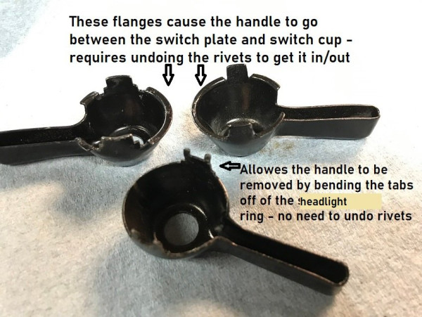

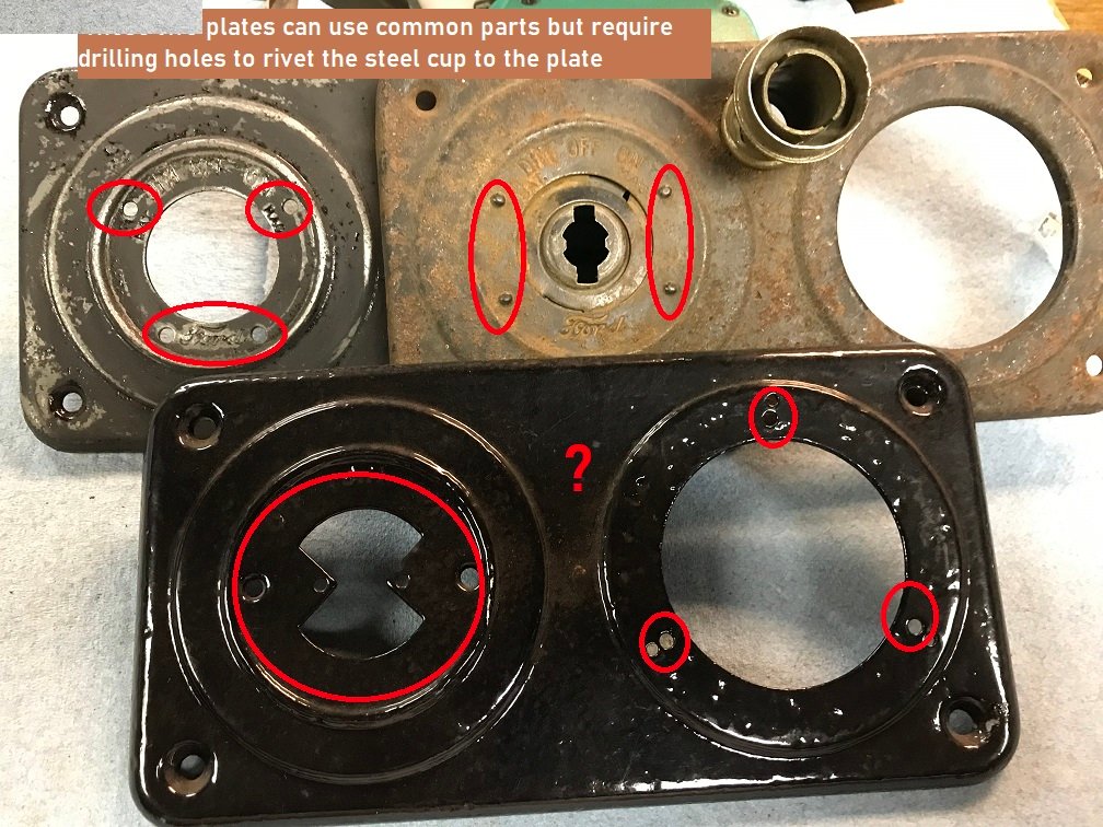

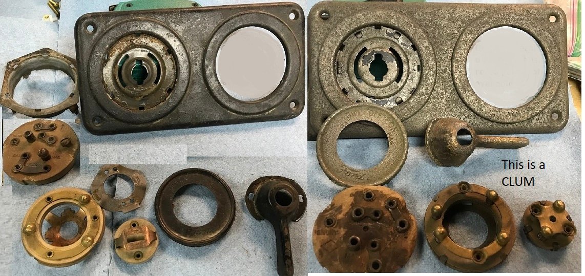

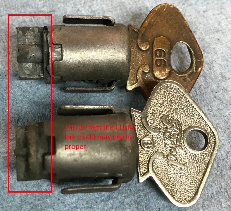

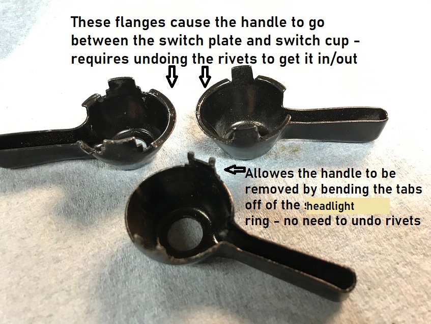

As Scott pointed out the repro key cylinders have issues, but not only in diameter but with the end that is to be inserted into the small inner disk. The end's hump isn't symmetrical and overall requires fitting into the small inner disk. Now replacing the cylinder has its challenges and depends on how the key handle is fitted. The easy one is those handles that have tabs that are bent over the small inner disk ves the slotted type that have a flange the fits behind the switch plate face. These require removing the rivets holding the steel cup.

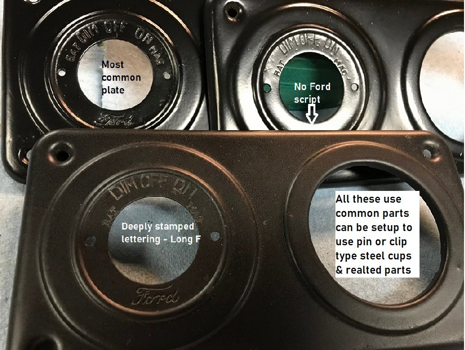

There were also different manufacturers of the rectangular ignition switch (Briggs & Stratton & Clum, etc) . Some Clum have their own style key cylinder. Original common style on the left, Clum on the right --
Since you haven't provided pictures of your switch, front or back, its difficult to determine what you may need. Some "repro's" were just refurbished originals

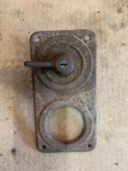

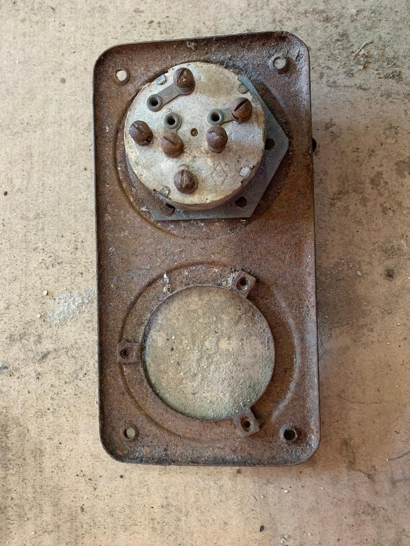

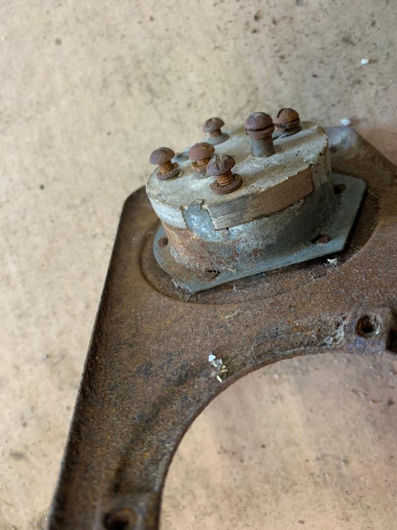

I finally received that box of parts. Here are some pictures of that switch.
- Posts: 6553
Re: WTB ignition switch '25
Scott , that appears to be one of the less popular designs. Thy come apart quite easily. I need to check to see if the backing plate is standard, but the internal parts are not. Having said that,its likely that they don't need to be replaced. See if you can tell who made the backing plate. If its the CLUM (one on the right) they have a very nice internal design but all unique parts. I believe that the backing plate is unique (notice the thickess0 and don't match the repro backing plate contact positions. The tumbler is also different (bottom one). BUT its a really nice design & less likely to fail. It may just need to be taken apart, cleaned up and painted. It may require a CLUM branded key as well
Scott C.
- Posts: 856
- Last Name: Clements
- Location: Waynetown Indiana
It probably is a Clum, it has that same triangle marking on the back. The tumbler looks good, I can get a key in it but, it does not turn. I sprayed some PB Blaster in it for now. The headlight switch does turn.
Scott C.
- Posts: 856
I got the tumbler turning with a 57 key. It locks the key in when turned to battery and mag. I got all the screws out and tested it with an ohm meter and all the contacts are making. It should be a good restorable switch.
