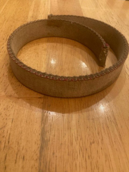

Hi Bob,
I picked up one cotton band during the great Kevlar famine ( my prepper instinct kicked in ) now that Kevlar is readily available & I stocked up
on Scandinavia linings & I don't think I will live long enough to use up my stock. This one is 22 1/2' long & the stain looks to be rust but there is no sign of deterioration. I have no idea what I paid for this one but it can be had for a reasonable offer & shipping. Craig.

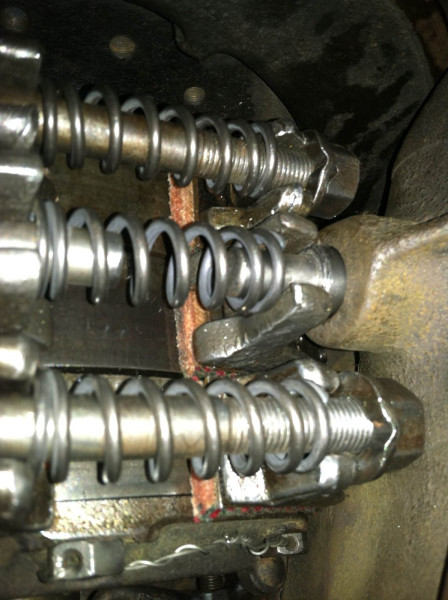

Re: WTB: One narrow cotton band liner
With the red and green edging, that one looks to be an original Montgomery Wards band liner. Had a set of them on my Speedster and liked how they felt. Same story though; the brake band wore much faster that the low or reverse. You can see the colored edging in the attached photo I took right after I installed them.
