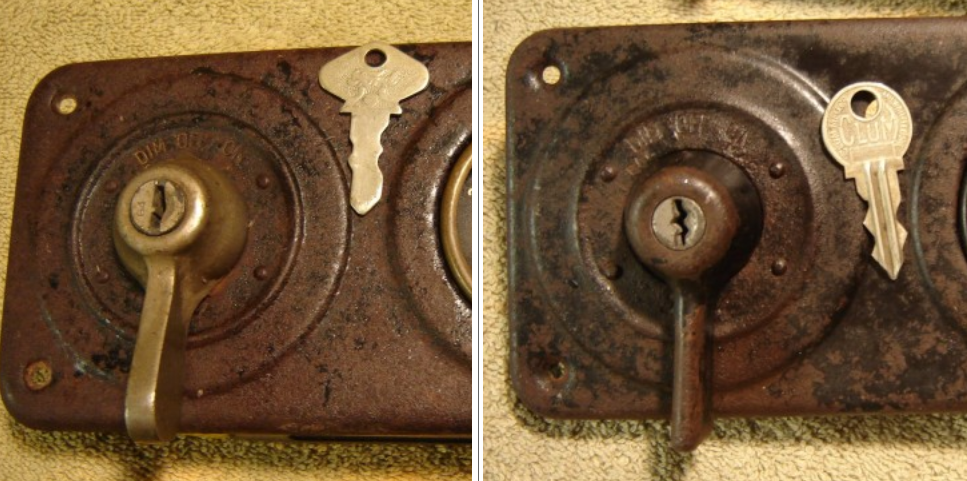

While Briggs & Stratton was the predominate manufacturer of the switches, CLUM was also making them. The internal parts of early switches were entirely different than the later ones. In fact I have at leas 11 variations. I'm thinking that you have a CLUM switch because of the number. In any case
it would help to see the switch face, keyway & handle, as in the picture below. You can see that the CLUM keyway is a different design. I have a number of Dodge Brothers keys, similar in shape as Ford, but their numbers range from 101-125

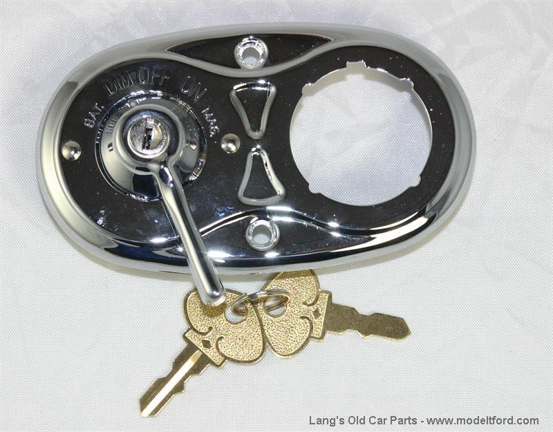

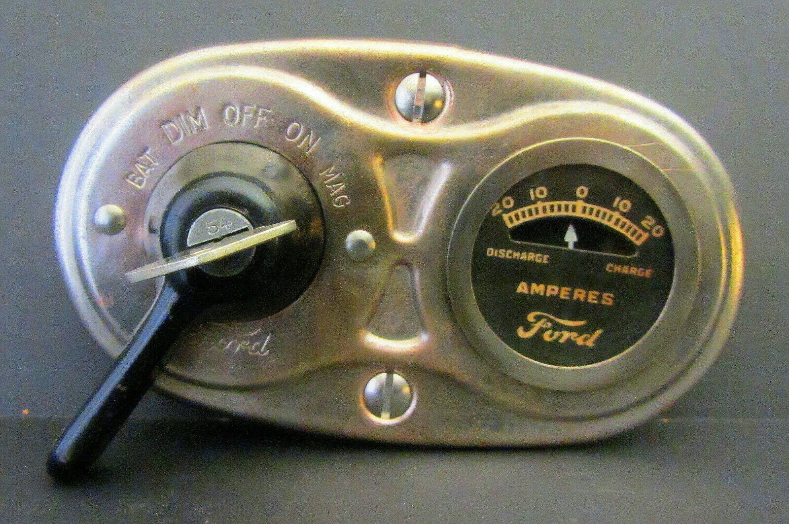

So for you '27 pickup wouldn't you want a switch for that year. Oval shape. Note the repro switches (chrome handle) do not have a good record.
The ammeter you have has value if it works.
This is a picture of a restored original
Repro switch with repro cylinder and keys (chrome plated instead of nickle)

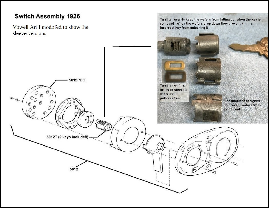

The repro cylinders don't fit very well (note they say for use without the sleeve that fits over the cylinder). That's what the wafers fall into to cause a lock. The diagram is a generalization of the assembly as there are two different backing plates (clip & pin types) and the method that the sleeve & handle attach to large & small contact disks
