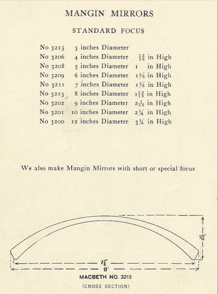

Many of the original lamps used a Mangin mirror where the glass is a meniscus lens plus a mirror. They are very specific to the lamp re: diameter and distance to flame. I don’t think anyone makes them currently. I used the Snyders reflector in my ‘15 speedster and it performs sufficiently in that lamp

I believe that all Model T gas lamps used 6" reflectors, just different focal length ( different glass curvature).
There are 5 1/2" reflectors but they did not come on Ts.
